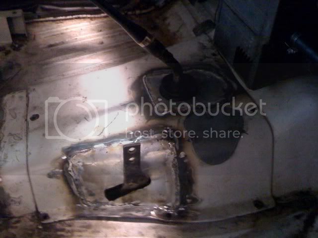

Meanwhile, the grill and headlight thingies (technical term) have been de-rustified and painted silvery grey, the oil pan has been welded up, painted, and re-attached (also had to shorten the sump tube a hair) and I fixed up the cover over the shifters.
