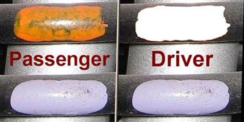

The OEM front springs are color coded: no part number needed.
If after market - I have heard second and third hand (aka rumor mill) most lift kits ignore the fact the FJ leans and they provide identical left/right springs.
