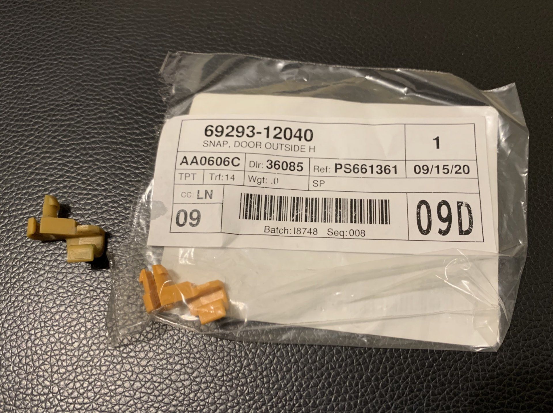

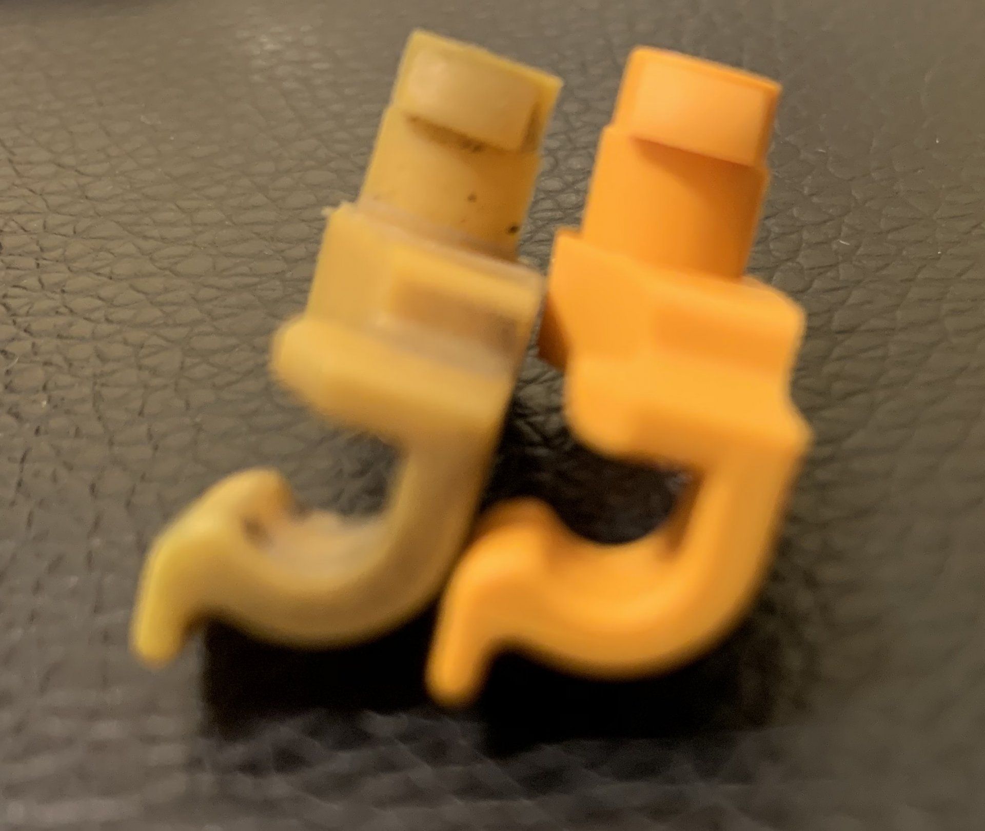

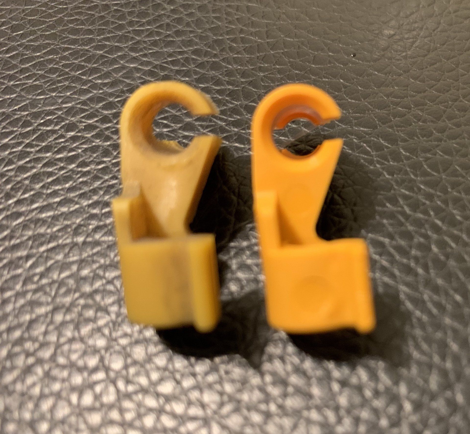

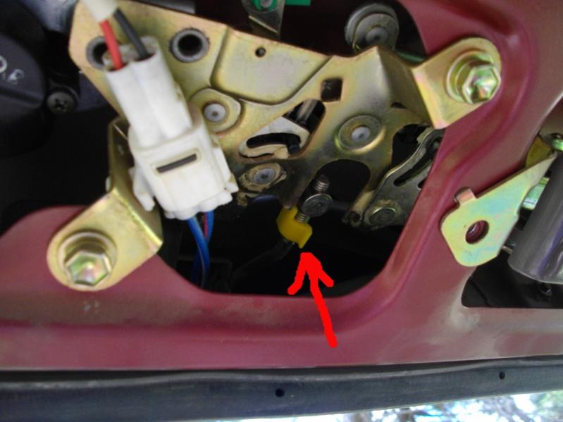

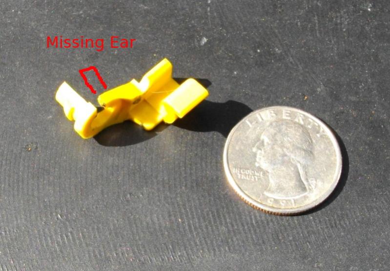

Hi folks,
My outer handle broke a few months ago, and I finally got around to fixing it. What broke is a plastic snap fitting that attaches the linkage from the outer handle to the latch mechanism. The FSM isn't much help - it doesn't have enough detail of this mechanism. The display at the dealer isn't much better. But when I took it apart and carried the part in, one of the women behind the counter knew exactly what it was and where to find it! She said they sell alot of them. Was about $2.50 and the part number is 69293-12040 - "SNAP, DOOR OUTS"
edit - cruiserdan reccomends 69293-89102 https://forum.ih8mud.com/showpost.php?p=8593415&postcount=14
Here are some pics:

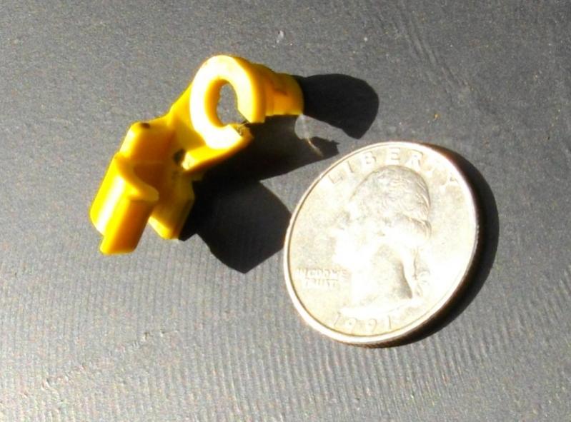

I had the same problem, my local dealer wanted to sell me the WHOLE mechanism. I did a little "zip tie" fix.

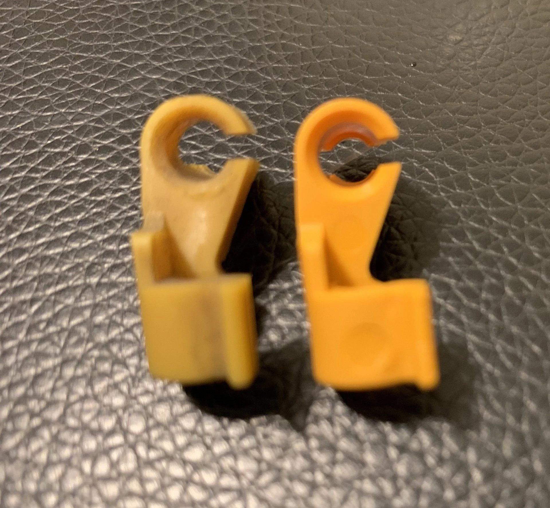

FYI, 2019 update: Local toyota dealer says CruiserDan's preferred part is discontinued. They have 69293-12040 - "SNAP, DOOR OUTS in stock for $3.
Thank you, Tokyem! I can confirm that this part is a perfect replacement for the driver’s side door handle rod on my ‘96 LX450.
My local dealership had the part but no record of any snap for the linkage. They started talking about buying the whole assembly and I was relieved to pull up the pet number based on this thread.

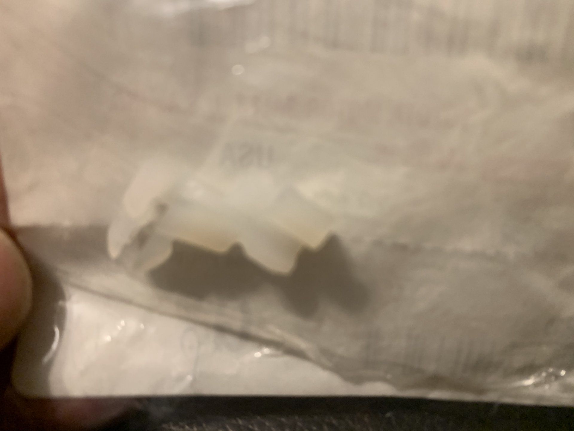

For good measure, I also picked up the passenger side linkage, part number 69293-12030. This one is clear, but is the same size.
Hi folks,
edit - cruiserdan reccomends 69293-89102 tail gate locked - open lever does not engage - https://forum.ih8mud.com/showpost.php?p=8593415&postcount=14
Here are some pics:
