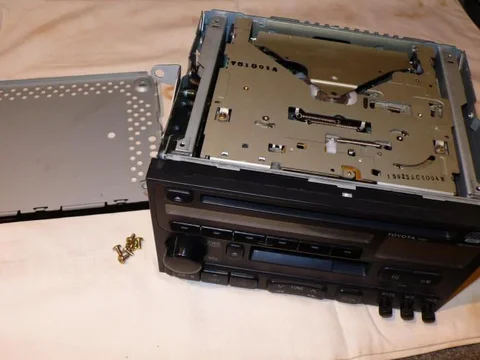

Pulled the head-unit, removed the top cover (6 screws):

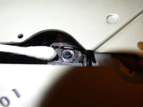

Located the laser pickup:

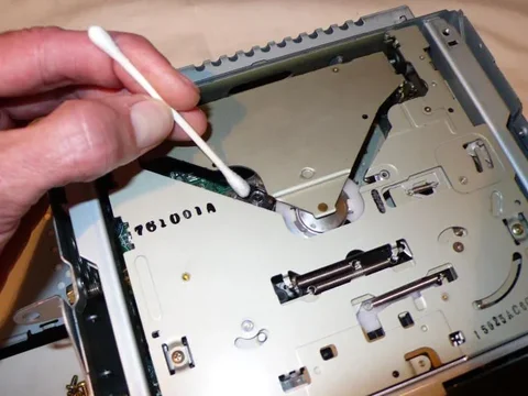

Cleaned the lens using pure (anhydrous alchohol):

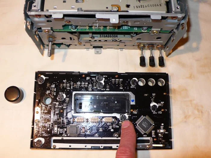

Next, pulled off the volume knob and the front panel, located the bad bulb (it's the one above the tape door) and swapped it with the bulb for the CD eject button:

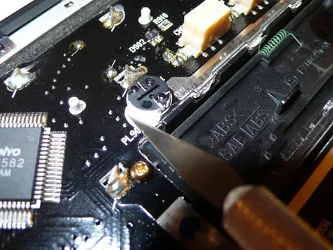

Cut the paint around the base a little with an X-acto:

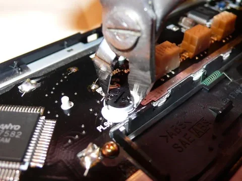

Needed to twist it free with a small wire cutter:

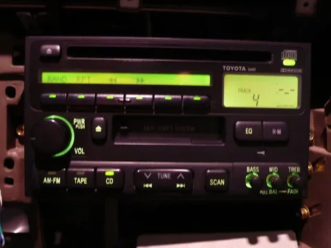

Yay, I can see the display again!

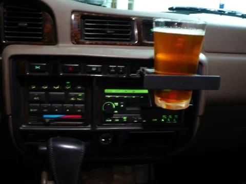

D'oh!
