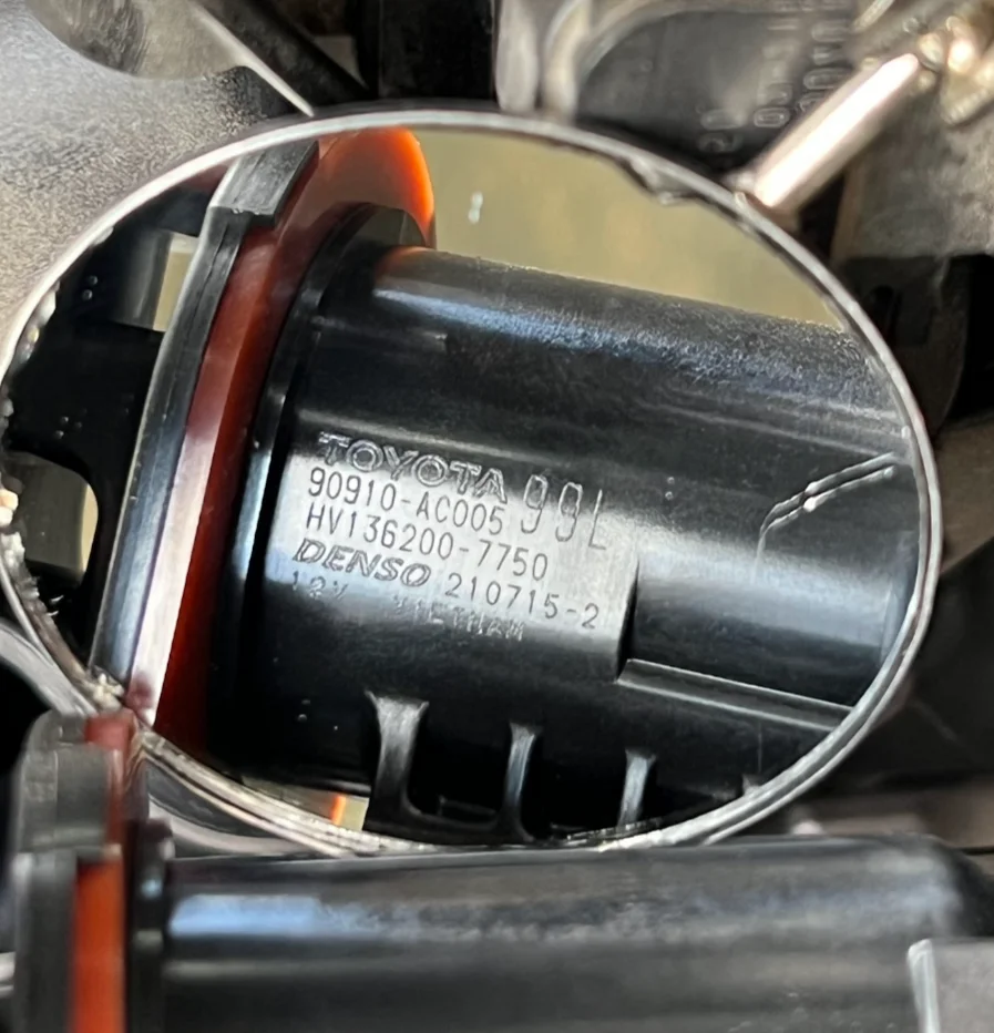

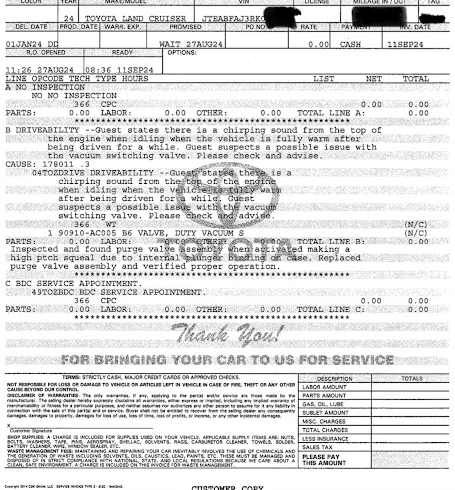

Update: dealer said it was the Duty Vacuum Switching Valve, 90910-12284, I suspected. They installed the new part, 90910-AC005, and the chirping appears to be gone. If anyone else encounters, I think a quick test is to disconnect the plug going into it and see if the noise stops.
Glad it ended up being a minor part replacement. Will update the thread if anything changes.
New part below
