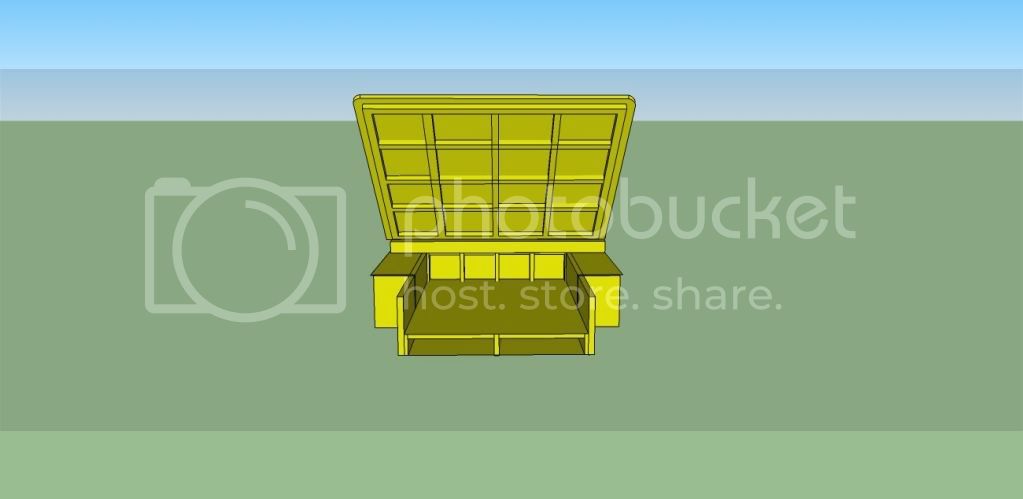

So, I've been itching to design my own utility bed for my truck since the day she rolled home, and thanks to the magic of Sketchup, I can make these ideas come to life, and ask for feedback on them.
The idea is based on a simple flatbed in-line with the current floor of my bed, with a U-shaped series of shelved boxes on it. The flatbed would be solid steel, but the boxes would be framed out in steel, and "skinned" with fiber-reinforced plastic.
Instead of individual doors for smaller individual compartments, there would be two primary boxes with swingout doors on the sides, and modular shelving, so each compartment can be rearranged as-needed.
A headache bar overhead by the back of the cab would double as an auxiliary light/signal bar, and as roll protection. It would be thick steel rectangular tubing, and fully anchored into the frame of the flatbed.
Finally, a stoutly-framed tonneau cover will cap the unit. The reason for the overkill build would be so a rack, or even a small RTT can be parked on it as-needed.

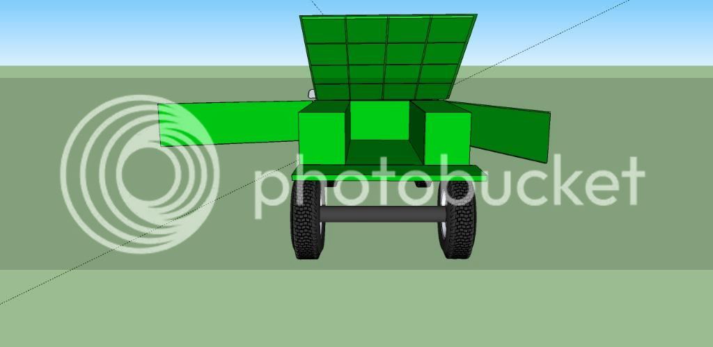

so, here was my first rough idea:
Ultimately, it was too complex, and potentially heavy to make it work.

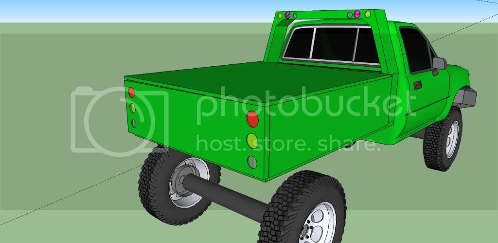

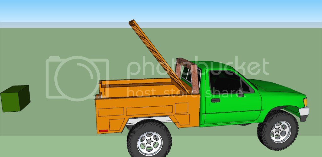

I spent some time revising it, and also getting to be more familiar with Sketchup, and here is my next draft:
I went for a sleeker, simpler design without boxed fenders, and with less hinges and latches to add weight and complications

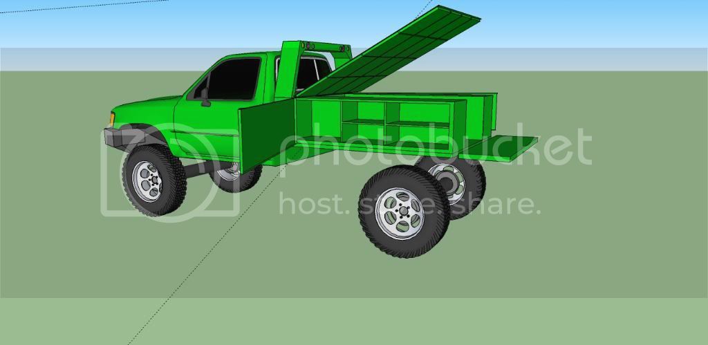

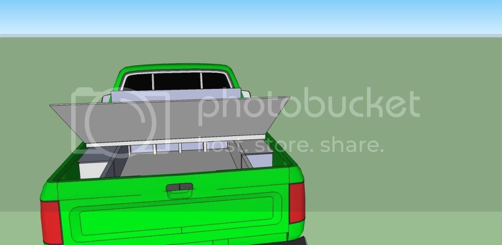

Here's another shot:

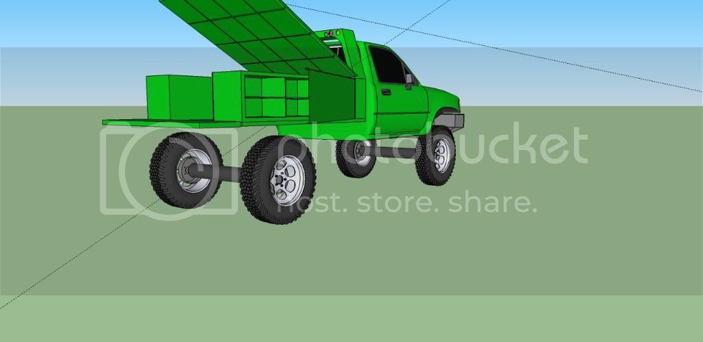

Here it is opened up:
I've opted to have the tonneau begin just after the headache bar, to prevent issues with the bar and cover interacting with each other, and causing issues. That also left room between the legs of the bar for a small compartment for storage of emergency staples, like tools, spares, rope, MRE's etc.
I opted to make the side-doors swing out in the drawing, but I'm reconsidering. The space requirement of swinging doors would be detrimental in tight spaces.

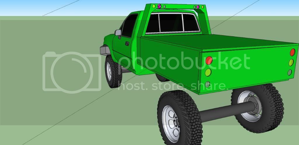

A final teaser.
I hope to revise these drawings to show more of my ideas, and to develop a "skeletal" version that shows the framing that would be done.

You might want to modify the back, the departure angle looks like it wouldn't work on the trail very well.
I'd make the side doors either open up or fold down. The swing out idea might be a problem in a lot of situations. Perhaps the bottom half could fold down to form a table and the top half fold up to form a "roof".
A long compartment in the front that went across the entire bed would come in handy for stuff like axles, Hi-Lift, fishing poles, etc.
You might also plan for a fuel cell and water tank in the center section with a filler tubes on the outside.
Good point. I'm still reworking the ideas on that, but I'm much happier now than with the older orange one. I tried to eliminate overhang as much as possible, but I'll look at it further.
Definitely. I realized the barn-door idea was a bad one as I just finished posting it. I think a drop-down tailgate style would be ideal, because it creates a work surface.
The Table-roof idea's not bad either, maybe I could make one side swing up, and the other side removable/relocatable, and arrange for that.
I was thinking about making a subdivision inside the main hold, about 3" off the bed level, and epoxying in PVC pipes in there for axle "sheaths", or mounting the "sheaths" under the bed, along the frame. That way, I could store them in their own individual container packed with grease to protect from oxidation/rattle damage.
I was thinking about a bolt-on solution for a highlift on one door, and a bolt-on system on the other for a shovel and axe.
I was wondering about that, too. Maybe trying to squeeze a small, flatter, tank between the frame rails of the "saddle" just after the cab, or one of those bed-mounted aux. tanks I see in ag-type trucks around here.

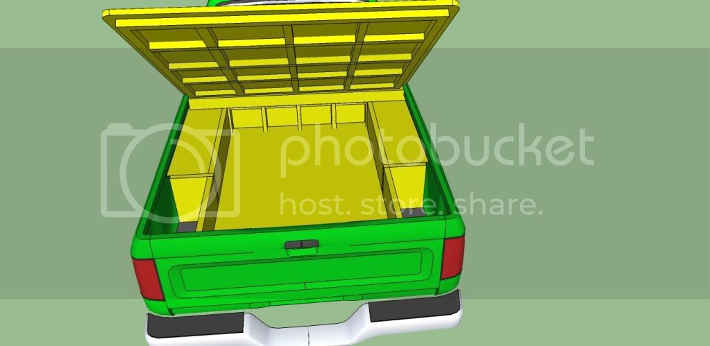

Here are the pictures:
This is it closed up. I've decided that it should be small enough to allow for a truck bed toolbox for my emergency gear, (eventual) compressor, and tools. Having the smaller separate box would make it easier for me to reach my equipment without having to pull open the main tonneau.
Popped open to show the tool boxes and layout. I wanted it to be kept simple:
And pulled out to show the drawers underneath:

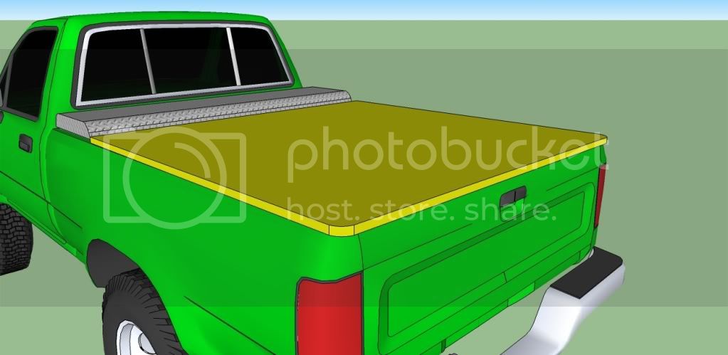

Here are my most recent drawings
I like the new approach. You might consider a bought tonneau cover, either hard or soft, it will be much lighter and probably look better than anything you can build out of ply and 2X4. The interior boxes could be built out of 1/2" ply alone.
I second Rusty's comment as well as I'll mention that wood on a vehicle is hard to get to stay waterproof. If you covered the wood with fiberglass resin, it would have a better chance of staying waterproof.
That is a great idea.
I'm sure our local marine supply shop will have fiberglassing resin a-plenty.
Back before the hard tonneau covers were around one of the guys I worked with had a sheet metal shop make a cover for his truck bed. I'm not sure how it would compare to a fiberglass one in weight or cost but it might be worth looking into.
It would also give you more options in design. Say a double sided lid with a hinge down the middle, or a 40/60 split front to rear.

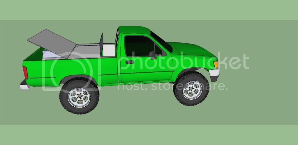

I think I've finally come up with a design I'm the most happy with.
Rusty's earlier comment:

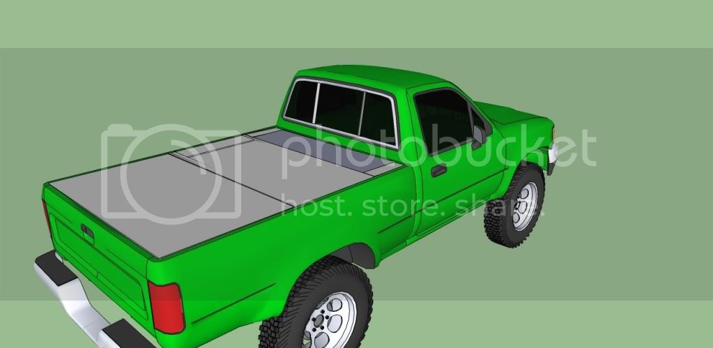

got me thinking about building the cover out of sheet metal again, and the spit design seemed to most practical.
Basically, with a six foot bed, I'd have one one-foot door, a two-foot fixed middle section, and a three-foot door. This would reduce the lifting weight of each tonneau section to the least possible, and make the opening radius of the hatches as minimal as possible to allow for easy access with the soft top up.
I've decided to run with the soft top idea as a back country tent substitute, but rely on the secure, weather-resistant storage of the armored tonneau for my gear.
Here are my most recent shots, and it's worth saying that the pickup model I've been using does not have a square bed, but the passenger side is slightly higher than the DS, hence some degree of "wonkiness".
Closed up:
Tailgate view:
Side view:
The smaller toolbox door will open away from the cab to facilitate being able to kick open my rear sliding windows for ease-of-reach.
