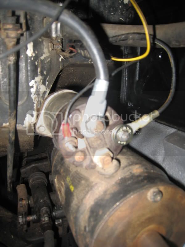

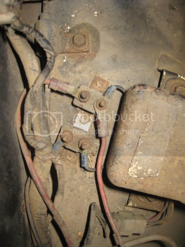

The event leading up to; I traced the fried alternator wire out of the stock wiring loom (From the PO), I replaced the wire with a 12guage wire and used a parallel junction connection for the inline wires (two wires;one B/R to ignition and one W to the rear conjunction terminal for the rear window), I crimped the wires at the parallel junction and at the positive post terminal of the battery. I turned the key and got nothing so I played with the starter wiring for a bit and wired the BY wire to the post closest the motor and a BLK wire to the post closest the fender on the starter. The tried the key again, now I've got a red light on the right side the instrument panel on the first click and the start engages on the second click. Now I checked for power with the key on first click (ACC) got no power to the fuse box. I took that out and applied sand paper to fuse box for a bit then slapped it back in and what do you know POWER. The lights, wiper, lighter, signal, and horn worked minus the hazards and rear window. I was happy and called it a night but decided to take a picture to document the day work. I when to pull the light switch (keep in mind I didn't have the key in "OFF") the lights blinked once and all I saw was smoke coming out of the engine compartment.

Starter shot
Parallel connection.

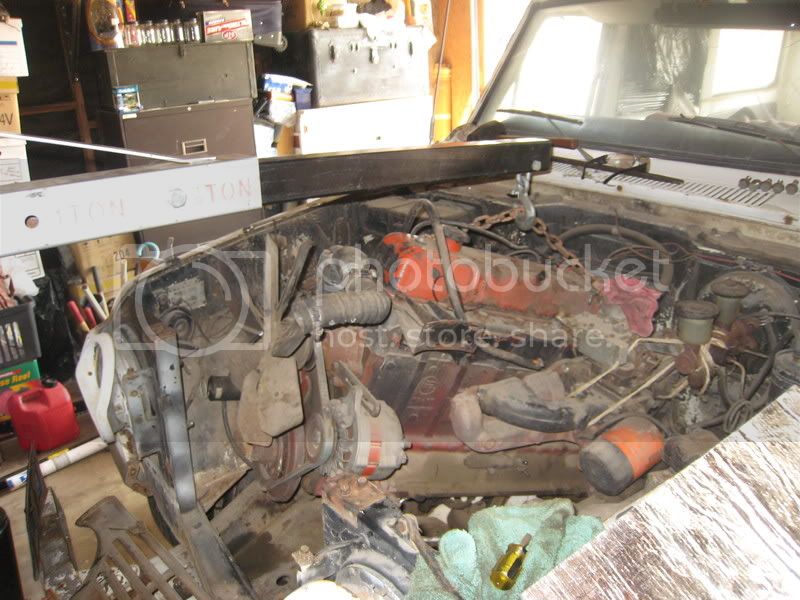

Since I mentioned the motor project I figured I would add a couple of photo's for insight.
The Old:
The Now:

#1 issue= 10 or 12 gauge black with white stripe wire is the starter soleniod trigger wire, IE, makes the starter turn over.
Black with yellow is ignition hot, IE coil wire.
So, black with white shouldnt be connected directly to battery, or to anything but the downstream side of the ignition switch. you can trace back to ignition switch plug on left side of instrument cluster. Coil and other misc stuff should be on the black with yellow circuit.
the black with red 10ga wire is what attaches to the white wire that goes between the alternator and the battery. that feeds power to the igniton switch, etc.
also, junk the chevy starter you have in there, and get a toyota one.
I have the wiring harness out of my 12/'71 FJ55 in the garage, so I can point you in the right direction pretty easily.
one more thing, I am guessing that the ground cable isnt connected to from battery to chassis to engine. one of those connections is probably not connected, since that is about the only time I have seen the white with black wire from voltage regulator to alternator melt. This happens when the ground is bad between starter and battery when you try to crank. whether or not you heard it, since the black with white 10ga is connected directly to battery the starter wanted to crank, with a bad ground between the battery and the starter, typically this wire melts as the starter tries to crank, but without proper gauge wire it just melts this wire...

Wasabi came over to help me out real quick and this is the conclusion.
The BW (correction) wire to the starter is good accord to the ignition (start position).
The little (16-18gauge) one that shares the same loom with the BY 10 guage is BW or BY and has constant power (red flag is most likely the culprit of my fried problem). On the first picture that is a YB wire coming from a connection where the YB crosses with a RY which is hooked up to the coil (unsure??). I've got no fried wirings today and I don't have clue what do with.
Thanks for informing me about the starter I'll have to swap that out in the near future but since I'm strapped for cash I've got to use what I've got.
BTW, The second photo with the BW wire got fried was my replacement for the WHT one and now I've got a WHT one to permanently replace the two fried wires, I figured that was one of my problems in the first place (wrong color code).

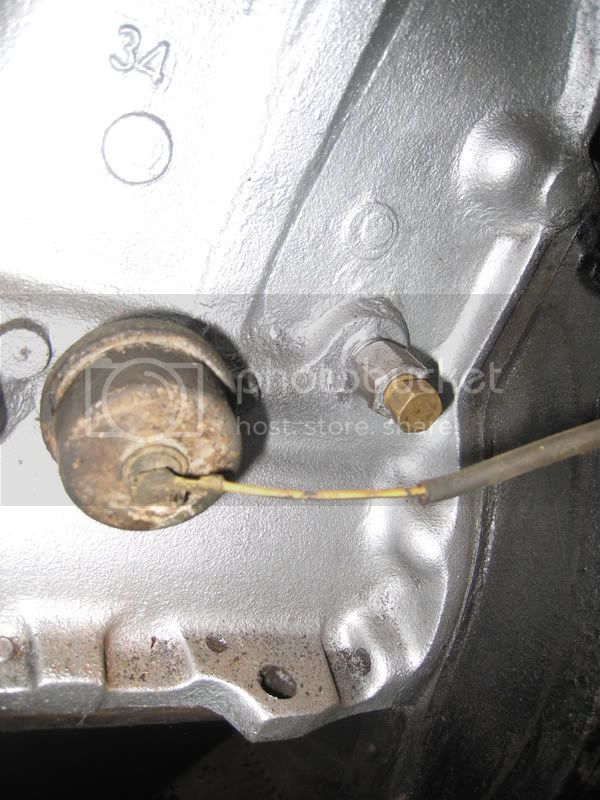

the yellow with black small gauge wire is actually the oil pressure sender wire. trace it back to the instrument cluster. the red with yellow wire that it connects to the connector behind the starter battery cable is actually for the t-case 4wd indicator switch that your truck shouldn't have, but its still in the wiring harness. Mine is has the same wiring with no indicator switch(only on earlier vacuum shifted t-case models.) you can trace one side back to 12v ignition hot, and the other will come out of the harness near the hazard switch connector.

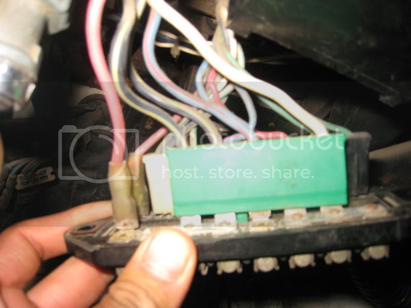

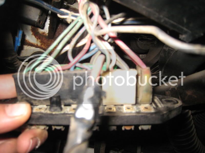

Something seems wrong, I would make sure the plugs on the fuse block are installed correctly, and that the ignition switch connectors are in the right spots. the haynes manual has a pretty good diagram, and short of the emission wiring and turn signal relay, its pretty accurate. I think I found that the 1972/1973 FJ55 diagram was closest.
the black with yellow wires in a factory configuration are ignition hot, not start hot
Okay so I reference the wrong color code according to the first picture the BW wire to the starter is the correct one. The only mystery that I need to figure out is the little BY wire that I think (so do you) should go to the coil but according to my wire diagram on hand it say the coil wire is RY. I'm got to do some school work today so if I get time I'll hit the garage for a bit.
I've got a oil pressure wire hooked up already and I'll post a picture of that tonight and I'll try to trace the BY wire as well. I'll just disconnect that YB wire from the 4wd indicator to the coil and tuck that away with a label. Everything seems to be stock minus the additional trail lights but I'll post some pictures of that as well.

fuse box
Oil Pressure YB wire
