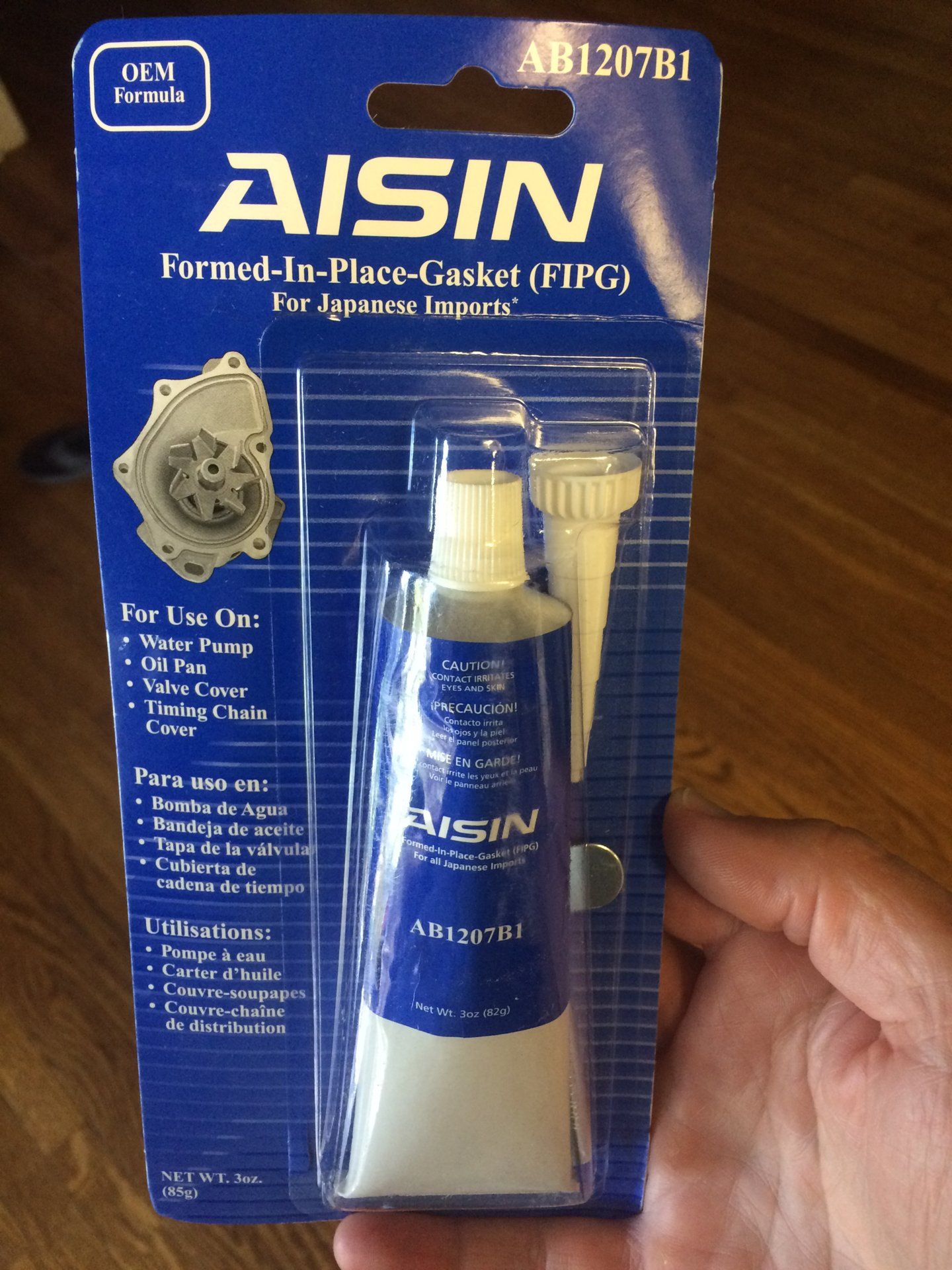

Ok so that solves my personal mystery of what FIPG means; I've seen it all over but never knew what it stood for!In the latest AISIN timing belt kit that I purchased, there was a card that suggests to use "AISIN AB1207B1 or equivalent" for the thermostat housing. In older kits I did not find this card. This looks to be a sensible alternative to the 1282B.
Check out The Right Stuff. It's anaerobic and the parts can be put back into service immediately. About $10 a can.
