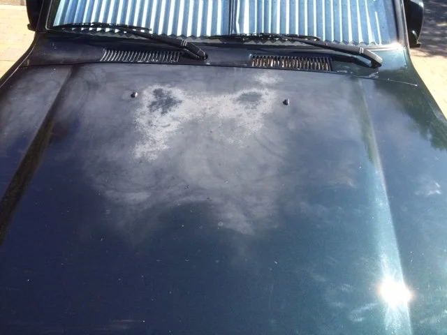

I'm a relative newbie when it comes to finish restoration. But I've got a paint problem on my 1997 FZJ80 I'd like to fix. Here's what I'm talking about:
I tried to do something about the hood this past weekend. I used a clay bar over the whole hood and it did a great job of removing contaminants from the surface, making for a pretty silky smooth surface. Then I applied a synthetic wax. The parts of the hood where the finish is in good shape came out great, but the gray pock marks look about the same as before.
What exactly is the problem here and, more importantly, can I do anything about it short of repainting? I have a random orbit polisher (Porter Cable 7424XP) and a variety of pads, but not sure how to proceed. Are these places where I should use one of the Meguiar cleaning compounds, like M105 or M205? Any advice would be appreciated.
Thanks!
What you are seeing is the clear coat delaminating or separating from the base, coloured coat of paint. I would suspect that the only proper cure is repaiinting, which is what my HDJ80 has had done, but, being a detailer and keeping such things, I would give a rotary polisher a shot (or an orbital if you've already got one - this is probably not worth buying a new machine for) with a decent compound ( I like Simoniz stuff, but to each their own) and see what happens. Be warned, this may not improve the appearance, and could quite possibly make it look worse. Perhaps don't practice on the bonnet, maybe a less conspicuous area.
I was afraid it was the clear coat going bad. Seems to happen a lot on 80-series.
Yeah, seems to be common. Mine has had the roof and bonnet resprayed at some time in its life, which according to the PO, was for this reason.
Well after staring at my computer screen for 12+ hours I can say I found a lot of good info on the internet about clear coat issues -- you can literally spend days reading or watching videos on the subject. But I think @AussieHJCruza is spot on the money. There's really not much that can be done short of re-painting. The FZJ80 is finished with a two coat paint system, base coat and clear coat, and for whatever reason the clear coat has failed and the underlying "dull" base coat, even thought though it's "metallic", is all that remains. From what I read the proper way to repair this is to sand the complete panel's surface (e.g., the whole hood/bonnet), feather-edging the failing clear coat if possible, and then apply new coats of clear coat. Then as long as the underlying base coat has not also been damaged the shine of the finish will be restored. But doing this requires a paint booth (or at least an enclosed garage) and spray painting equipment. So the project is quickly growing out of my hobbyist hands. :(
If someone thinks I've got this all wrong please do speak up!

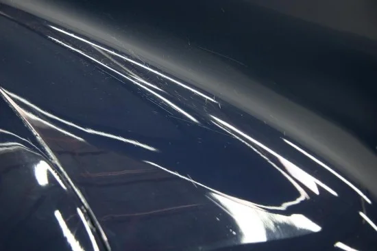

I wouldn't listen to any of the info given in this thread! The clear coat has failed. You must sand it smooth, prime, repaint, and reclear. In the spots next to the squirters and the spot on the quarter panel the clear is gone and the base is open. Usually when this happens the base starts to create a problem called checking. It creates very small cracks that if painted over will just show like a sore thumb. The only way to solve that issue is to sand it smooth, primer and repaint.
Here is what checking looks like after a repaint.
Painting on top of anything finer than 800grit will result in a delamination problem. That's where the newly applied paint will flake or peel off. It's usually ok until it gets hit with a pressure washer or a rock chip happens. Then all that time and money are out the window.
