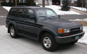

Hello everyone,
First off, thank you to everyone out there that helped answer my questions and to all that eliminate some bad choices for trucks (I'm refering to trucks that have been totaled twice and are being sold without that mentioned!!!). I know I'm beating a dead horse here, but MUD definately helped me make the right decision in waiting for the right truck.
Now for the truck itself....
It is a '94 LC with 179xxx miles. Its is fully locked, and has the leather interior. It has a new starter, newer tires, new shocks. It has keyless entry that the PO had installed when he bought it 3 years and 30,000 miles ago. I do have a few questions about my truck.

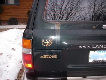

2) I have some rust on the liftgate on the back, and am curious what to do about that, or if I should just let that go. Hard to describe, but see the picture.

2) I have some rust on the liftgate...
You need to have this repaired as it will only get worse and spread.

Before you ditch the head unit, and I would rather than repair, spend some cash to base line everything. Others have had the rust issue in the same place on the tailgate. Maybe someone can chime in who fixed theirs.

Take the truck to the body shop as soon as you can afford it. If that rust is visable from the outside it's HELLA more extensive than you can see.
A while back I had rust on my rear hatch repaired as well, it was NOT visable form the outside of the truck, but was so extensive new metal had to be welded in for the window to seal properly. Cost about $575 IIRC.
You might be better off just sourcing a good used hatch from a cruiser wrecking yard. Might be cheaper in the long run. Cruiserparts.net or NIX99 in washington are the first two that come to mind.
the only reason I didn't buy a new hatch was because I couldn't find a good white hatch and the cost of the used hatch plus painting was more than the rust repair.

check the parts for sale forum here -- someone might have a hatch that you could swap out. Based on that pic, I'd fear that you've got much more rot under that window gasket.
