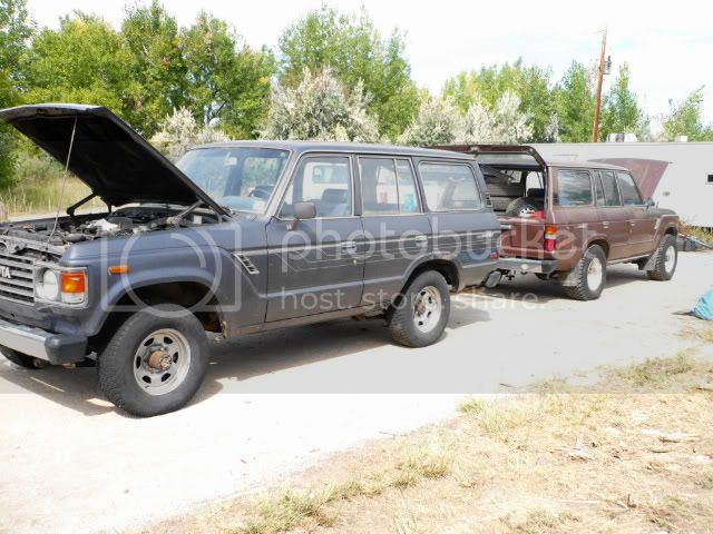

Finally got around to putting a rebuilt and upgraded head on my FJ60 2F

Hope I'm not hijacking your thread, but since I brought it back from the rec
ent dead....
I was wondering if you could tell me how much the Valve Job kit cost from Dan and what parts/gaskets were in it. I called Dan, but he doesn't seem to be around, so I called Boulder Toyota (in CO) and they said $295 for the kit or $168 for the Head Gasket. They don't seem to know much about Iron Pigs though...
I have an 85 FJ60 that the PO blew a Head Gasket on in 2001, he knew the coolant hoses were bad but ignored it, his mechanic told him they were rotten. Anyway I bought this 60 for parts, but I need a second vehicle now so I thought I'd resurrect it.
The leak down test that PO got in 2001 was: Compression #2 120, leak down 25%.
Also Boulder Toyota told me that they were using The Engine Shop in Longmont, CO. for head machining. Does anyone know of a great shop in the Denver metro area?
Thank You in advance!
ent dead....
