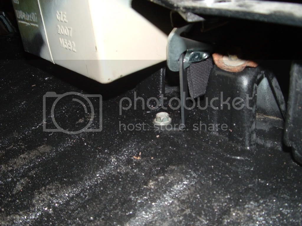

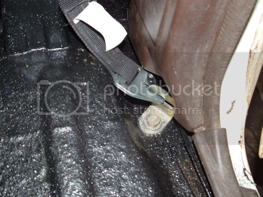

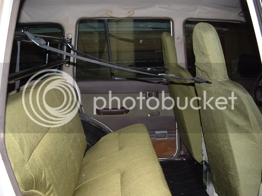

Thanks to Nemisis Gnat and Krameric for their expertise. They are both correct in pointing out that this is not the correct way to mount a harness. Mounting the shoulder harness to the floor will apparently crush your spine in an accident. I did some reading up, and then made some changes.
First, the chain is gone. I gutteed the OE belts and used the brackets that bolt them to the floor to secure the lap belts. If they are good enough for Toyota, then that's good enough for me.
Then I exposed the bolt locations for the rear seat shoulder belt guide. I took some measurements and fabbed a harness bar. It locates the shoulder harnesses properly.
It also will keep large objects contained in the rear area.
Side note: I realize that it is no longer possible to have passengers in the rear seat. That is the price I pay for front seats with harnesses. Besides, my 75lb german shepherd does not share well anyway.
i dont mean to stir up s*** here and im no expert on the subject... but from my experience with baja bugs, that is not a safe way to mount the seat belts, and could cause serious back injuries
i think its supposed to be just below straight back from where the seat belt go through or over the seat back
maybe someone smarter will chime in
I had heard that Master crafts frame is at the correct level to mount belt to the floor on rigs not useing full cages
I put a bar in my cage for em and the kiddos love it as a grab bar :steer:
I also had mine floor mounted before in 3 roll over (offroad mind you) at slow speed no problems
That would make sense to me given the harnesses were provided by MC as well. Oh well.
I like that bar. I was going to do something similar, but took an easier route.
Thanks for the input
