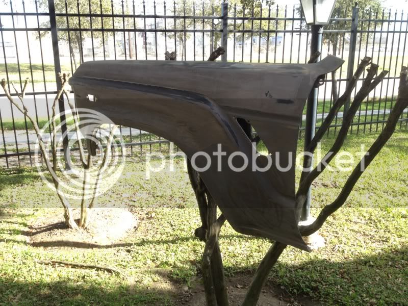

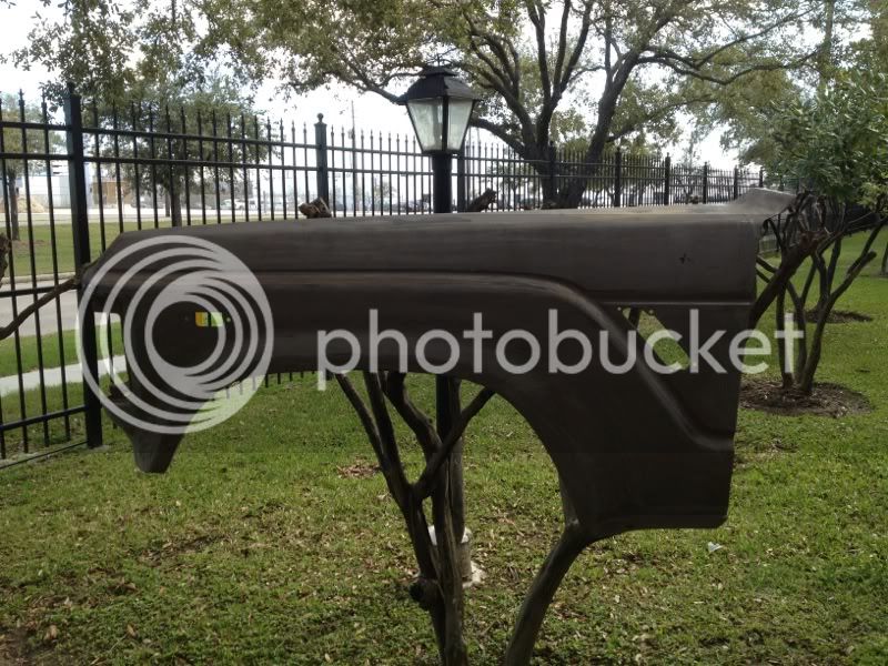

I found some paint that is very close in color to mine. I have a 1984 Light Blue Metallic (861) color code.
Found Krylon SparVar Metallic Blue and decided to give it a shot. I have held the fender up to the car but have not installed it yet. I think it will be close enough and much better than the brown whatever the "new" fender was.

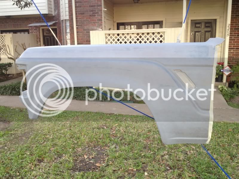

Here are some progress shots.
How I got the fender
Sanding
Sanding
Sanding

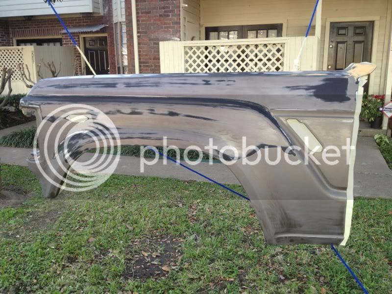

First coat of primer

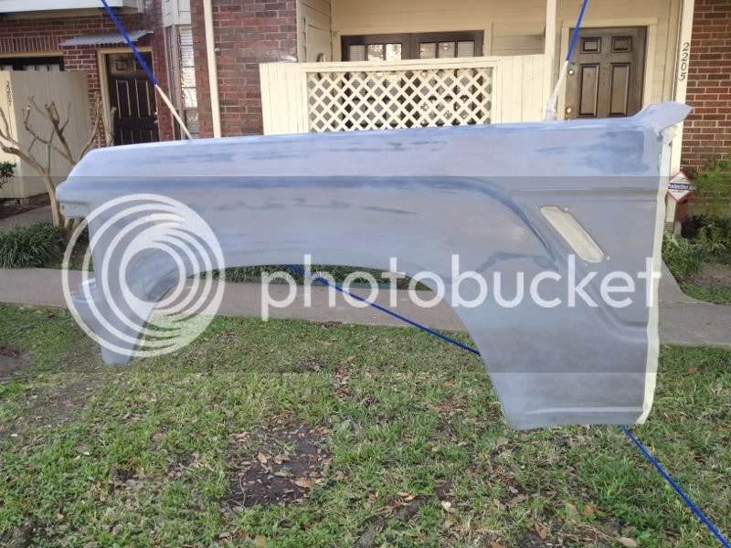

Second coat

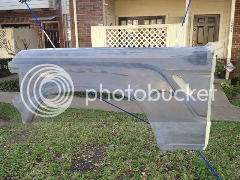

Third coat
Fourth coat

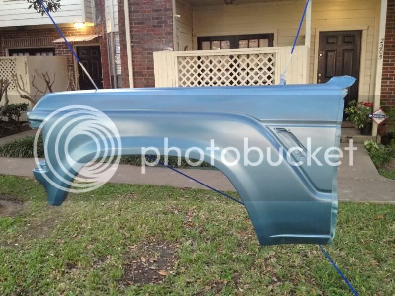

Color on
Color touched up and clear coated with three light coats.

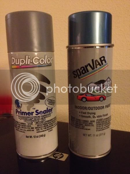

The primer/ paint I used
Will post tomorrow with a photo of the fender installed. Had to stop here tonight because it got dark

Here it is. What do y'all think? Sorta close. Much better than what it was. For $4 a can I ain't gonna complain. I plan to get this professionally repainted once I have the funds. Hopefully within the next 10 years.
Definitely better than what it was! Looks like you got uniform coverage out of the spray can, which can be difficult to avoid the tiger stripes.
