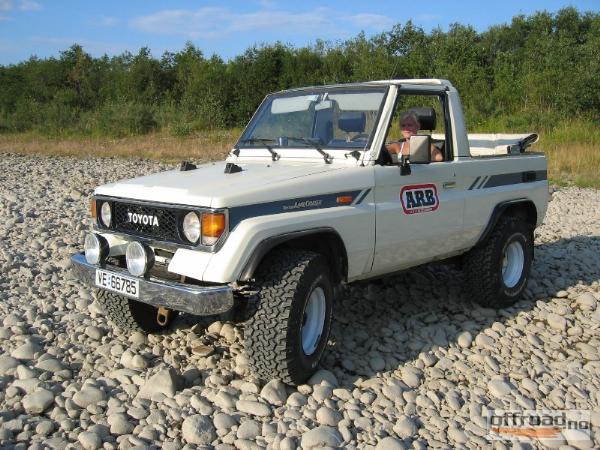

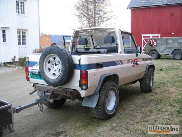

My 2 cents...If you must have fender flares, try and get some factory ones that mount with the little brackets. If you use aftermarket flares that mount with screws through the
inner/outer fender the rust will take hold.
ARB Australia and TJM Australia both manufacture rubber AND fibreglass flares and neither use screws through the guards, they both bracket on like factory.
