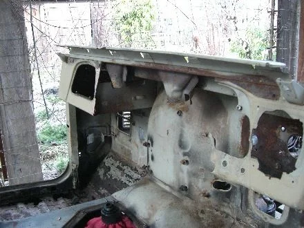

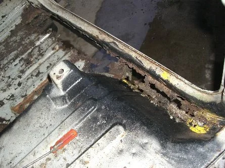

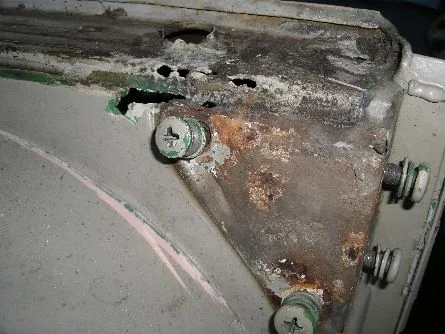

-I bought it off EBay Australia from a fellow who lied through his teeth, surprise, surprise, and ended up landing the HJ47 back on Vancouver Island for a total of about $11,000. It looked alright at first, but closer inspection revealed 1/2" or kryptonite-like roofing patching compound in the floors, a lot of white smoke when I got it running, and a wring loom that was a total mess. So, instead of doing the sane thing and trying to sell it, I decided to rip it completely apart. What i found, was hardly a truck, as the seller put it, that had "no beach, no bondo, no rust"
Dec 9, 2006
2,974
Greenfield, MA

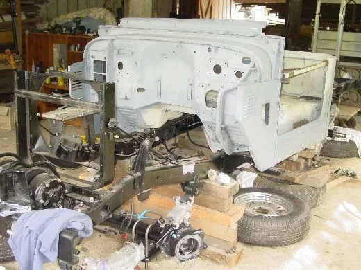

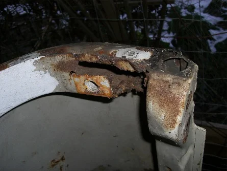

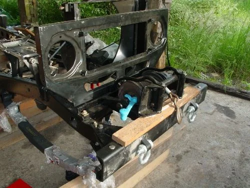

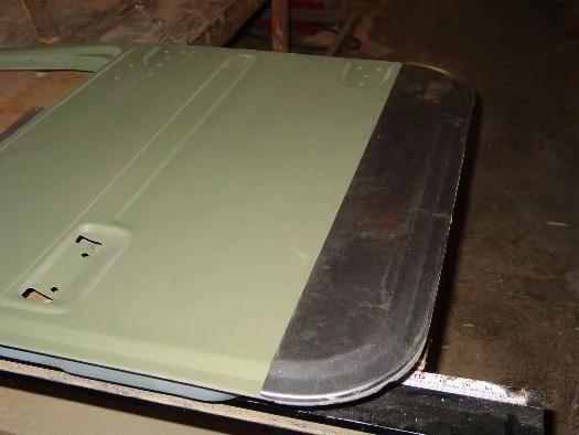

The more I looked into things, the worse the truck's condition proved to be. Fortunately, I had naiveté on my side, and decided to take it on, even though i had no idea what i was doing. The front cowling proved to have terminal rust in a number of areas, so this lead to one of the major early decisions with my rig - to convert it to LHD by obtaining a better cowling/firewall, which I happened to be very fortunate to locate in the local area.

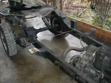

Here's some more pictures of the bodywork scene as I started out. The chassis was the only blessing, literally the only part of the truck in good condition with only a loose spring hanger to deal with. I was very thankful for that, as i've since seen frames in much worse condition.
Dec 9, 2006
2,974
Greenfield, MA

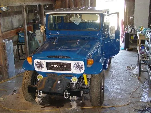

So began 2 years of work, semi-full time, 7-days a week, and an outlay of some $40,000 in parts and materials. i learned to weld, to do electrical, body work, and rebuilt many parts. I know my truck inside and out.

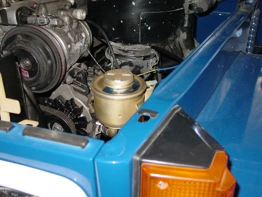

The engine that came with the truck turned out to be thrashed, and in need of a full rebuild- again very luckily I came across a 2H in a local wrecking yard for $2000, out of a 1986 HJ60, with 315,000km on the clock. This engine has proved to be in fine shape.

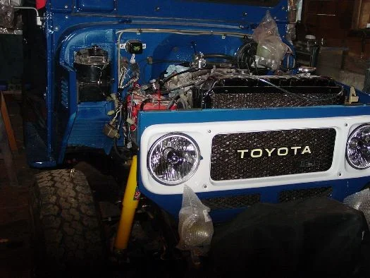

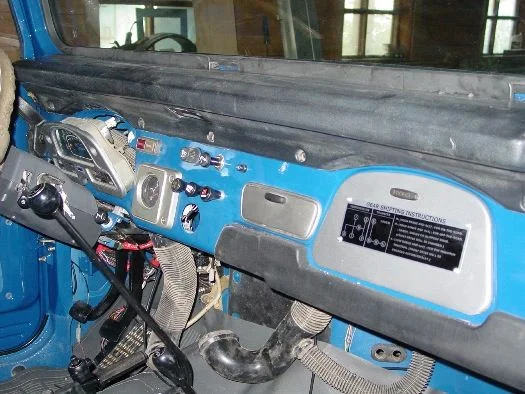

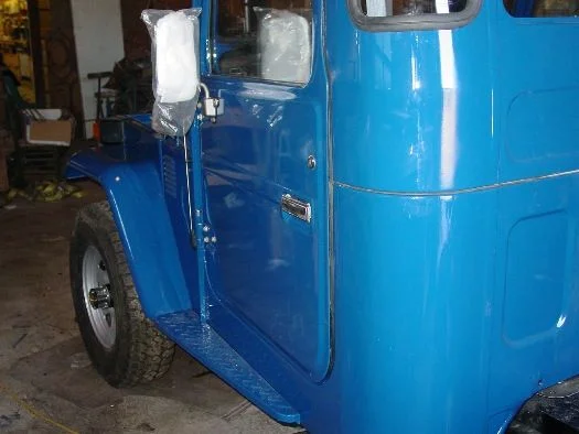

In summary then, this is what I ended up with after all that time, expense and effort:
-LHD HJ47, 12v.
-power steering, with a 2000 Bandeirante gear box, modified rad., and oversise TRE's and rods, with the tie rod over the axle configuration.
-4 wheel disc brakes, 4Runner calipers all around, 80 series booster and master w. 1" bore, and proportioning valve.
-rear Full Floating axle, 8-bolt
-aprons customized to mount 70 series turn signals
-near new pto winch on the front, from a JDM HJ61
-factory fog lights and switch
-factory tachometer custom fit to dash
-factory pintle hitch
-H41 transmission with split case (rebuilt completely) and parking brake (all new) mounted on case.
-diesel 2H without EDIC system- uses simpler VSV-controlled set up, and custom throttle damper (from a Mazda 323) adapted on.
-60 series steering column adapted to fit, with significant dash customization. This gives me a collapsible column, and switches mounted on the column instead of the dash.
-60 series seats.
-new OME Dakar springs, and SprungArt greasable shackles, new OME shocks of course and steering damper.
-new glass front and rear, new fender and bib. All rust cut out and new metal welded in, as close to stock as I could manage. Tub is coated underneath and in floor pan with SEM truck bed liner. Epoxy primer underneath.
-all new weatherstripping and rubber everywhere. If I could obtain it OEM, I got it.
I think I have a pretty unique truck, and it certainly garners it's share of attention whenever I take it out on the road. A lot of people seem very happy to see it - like it makes their day! It makes my day to drive it - I'm very happy with how it came out. I think my truck looks 95% stock, though it's actually quite customized - only a LC nut would notice the differences I think.
