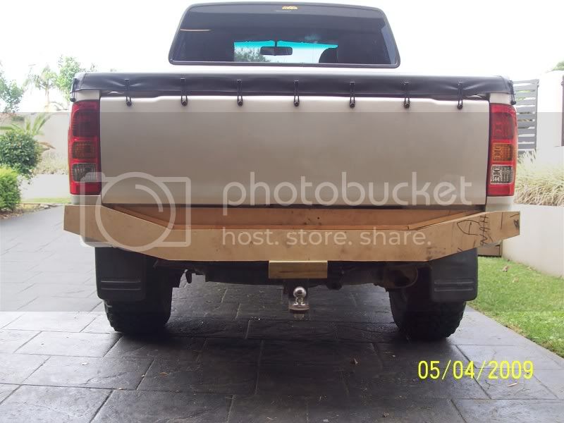

So now i need some where to put it :x

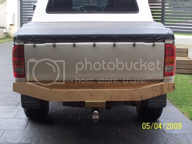

Out come the timber and tape to whip up one of these, a template
A few cuts later i had a pile of steel :shock:
Then got the welder out of thw cobwebs went to bunnings and got a roll of gasless wire (i hate it but it works)
About 3 hours later i have this.

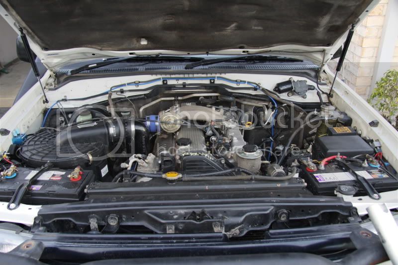

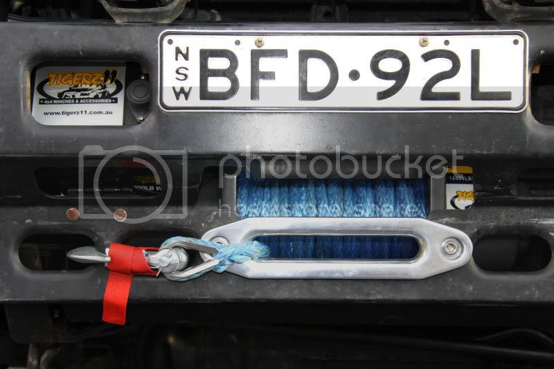

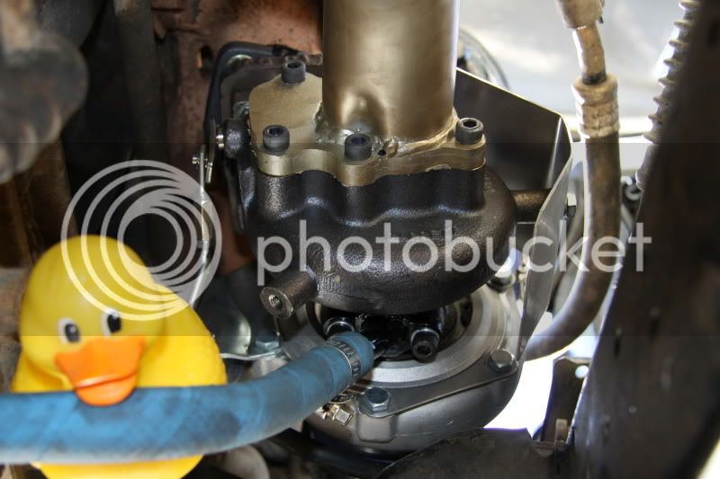

A few things have changed, I must have been a good boy this year, for my b'day (that is not till July but we will be up the Cape) i got a new 12,000 pound tigerz winch with rope aaannnnddd a Turbo-Glide Turbo system
. I the pic you can also see the billet race craft diff breather block (the blue thing on the left) it takes 4 inlets, front diff, rear diff, transfer and gearbox.
New winch.
Turbo and diff breather kit.

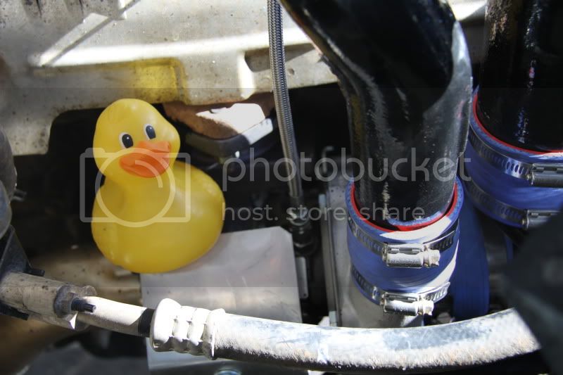

We have a thing on the overlander forum where if you get a new camera your first pic to be posted MUST have a duck in it, soooo i posted this one:D

1. I noticed you wanted to add a Turbo. Was that a replacement (more pressure) or did your Diesel not have a Turbo from the factory?

1. being a 105 series (solid front axle)they only come out with a Non turbo 1HZ engine not the 1HD-FTE factory turbo engine that are in the 100 series (IFS)
