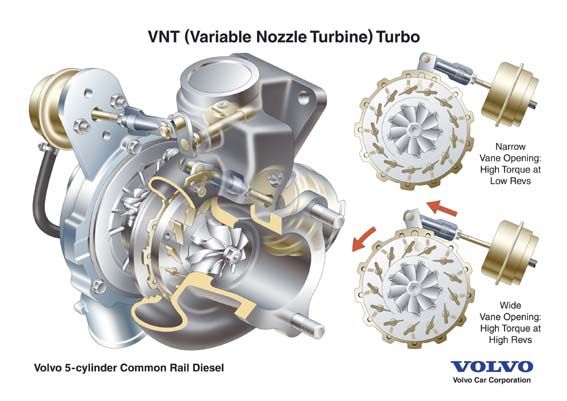

Someone mentioned it might be the turbo with adjustable pressure controlled by a vacuum actuator (from Aug 2002). Is the vacuum solenoid OK?
The vanes may be gummed up and getting stuck in the Turbo. If they get stuck one way, it will be slow to spool, but boost fine at higher RPM. If they get stuck the other way, it will spool fast, but choke at higher RPMs. But because it is a VNT, there is a lot of area in between as well. If you have a hand vacuum pump that does pressure and vacuum, you can manually actuate the vane actuator to see if the vanes stick.
It could also be a bad/dirty air flow meter, and the ECU is pulling boost because it's not getting a correct value. Same goes for if the ECU isn't getting the correct values for the intake pressure or turbo pressure (the chart seems to indicate there are sensors for both intake and turbo).
Hope this helps, I don't have any first hand experience on a 4.2, but based on prior experience as a tech, this is what comes to mind first. :)
Oh yeah, VNT:
