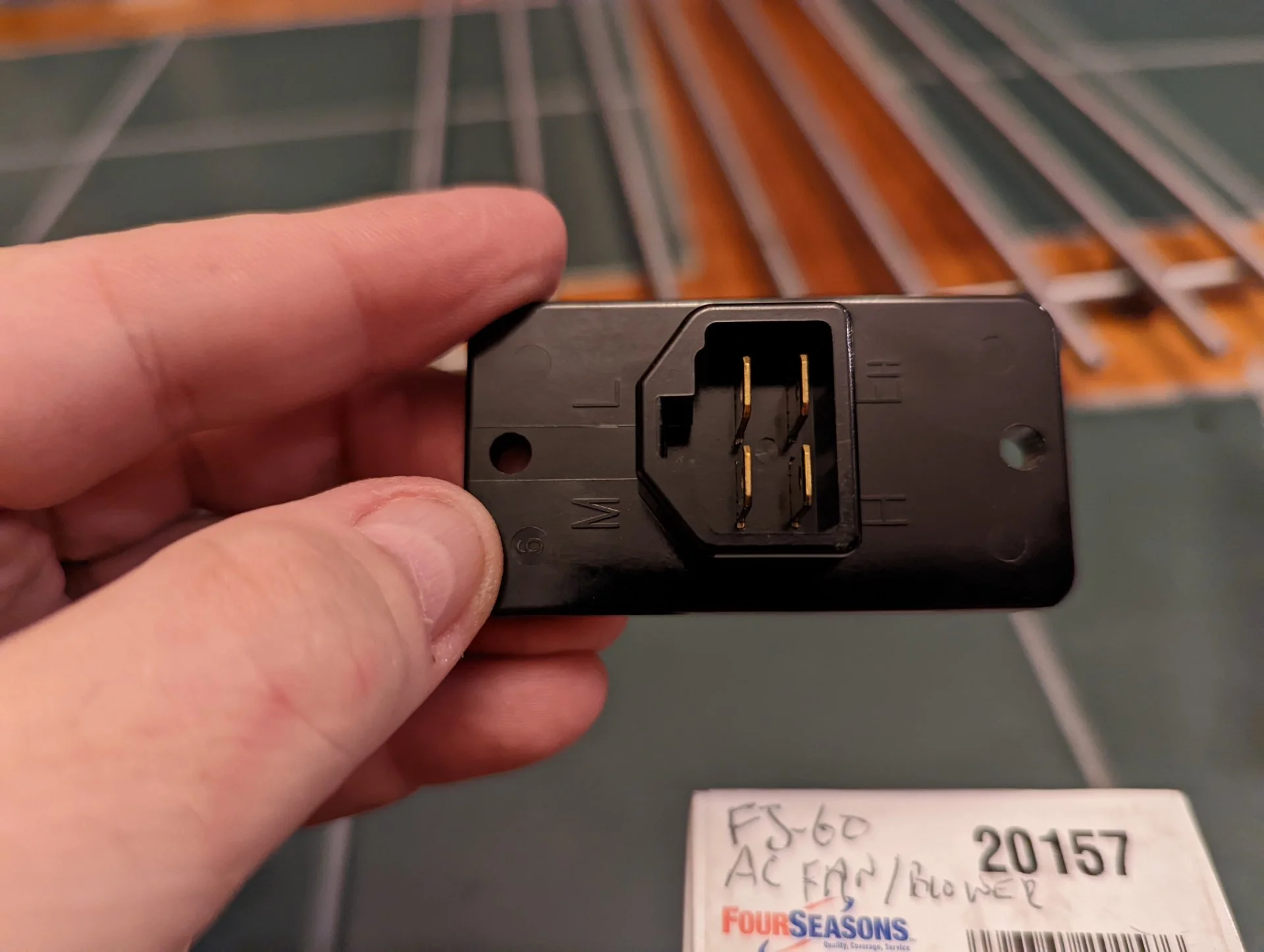

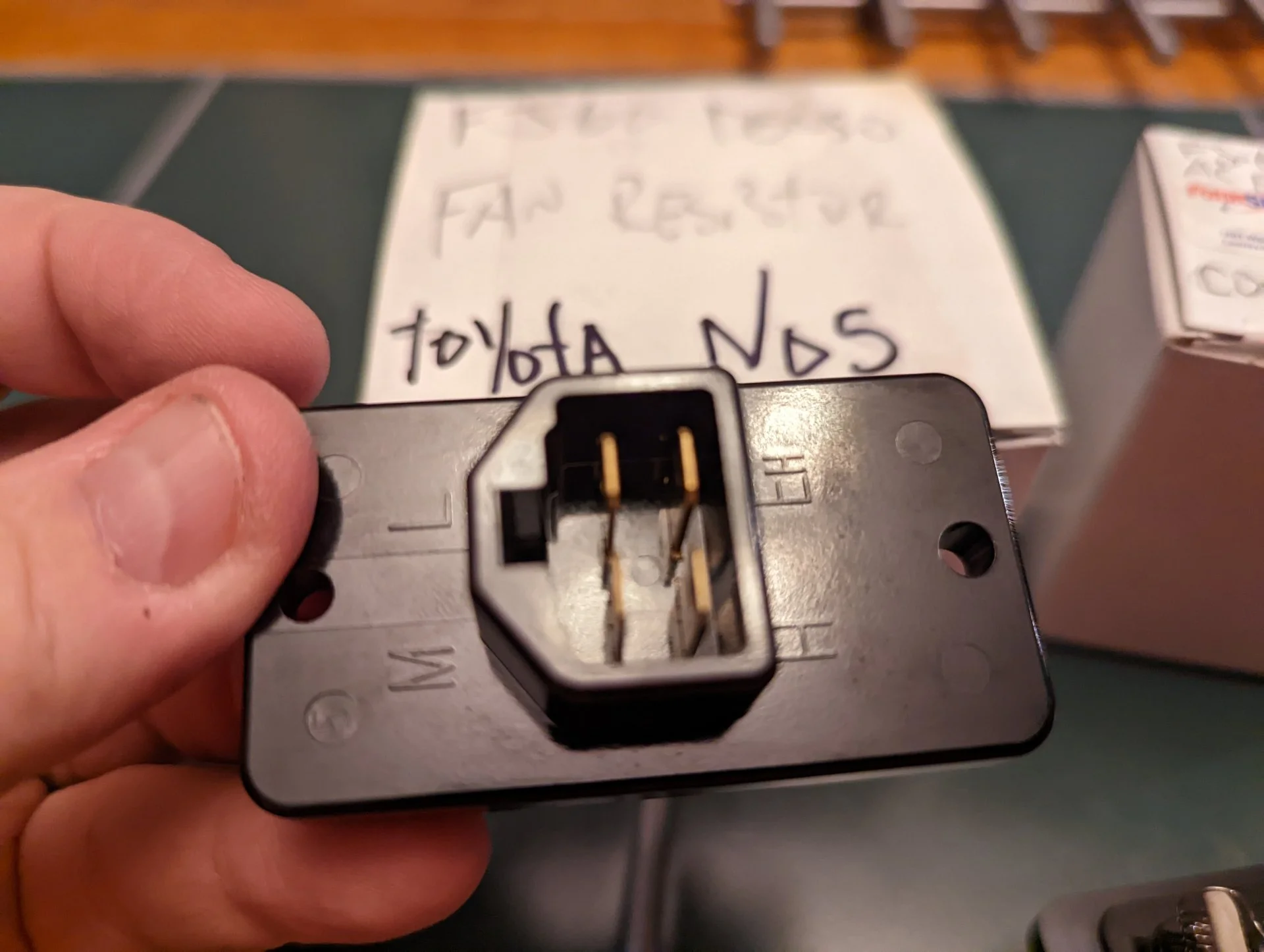

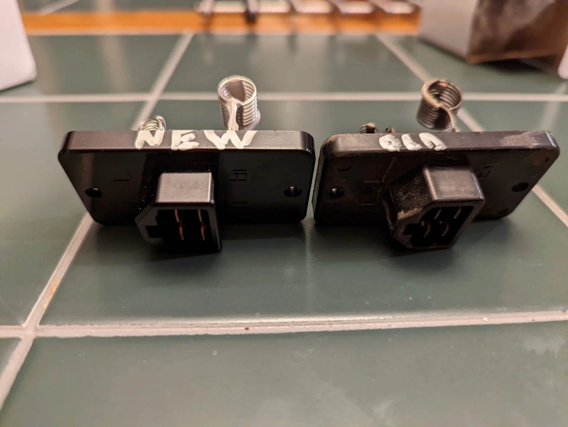

Two sets of pics, first shows toyota Matt's denso fan blower resistor vs the oem one I pulled from the 60.

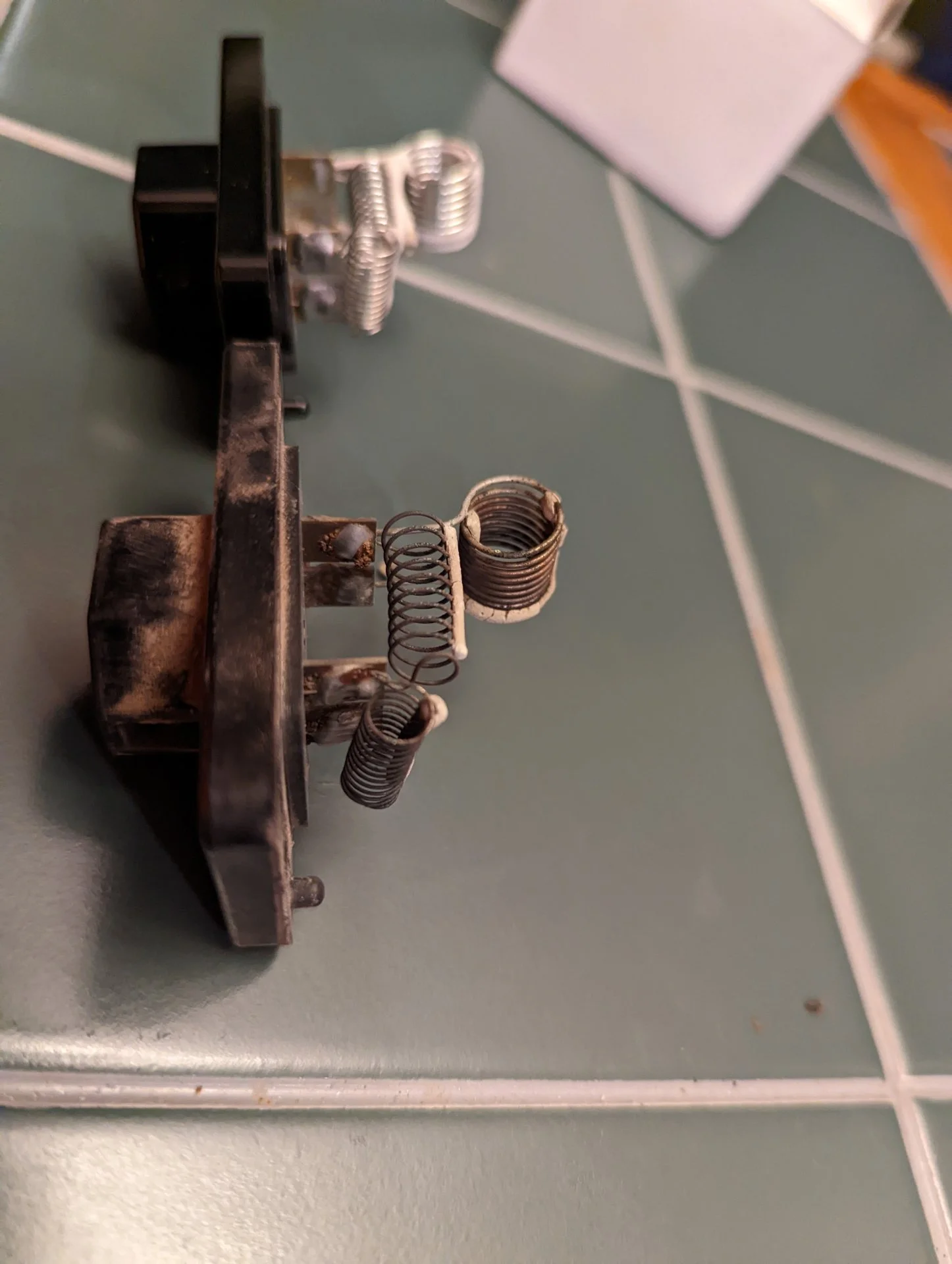

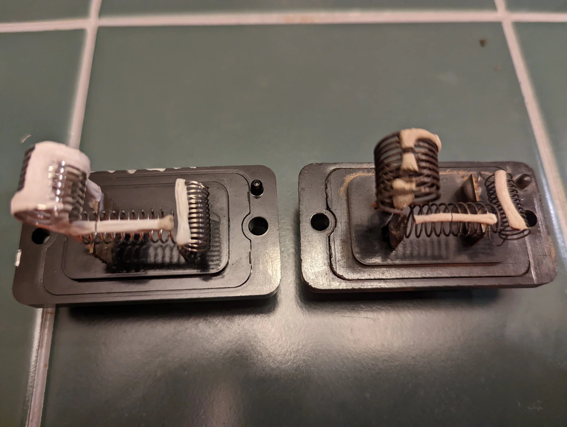

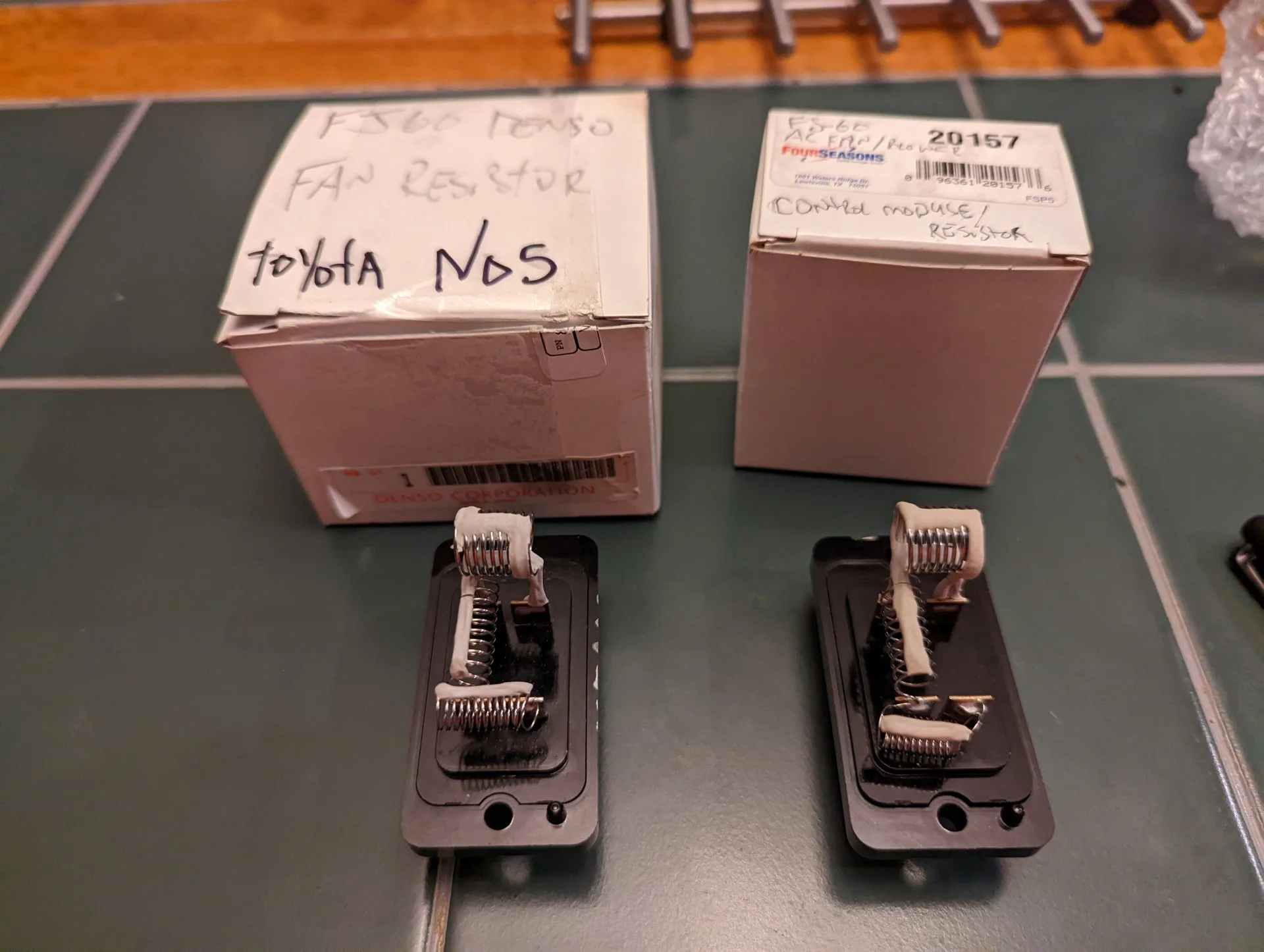

Second compares the denso vs the four seasons ones. The bent coil on the four seasons one might be my fault from handling before I knew how fragile they are
Last 4 pics of comparison 2
Honestly aside from the bent coil on the 4 seaons that might be my fault, and the age and corrosion there was very little visual difference.
I went with the denso (after replacing the blower with denso also) and it fixed my ac breaker popping issue.
I've mentioned that before, but I thought folks might appreciate the pics of the blower motor resistor options available.
