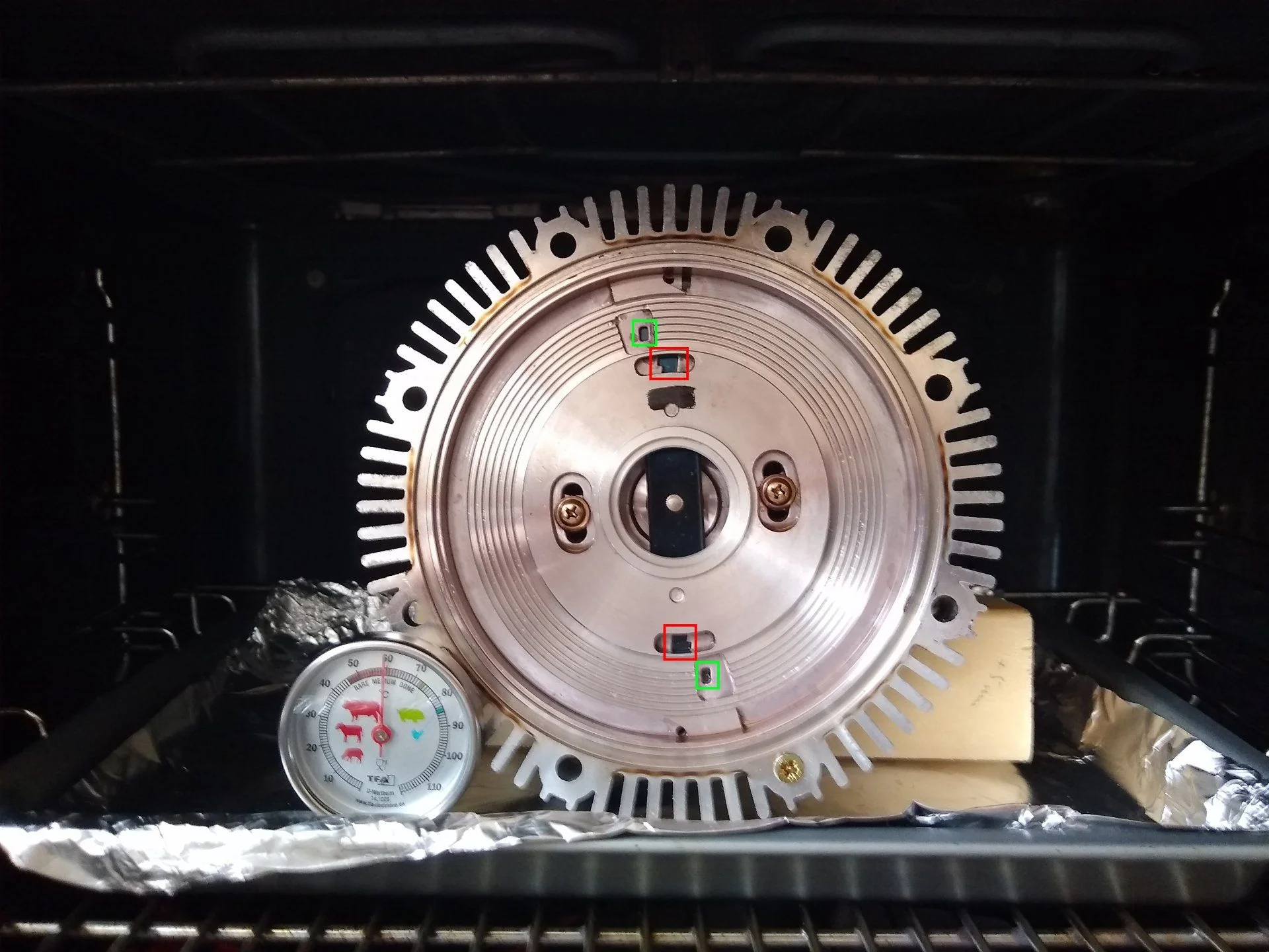

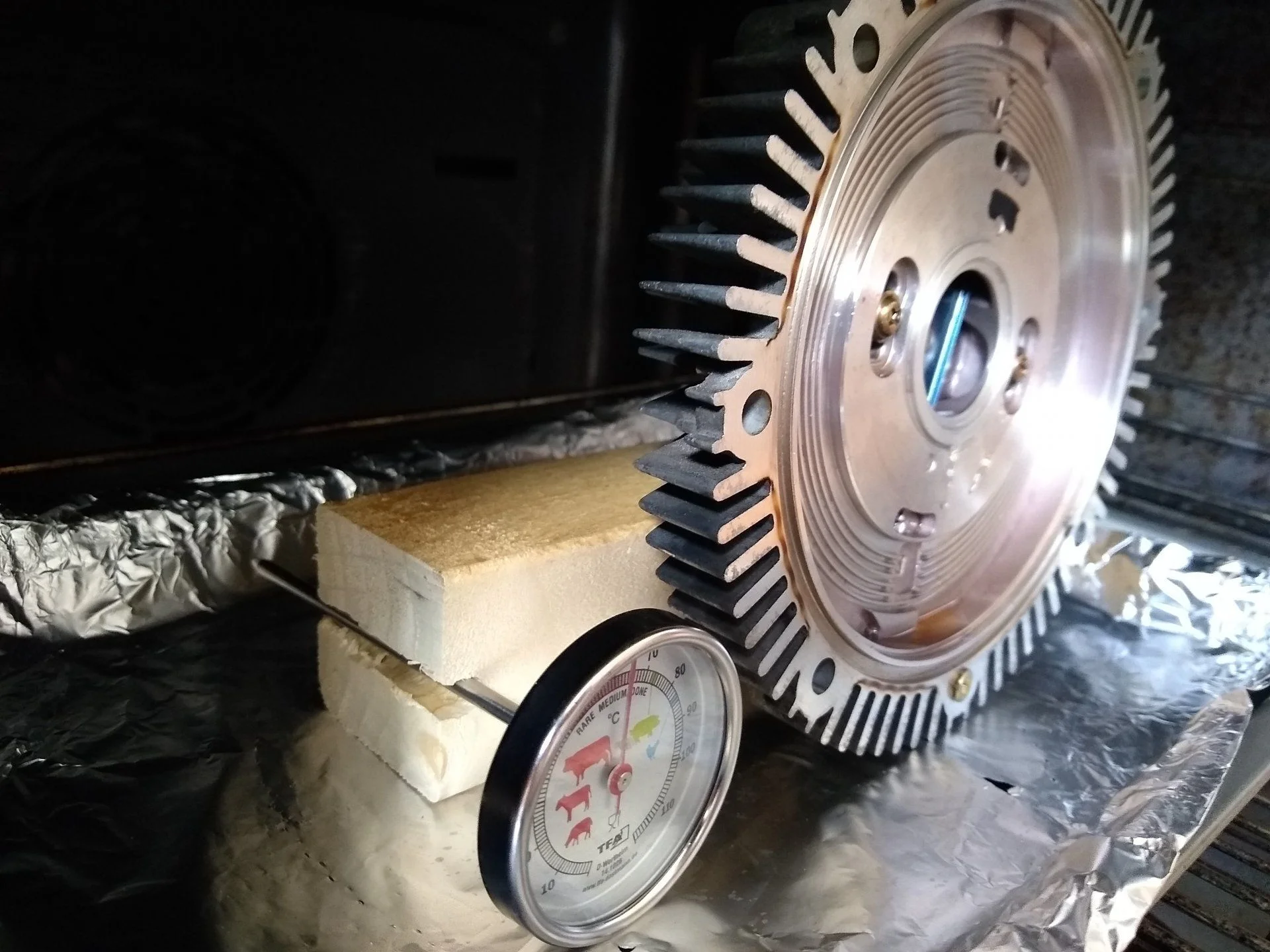

Hi guys, I been doing some baking in the oven today :rofl:
So I split the clutch, drained all the oil, put the half that opens up in the oven, propping the clutch up by screwing it into a piece of timber.
My theory is that this setup would sort of replicate what the coil spring sees inside the engine bay in terms of heat (I read here that the water and pan method is not ideal?)
I'm using a meat probe thermometer, not great as it needs to be stuck into something to work, so I don't know how accurate the readings are, but I don't have anything else to hand for the job.
Things I noticed and would like to report back:

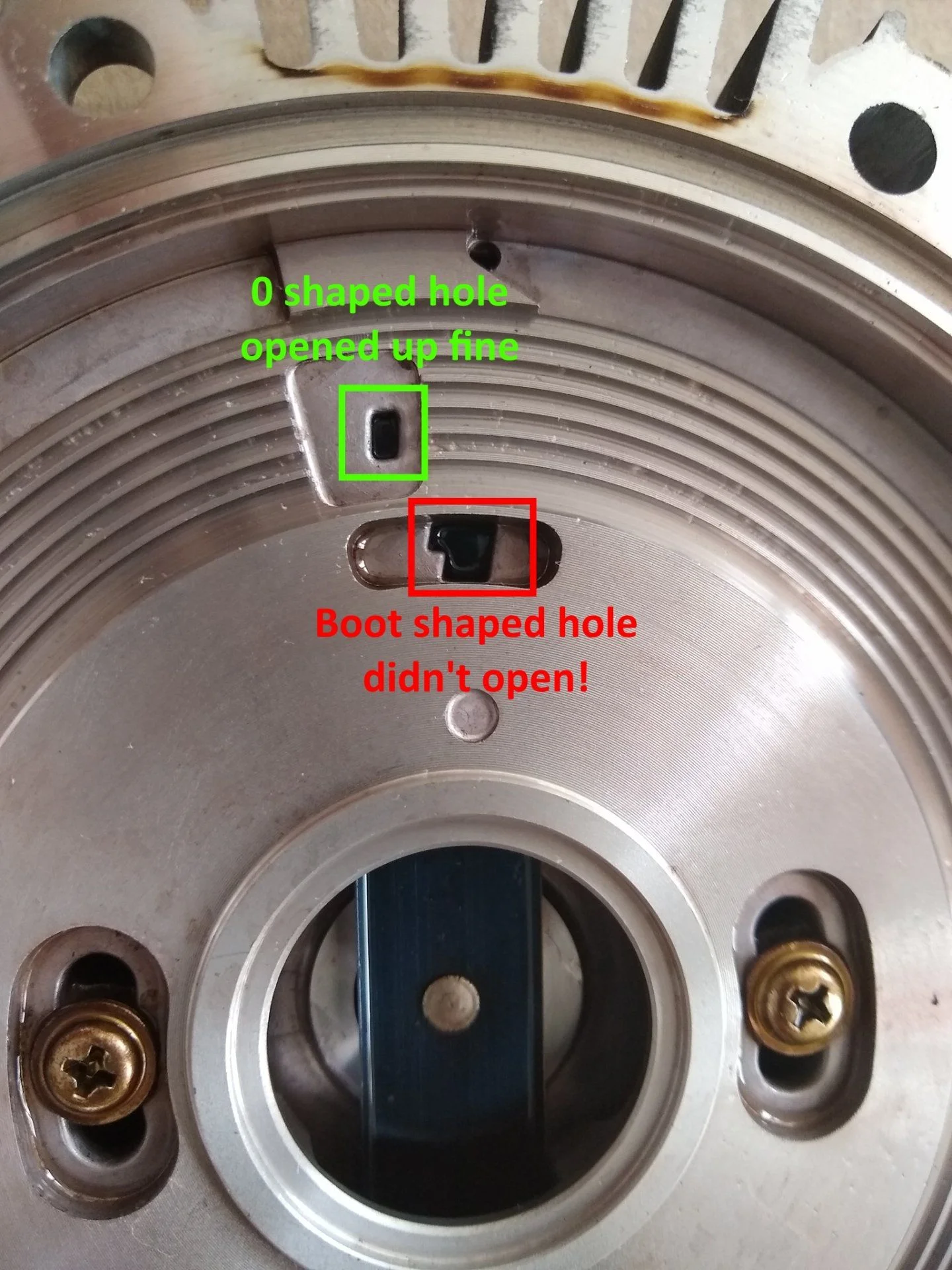

1. Only the small 0 shaped windows opened up once the temperature on the thermometer got to 65C / 149F. At 50C / 122F, it was still fully closed. Is that OK on the basis that my thermostat is rated at 82C / 180F? Or should I try to make some adjustments so it opens up full at 80C and over?
2. The boot shaped holes (highlighted red), didn't open up at all (just the 0 shaped holes open), not even when I heated the oven up to around 120C / 248F! I note in previous posts that the boot shape opens up, well mine doesn't 👀. Do I have a faulty clutch or it was supposed to be like this?
3. Midman asked - my clutch is grey, not sure if it is a good or a bad clutch, I assume it is ok as the car comes from the early 1990s, an era when things were overbuilt and not a massive budget like these days

I don’t like using the water method because it isn’t realistic to what the clutch sees in everyday use. The method you’re using is decent, but the best way would be to stick the end of a thermocouple in the spring and heat it with a heat gun. It’s the only way to be sure the spring is getting up to the temperatures you want to see. When testing, you’re not looking for the temperature as it opens, you should heat the spring enough to open, then watch it close and record the temperature that way; this is one of the reasons it takes me upwards of 20-30min to tune a clutch (even more if it needs adjustment, but I see that less on Eaton clutches and older black hubs for the 80). If you’re heating metal, it won’t heat up uniformly and it will continue to get warmer as heat is being introduced to it, so knowing the temp of the spring itself is critical. An oven can be set to a specific temperature but there‘s usually a massive heating element nearby (bottom or top if using the broiler setting) getting considerably hotter than the temp you’ve set it to and screwing with your results.
Hopefully that makes sense.
That said, if you’re seeing an initial opening at 122°f, that is just about on the money. When I’m tuning a fan clutch I shoot for around 115-120°f for the first opening. Two degrees puts yours right into that acceptable range, assuming your test was accurate enough to be considered correct.
As for the boot shaped opening, to test that positively, hold a lighter to the spring and see if that makes it open up. I don’t think I’ve ever seen a spring totally fail on a clutch unless the inside is filthy. The inside of yours is nice and clean and your testing method leaves some room for error, so I would be inclined to say either more testing is needed or just fill it with some thicker silicone and see what happens.
As for the question @MidMan asked, Aisin paints the hubs of their clutches. For the 80, it makes reference somewhat easier, but there are still issues. The two Aisin colors for the FZJ80 are black hub and blue hub; their designs are slightly different and the cst used must be adjusted accordingly for this design change. This should make it pretty easy. Except that the early replacement Aisin clutches were a black hub design with a blue painted hub. The increased confusion is why I prefer to just open the clutch up and see what it looks like inside.
The increased shearing area (ribs) is more akin to a black hub In design. More shearing area means a lower cst will net the same results as other clutches.
And the coolant temp has less to do with the fan clutch temp. You’re looking for the temp the air in front of the clutch gets hot enough to open the valve and make the clutch turn on. 180°+ will not translate to the 120° The clutch needs to operate.

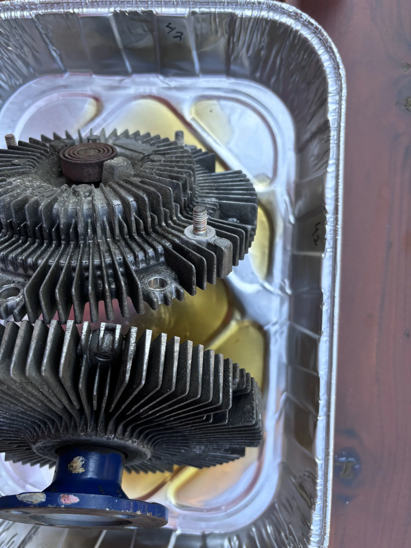

and then I filled one half with a bottle of Team Associated 7,000cst silicone fluid (59ml). I did think that I could probably get more than a bottle in there, but don't know if that would have been a good idea, so left it at that and sealed the whole thing back up again.
normally fan clutch of 80s takes 50-70ml oil depending on various clutch models.
I am guessing this in not what people would think of as healthy fan clutch fluid......30 years old never been touched. It will be in the direct sun for the next couple of hours, then perhaps overnight in a warm, no heat oven
I have 10k cst ready to go, this is not a hard service 80 series.
Honestly, it goes brownish pretty fast. Yours is roughly the same color as the 15k stuff I poured out after a month or so (I switched to 10k). Getting the old fluid out is a process of diminishing returns. You probably pour out 2/3 of it in the first minute, 2/3 of what's left in 2 minutes, 2/3 of what's left in 4 and so on... A few hours to drain is probably fine, just don't overfill it.
I have a good tare weight on the pan 42 grams. With all the fluid that came out, it weighed 87 grams. My bottle of 10k weighed 75 gr. - so I took it down to 30 gr.
The resistance to spinning by hand seems to have substantially increased.
You most likely had 3k fluid in there in North America, so even apart from any degradation of the fluid, the 10k will be a big jump. I'll bet the most notable difference will be improved AC at lower speeds.
