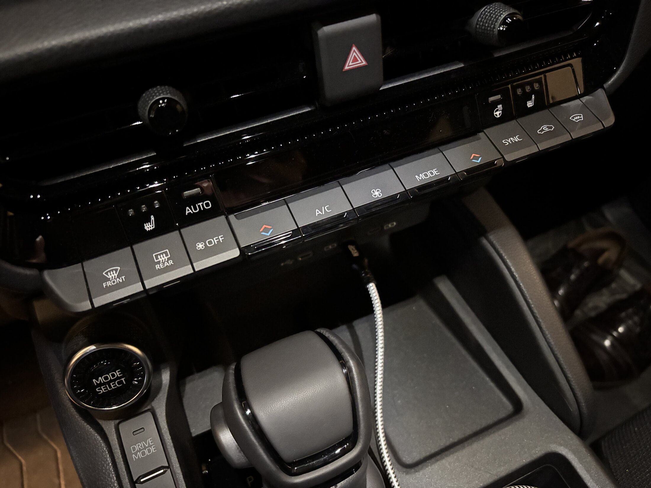

Is anyone noticing the fan speed blowing significantly lower in the highest manual heater setting (rather than cooling) when set to upper body/face airflow? I think I've tried everything but maybe I'm missing something. Drive mode is set to "Normal," fan blower setting in manual mode at highest notch, airflow set to upper body, heat temp set to HI, S-flow off (concentrated airflow mode), and "eco air conditioning" mode off. Additionally, I've toggled the following off/on and they seem to have no effect on the blower speed either way: Rear System on/off, Recirculate on/off, and A/C switch on/off.
It seems like the culprit might be the airflow mode "baffle" not going into the right position when on high heat manual & upper body airflow mode. When set to defrost, the fan speed seems a bit more powerful.
Another observation. My 1958 does not have a "Windshield de-icer switch" but it does let me turn it on thru the touchscreen. I thought the "Windshield defogger switch" would turn on the windshield deicer automatically, but this morning that didn't appear to be the case. Need to test it again with frost in the morning. It could just be me, but the HVAC settings aren't that intuitive. I still appreciate all the buttons I can get and I'll figure it out eventually. Wish there was an easy button for all heat settings full blast and all cooling settings full blast.
Update on the de-icer: It works great but you have to access it thru the touchscreen.

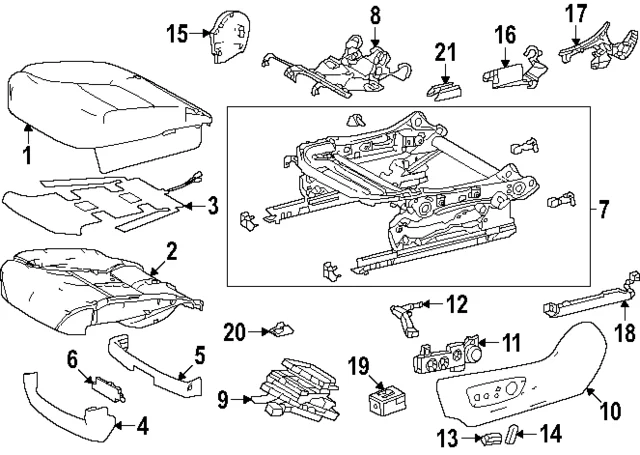

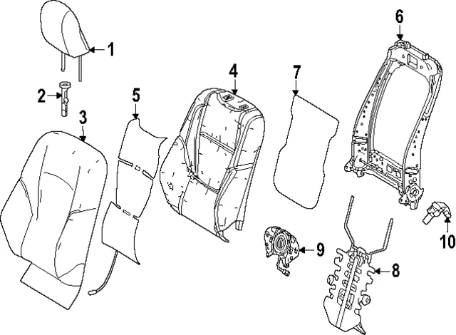

In heat mode, the blower doesn't flow like the ventilated mode to cool. The seat pads have heater strips in them and the more lights lit, means more resistance to the strips to make the heat more prominent. Parts 5 and 3. Depending on thick winter clothing and whether you have leather or simulated, could determine how quickly you feel the heat.
