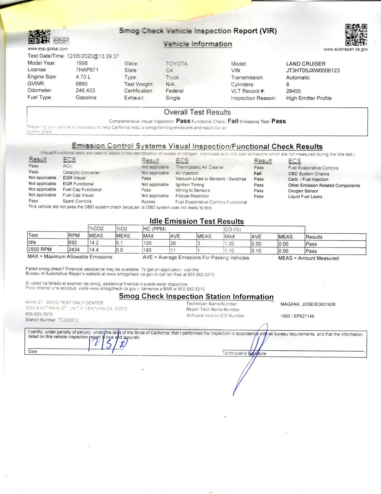

As title states my '98(246,433 miles no engine mods) did not pass smog test last week. The smog tech guy asked if I had recently installed a new battery or had a jump of the battery, which was a yes to the jump. He then asked how much it had been driven since the jump, me; maybe 10-20 miles over last month. He said that I should put 50-100 miles to set/reset engine computers for the smog test. I had the same issue with my wife's '07 mustang smog test but it was for a new battery and the tech guy said 200 miles to set/reset engine computer( 200+ miles worked). So has anybody had this experience with this with their Land Cruiser or is a smog tech to de-mystify the process.

yes, the monitors need to reset after an interruption in power. That takes a bit of driving with some given speed profiles, such and such speed for such and such duration and the like. That's well documented out there. In the case of my 80 I noticed that most monitors reset within a few miles, like 5 or 10, but one -forgot which- typically takes noticeably longer, more like 30 or 50, at least with my pattern of driving.
I do believe, however, that you can have one monitor not yet ready and still pass in California.
I always check for that before going to smog. You can get a reader for something like $20 or $30. Worth it to avoid a bum test. If I disconnected the battery just before the test, I connect the reader, drive around with the reader online and when I see all the monitors ready I go for the test.
I would hope that a nice tech would check for readiness before starting the test (but maybe they legally can't, don't know; and of course most would rather get paid for the full test than give you a break.)
Your emissions are very good, should have no problem passing once your OBD stuff is kosher.

Thanks to all for the reply's, got in a mixed 110 mi. run will test tomorrow🤞.

Passed:clap:, the tech guy at smog shop saw that this was a re-test brought out his OBD to make sure that it was ready for the test. After the test he asked if I thought that the land cruiser was as good as the hummer, me; how many hummers do you see come in here with 1/4 million miles on them....
