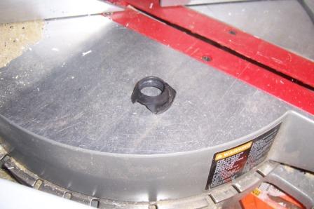

This is pics of the seal I asked about.
When I took my rear actuator off and used a 9V to move the arm out this little seal came out with it. I assume this is a seal that keeps gear oil from entering the actuator. Did you see anything like this when you took your rear apart or has anyone else noticed this seal?
