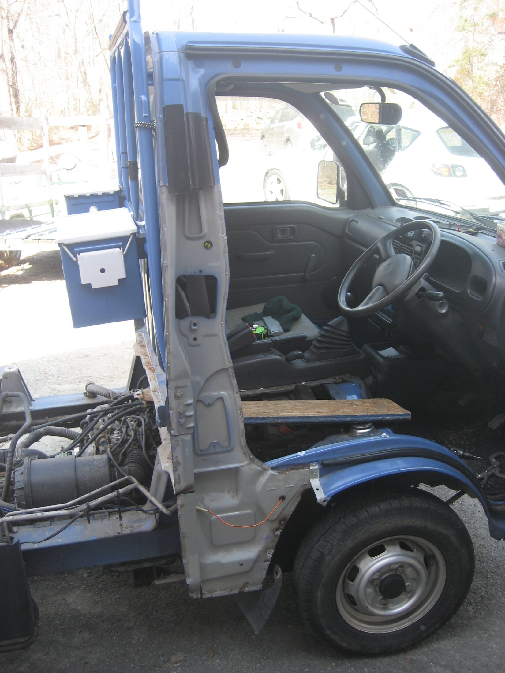

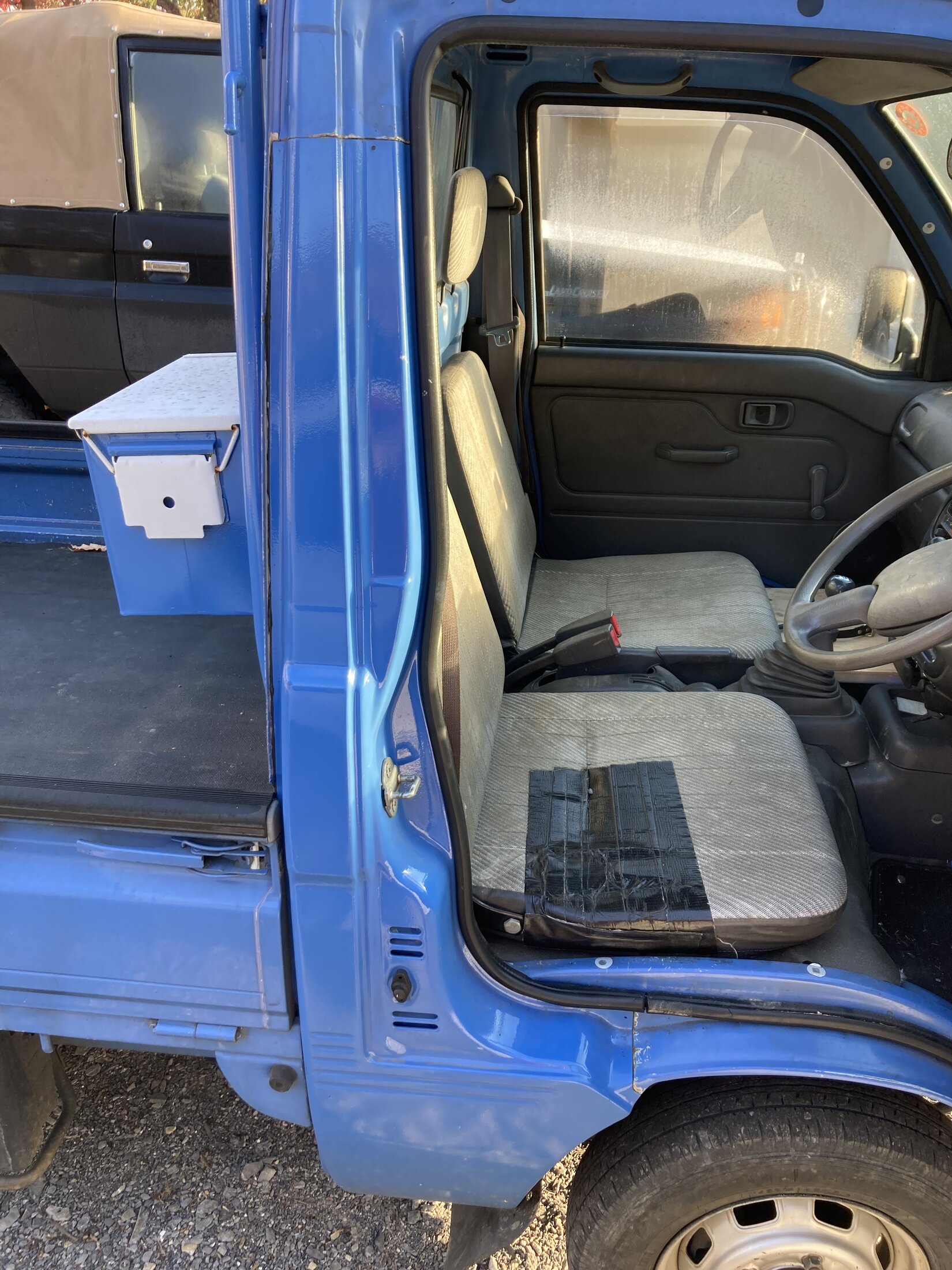

You should SEROIUSLY consider using a 2-part panel adhesive (glue) applied with the special dual "mixing" caulk gun.
I did this on my minitruck and there was no heat, splatter, no burn-through, no weld grinding, no seam sealer required.
I read recently that the SEM panel adhesive can be used with welding, i.e. a few spot welds to hold the panel in place while glue sets.
You do have to get both surfaces to bare metal and make them very very rough. I used a cheap Harbor Freight wood rasp to grate away at the steel and create a good "key" for the glue.
I really wish I had that glue when I was putting floors in my MGB. Seems like weeks of grinding and filling after making my own spot welds.
I forgot to say that I painted the panel before I glued it on. Easy. Still needs clear coat sanded.
Apologies for non Land Cruiser pics. Gray/black stuff is the glue.
