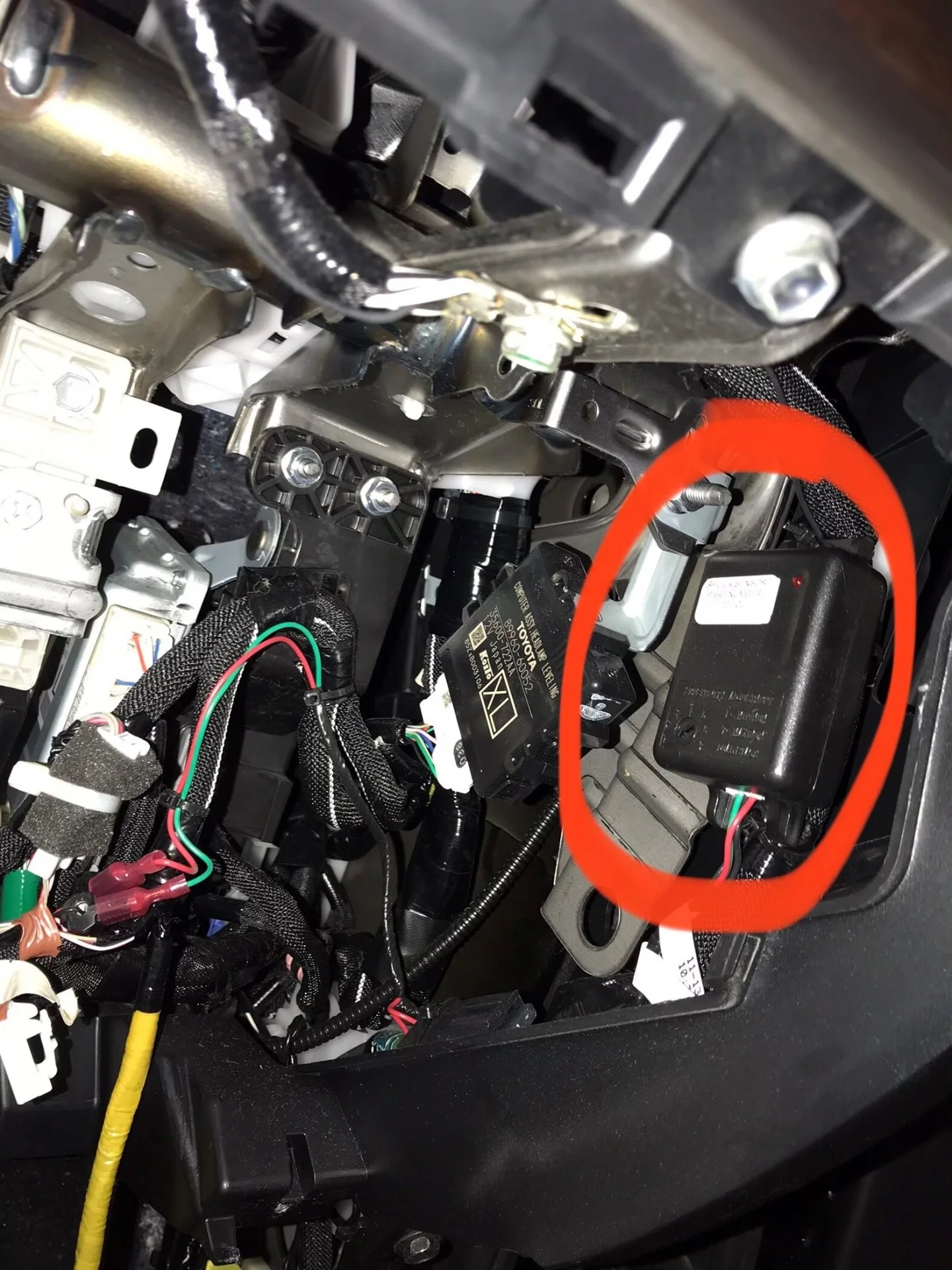

I had a similar alarm issue that developed with my 2018 LC over this past year. I use faraday pouches for my LC keys so I knew I was not accidentally setting off the alarm by pressing the alarm button while in my pocket. I had a few visits to the dealership over the past several months about the problem in an effort to diagnose and fix the issue. Of course, the alarm would never go off at the dealership to allow them to see the problem for themselves.
First, we changed out the battery--thinking that maybe since the vehicle has been sitting inactive for longer periods due to working from home during COVID-19, the alarm functions were somehow being thrown off. But, within a few weeks later it become apparent the battery was not the issue. I asked the dealership to see if there was a glass sensitivity setting which could be reduced, but the dealership told me there is no such setting on LCs. Note that I had to have the windshield replaced a couple months after brand new, and although the alarm was not an issue for a couple years following the windshield replacement, it's possible that the windshield replacement somehow led to sensors being more sensitive then they need to be.
Nevertheless, after a few visits the dealership decided to replace the hood latch sensor (my truck is still under warranty), and I was told that while working on this, one of the more experienced dealership technicians looked at the truck and knew that sometimes the Toyota personnel (located at the "port" into which the truck arrived from Japan) install additional accessories, including an alarm sensitivity instrument. The port into which this truck was shipped was the Houston port. Anyway, this technician was able to find this sensitivity instrument just behind the glove box and see that it was set to a "3" on a scale of 1 to 10. The technician changed the setting to "1" instead of "3." Now I don't know whether the hood latch sensor or the alarm sensitivity setting was the issue, but so far (after a few weeks) I have not had any issues with the alarm. I will repost if I later have issues.
Here's a photo of the sensitivity instrument supposedly installed at the port in Houston:
That looks like a dealer added device. Toyota should not allow dealers to hack up brand new vehicles with their add on security devices without the customer’s consent.
