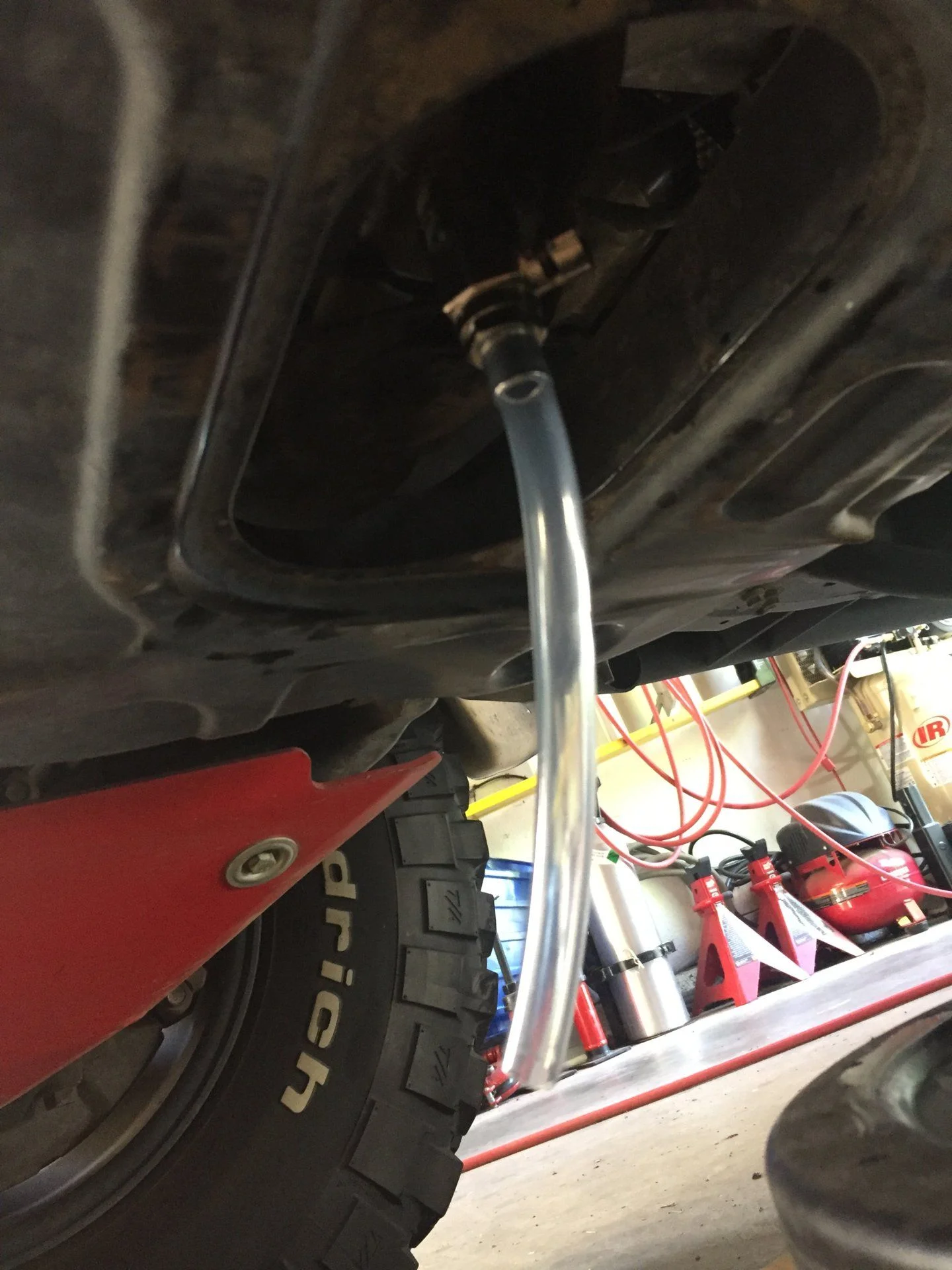

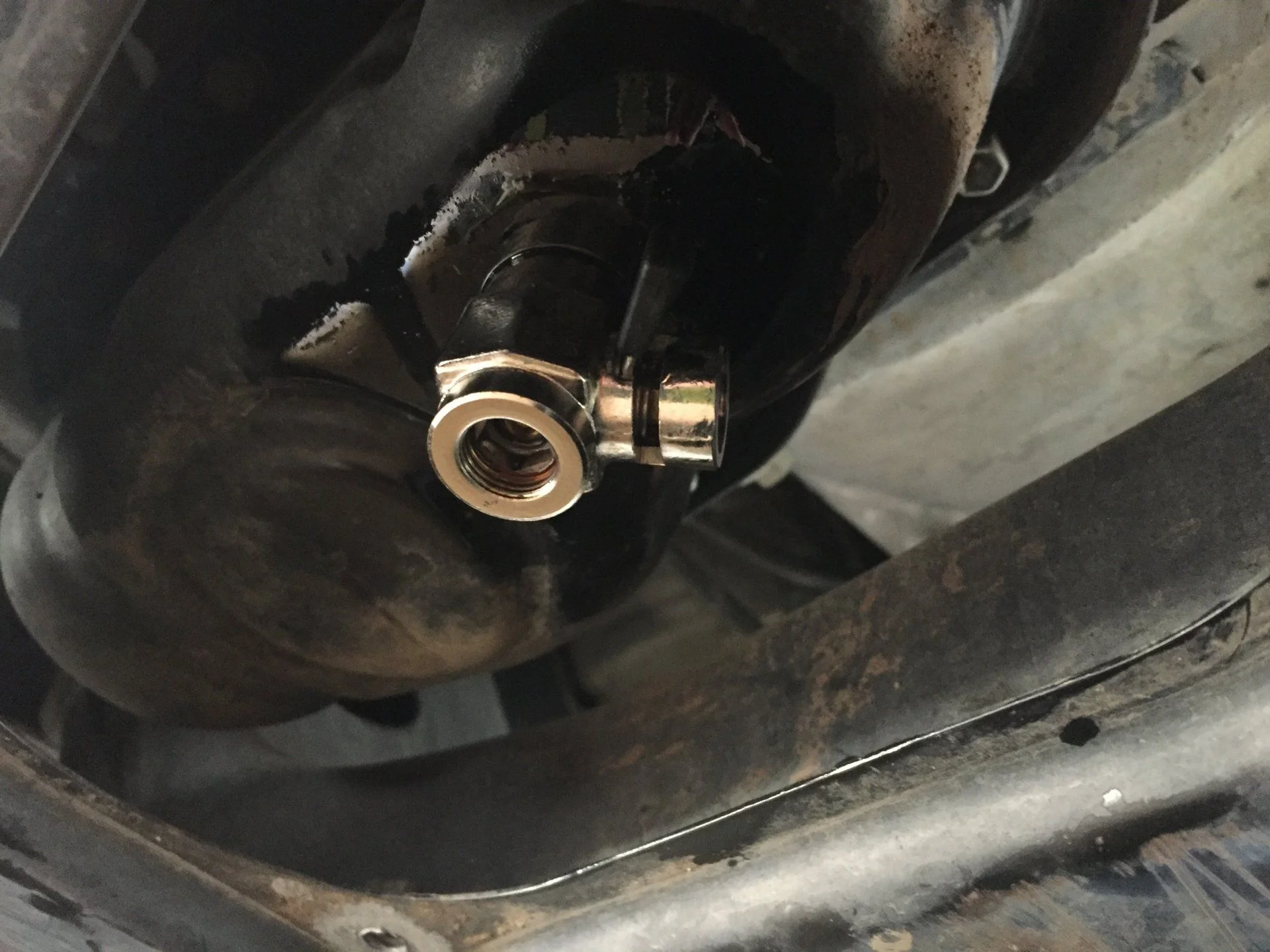

Hey guys, I got to give a shout-out here to the Oil Drain Valve guys at oildrainvalve.net in Washington. I found a link in a forum to their products and ordered what I thought was the one for my 2012 FJ. It was too large, I checked it against my gaskets for the drain plug. After I emailed them back they were nice enough to send me the correct one , EZ-103, and a return postage paid envelope for me to return the wrong one. Nice. This ball valve is really high quality stainless steel and the handle has a detent it sets in so it cannot be inadvertently opened. I also ordered the $4 screw-in hose end piece that hooks up to a short length of clear 3/8 dia. hose. Pics here from todays oil change and valve install. Plenty of room under the sheet metal cover.

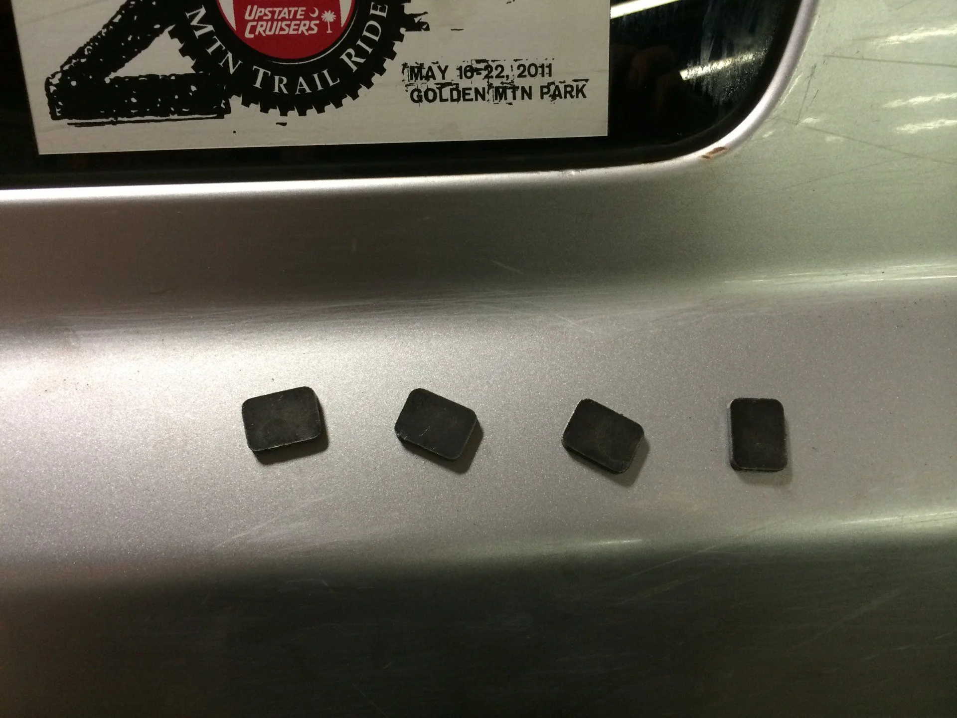

Plug is not magnetic, but there are 4 magnets in the bottom of the pan below the wire mesh filter.
Here they are stuck to my rear quarter panel when I did this the first time.
