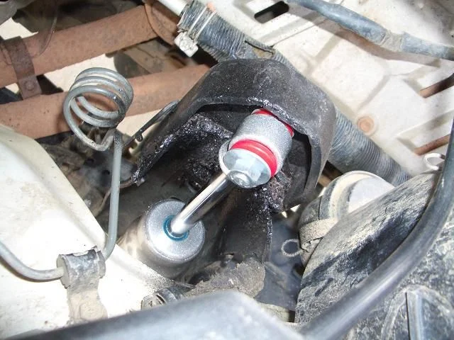

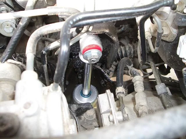

The drivers side tower I did second, and I put a second hole in it so I can mount the shock 1.5" lower if I feel the need at some future date. I'll have to drill the passenger side as I only put the one shock mount hole in it. The pins came with the new shocks, and it made building the front towers much easier. I bent the sides of the stock towers out a bit. The bodies on these shocks are just HUGE, and I wanted to make sure I had clearance. Lifted the front up enough that I was able to pull out the spring to add a coil spacer, then I realized that the aluminum spacers I bought used are for REAR springs! DOH! Maybe I'll just take the bumpstop spacer off and space the coil mount thing down 1.5" ala metal tech spacers. - Also of note, though I have a 1" body lift (as of Friday), I certainly would have had enough room to mount the tower extensions high enough to fit these shocks without the body lift. Getting into cut off the top of the tower was a challange though. I could have saved myself hours of work (literally) if I had a plasma cuttter!

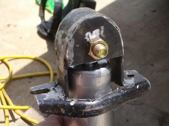

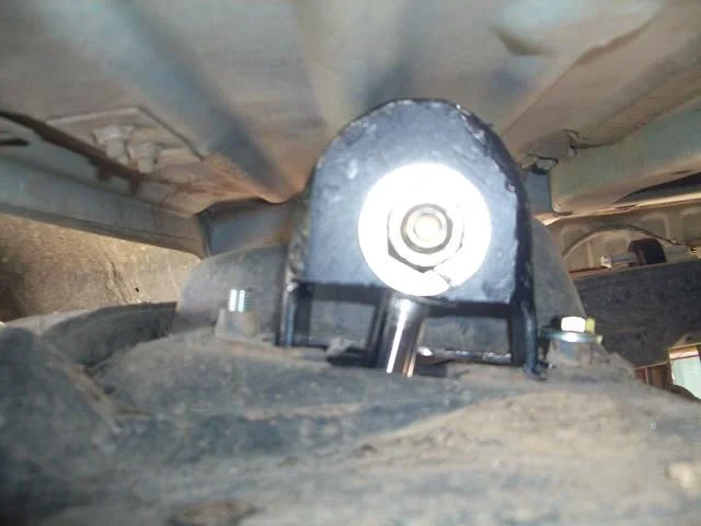

The rear mounts were much more of a challange than I thought they'd be as I had to clearance the frame part of the mount - again cause these shocks are just so huge. Would have been easier if I was doing 'normal' RS9000's or just about any other shock.

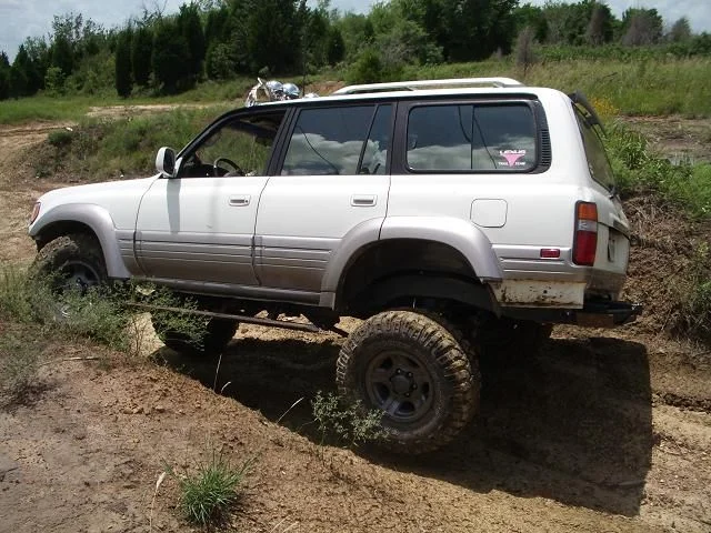

I took her out to a place not far from the house to flex it, and was reminded that I haven't lowered my rear swaybar yet. In these pictures it's about ready to rip out the swaybar bushings, and the swaybar has contacted the shock body. Definately will have to fix that before taking it off-road for real. It's keeping me from using the whole travel of the shock.

Photo 1 - Finished Passenger side front tower.

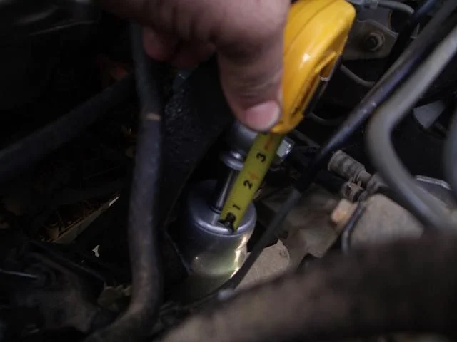

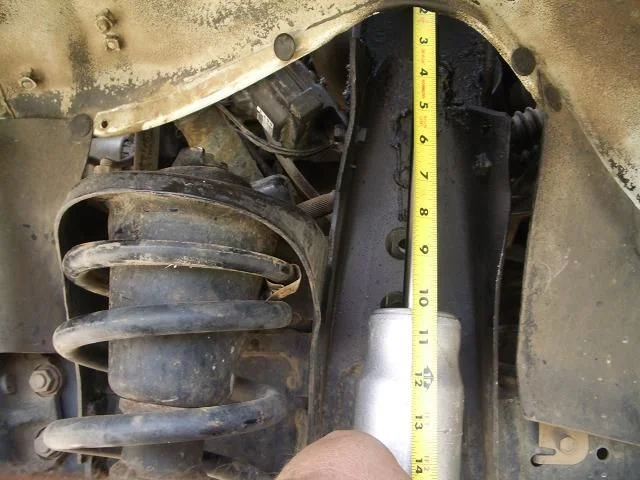

Photo 2 - Extended measure - you can see the spring unseating slightly, tire is just slightly off ground, still 4" of extension left!
Photo 3 - Still have 2" of compression left with the spring out, sitting on bumpstop.

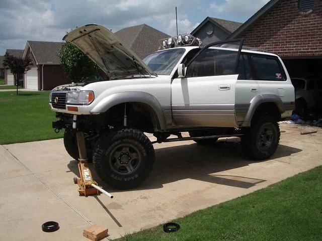

Photo 1 - Front end jacked up (real stable wood method) for extened measurement - adding spacers should be easy now, no need to disconnect anything to pull springs!

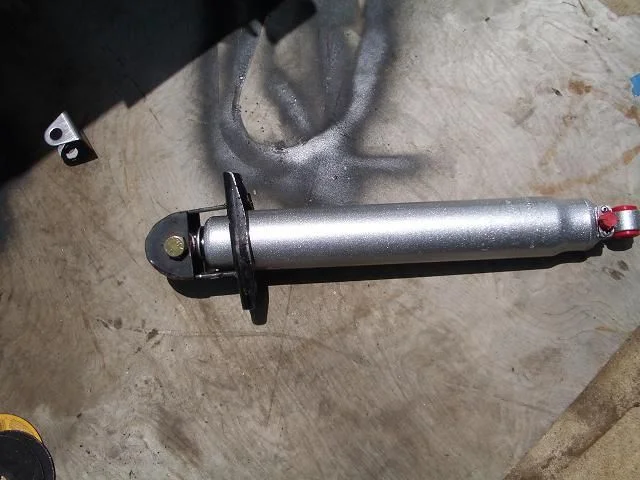

Photo 2 - Rear mount on the shock
Photo 3 - Close up of rear mount. Really tough to get enough clearance for those 2.75" bodies!

Couple of shots of the rear mounts mounted - thougher than I thought. Not only did I have to clearance the mount, but the frame area it bolts to. Another place a plasma cutter would have been golden. Second one took less time than 1st, as on the first I was trying to cut as little as possible and get the clearance, but the second I knew how far I had to go to begin with. There are two layers of steel there!

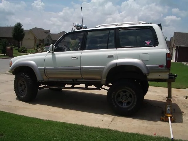

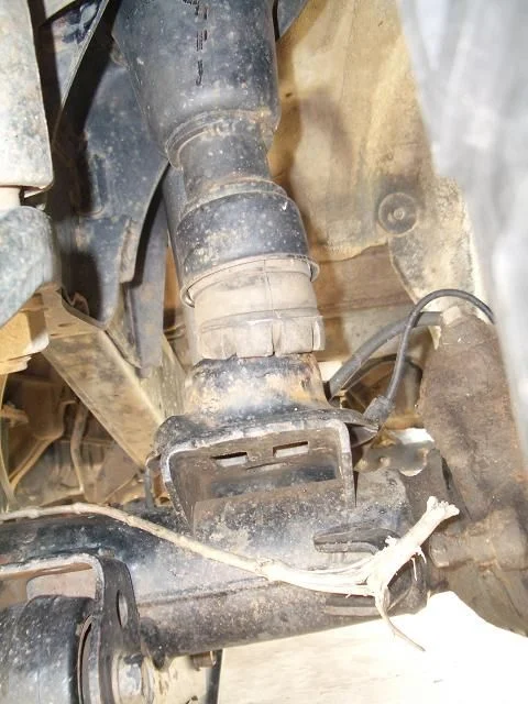

And a shot of the back jacked up so I could get easier acess to bump stops.

Another bumpstop acess pic - forgot to measure the shock extension in this condition.
The dirt pics, the driver's side can't come down any further cause of the sway bar hitting, I'll fix that tomorrow - too beat today to do more than clean up.

8" of front end shock travel - whoo hoo!
Sorta puts things in perspective doesn't it? 2" bumpstop, which is what pretty much everyone is running who has a 'kit' with L shocks, and only 6" from there until the spring unseats with J's. Need a good progressive coil with a really long free length ;) I'm guessing this is about the same as anyone else would see on J's? Unless mine have sagged (they were used when I bought them). Would be interested in measurements from other trucks. Just lifting one side of the frame though isn't exactly pushing it to the limit either though. Wonder how far other springs go from ride height until they unseat - 4", 5 and 6" comp coils, FOR coils, ect.
