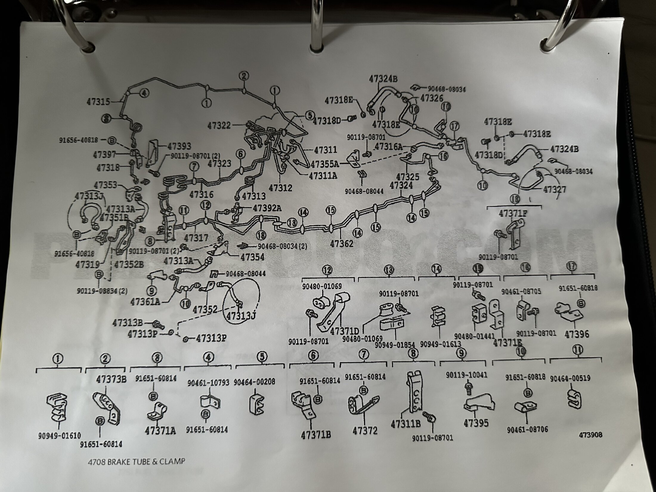

does anyone know where the extended brake lines go in any of these diagrams? like can i just put the part number in one of these diagrams so i know where it goes or is there a thread on here that has done this?
they don't correspond to an actual 80 series AFAIK so even looking them up in the fiche means i need the list that shows which standard length one it is replacing of that makes sense.
THANKS

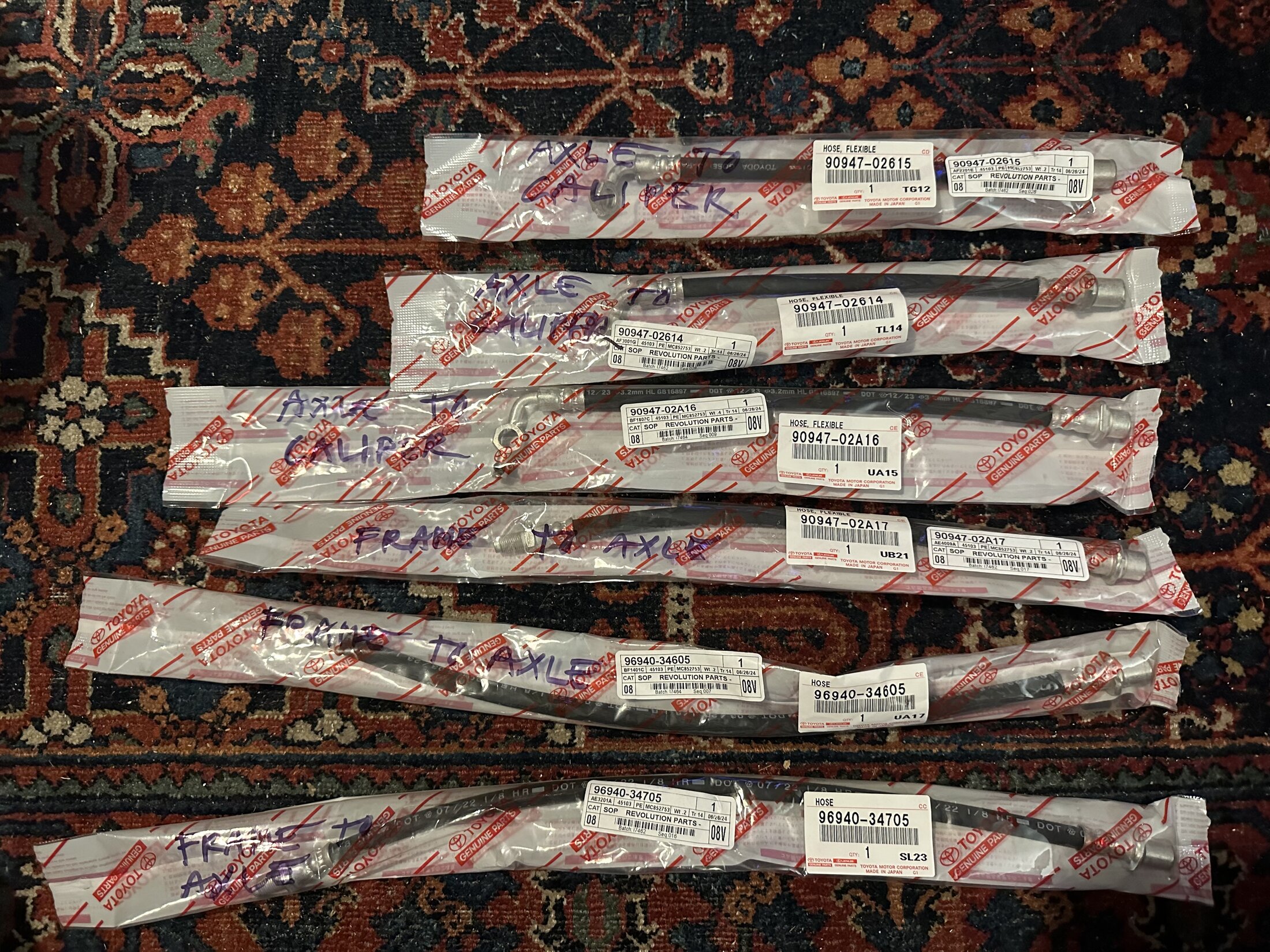

hey man. hmmm. looks like i only have seven and i need eight.
also i found this in my notes. it's all kind of new to me so i guess i need to try to sort it out tomorrow.
can i ask if you see anything that looks right or looks wrong?(!)
3 frame to axle extended brake lines:
- 96940-34605 x1 for the Left (Driver) Front
- 90947-A2016 x1 for the Right (Passenger) Front
- 96940-34705 x1 for the rear
4 axle to caliper brake lines:
- Front: 90947-02A16 x2
- Rears Right: 90947-02614 x1
- Rears Left: 90947-02615 x1"
thanks for the help here.
so i labeled them with the notes i found.
i guess the "axle housing to brake caliper lines stay the same length. this is:
> and i am missing the second front one so i need to order it.
then for the truck frame to the axle lines these are the extended ones. these are:
> i have 90947-02A17 instead of 90947-A2016 that is written in my list so not sure if that is an issue or what the length is on the 02A17 one...

thanks. yeah. i think mudgudgeon and robnicko got me sorted.
i didn't realize the lines from the calipers to the axle were the same length i'm gathering.
i posted pics above with the locations for the longer ones and the stock ones on the parts so it's easy for someone to see. also the list in case anyone is buying some and it's not in the FAQ.
