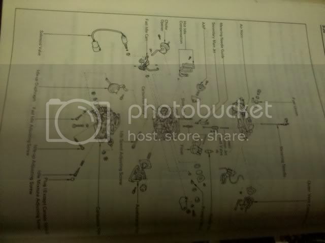

howdy I need an exploded view of an 82 California carb on a 22r
any threads or web sight thanks!!
thanks good luck :)

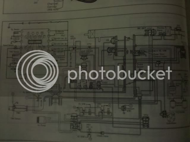

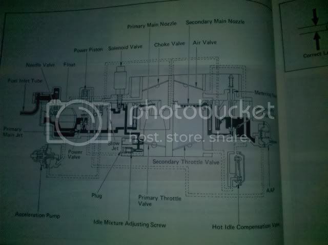

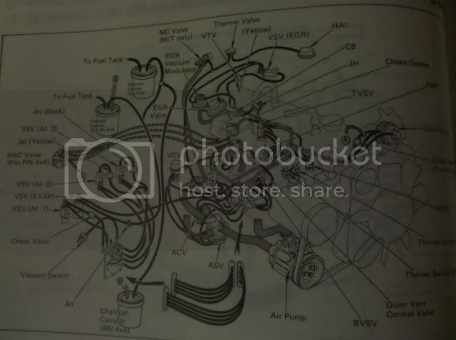

here is what i came up with straight out of the 82 FSM:

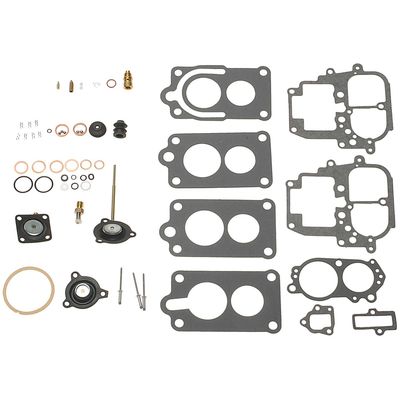

thanks!!! now where can I get a good rebuild kit???
very close if thats not it where can I get the rebuild kit???
