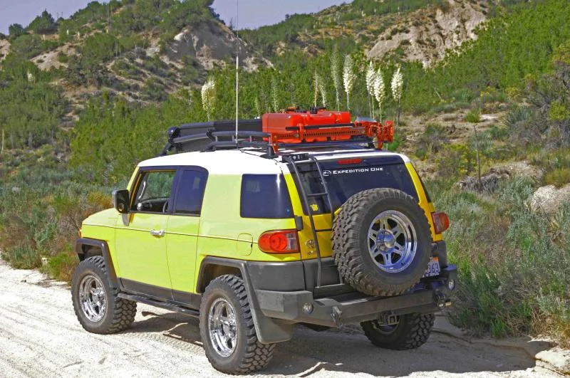

Finally here and it works great. Spent the day at Hungry Valley and did some recovery practice plus general off roading. No clearence issues, good anchor points and the lights at night are a big help ! Fit and finish very good and it was worth the wait.
what was the cost? It looks awesome
Shipping weight was about 80 pounds and that was with lots of packing, so I would say 70 in final form. It has great mounting system and requires to cut the plastic siding some. The orginal rear on the FJ is just plastic and styraform !! So, after seeing that, we feel much better. It took about 2 hours to install. I ordered lights and that took another hour to route cables, relays etc.
I was a, or the prototype for their production run, so I am not exact on price. I think you will see between $700 and $800. If you want lights included, then it will be more. I think it is the best way to really prepare your FJ for the trail when it comes to rear bumpers. I tore up the stock rear on several trail trips dropping into washes and tight gullies. In recovery, you have several attach points for complex rigging. I use their front and sliders too.

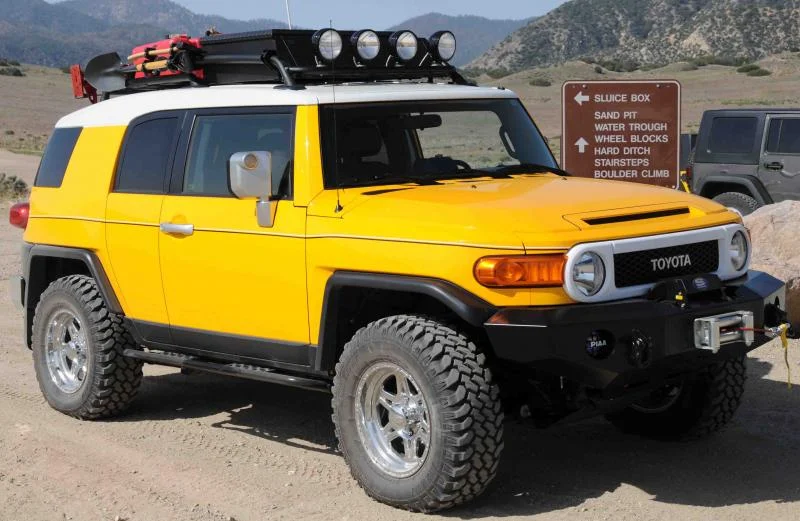

A couple more that show front and rear.
Damn-I may just have to back into something this weekend! "Hey honey-good news and bad...I killed that pine tree that blocks our view of the river...but I need a new bumper"!!
Yes the rear bumper has been a year in coming so to have most key point armored, is a good thing. We did the front bumper, then sliders that are super strong, put the armor under the vehicle on the engine, trans and tranfer case, then went to the protection onthe trailing arms and rear differential. So if we can keep it wheels down, we should be alright :) Thanks for the compliment, we are happy with the way things have turned out so far !

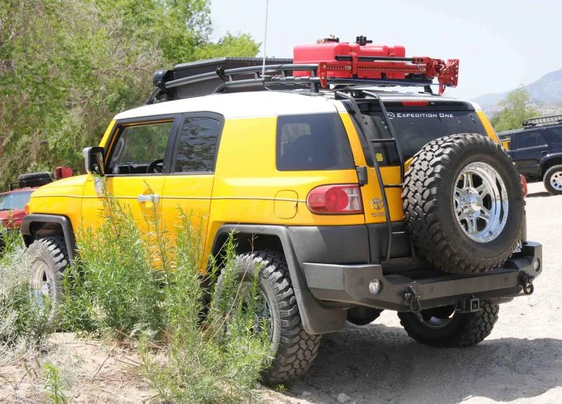

To answer some of your questions: the box on the top rack is a Tuffy FJ security box. We like to store more on top than in the vehicle. Used more for camp stove, lantern so it not banging around. At night, we put or food stuff so the animals don't get into it.
The tires are ProComp 33x 12.5R17Lt on Ridgeline 17x 9 rims with standard spacing.
Expedition One has brush guard options, we just choose the cleaner look. Roof rack is stock and has shovel / ax mount, highlift jack, Tuffy box and low profile boat gas tank that we havea hose and bulb pump so you can fill with out lugging a gas can around.

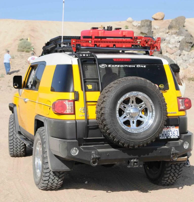

Attached a few final pictures so you can see it overall.

My wife Linda and I did all the mods ourselves. The CB radion is the small unit Radio Shack sells and it fits in the box in the rear of the shifter console. Quick access and you still have room for water bottles. We made a custom Antenna mount that attaches to the roof rack rib.
The ax and shovel are secured by Fourtrek billet mount with Quick Fist. We also use Quick Fist ($10) for Mag Light mounts inside. The High lift jack is secured by drilling the stock roof rack and installing a stainless sleve and stainless nuts and bolts. All low cost mods.
The Marine fuel tank is secured with two ratchet straps. We remove when we carry our kayak. We use a 6 foot hose to attach to the valve when we fill the FJ or another vehicle. To fill the tank we just open rear door when we fill the FJ, step up on rear bumper and fill top tank.
