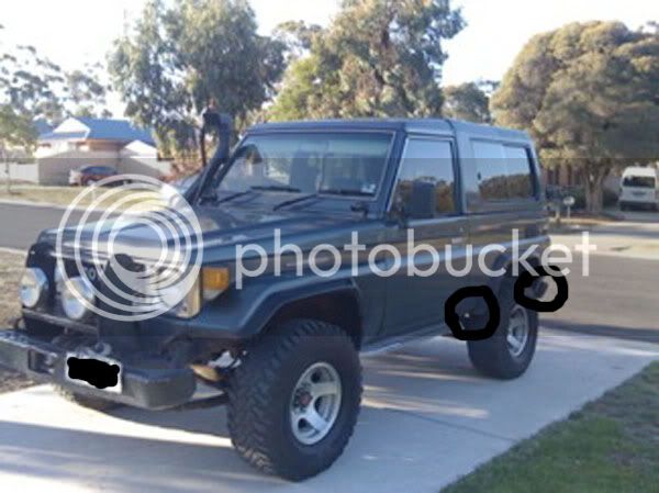

I have a plan: My plan is to mount a roof rack - The ExoRack
The BJ74 has an frp top which isn't built for carrying heavy loads on the gutters. My plan is to built an ExoRack to carry a
roof top tent and spare tyre. The gutters on the frp are not going to be up to the task when off road. Here are some pics so
you know what I'm getting at.
The rig and where I want to tie the ExoRack to the chassis.

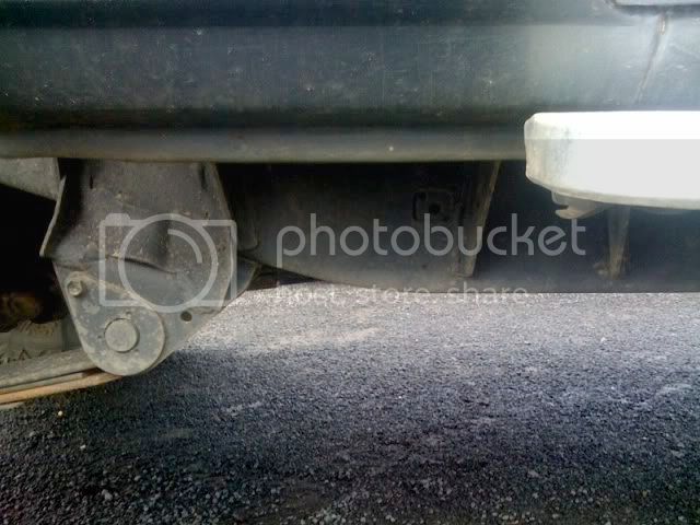

Close up of tie points:
Front, between spring perch and body mount.
Rear mount, bolt to the chassis with the rear bar mounts.
Just behind the body mount.
Here is an impression of the finished product. Sorry not to good with photoshop
