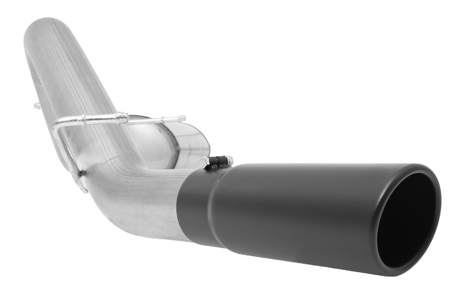

I was thinking magnaflow for cat back 2003-2022 Toyota 4Runner Performance Exhaust System | MagnaFlow - https://www.magnaflow.com/products/19546-magnaflow-2003-2024-toyota-4runner-overland-series-cat-back-performance-exhaust-system
but had difficulty finding headers for a reasonable price.
Edit:
I'd like to add that I did go with the magnaflows. I'm so satisfied I came back to say I'd recommend going with them. Install took me like 20 minutes. Now I just need to find someone to tack weld it as a preventative measure so the clamps don't come off.
