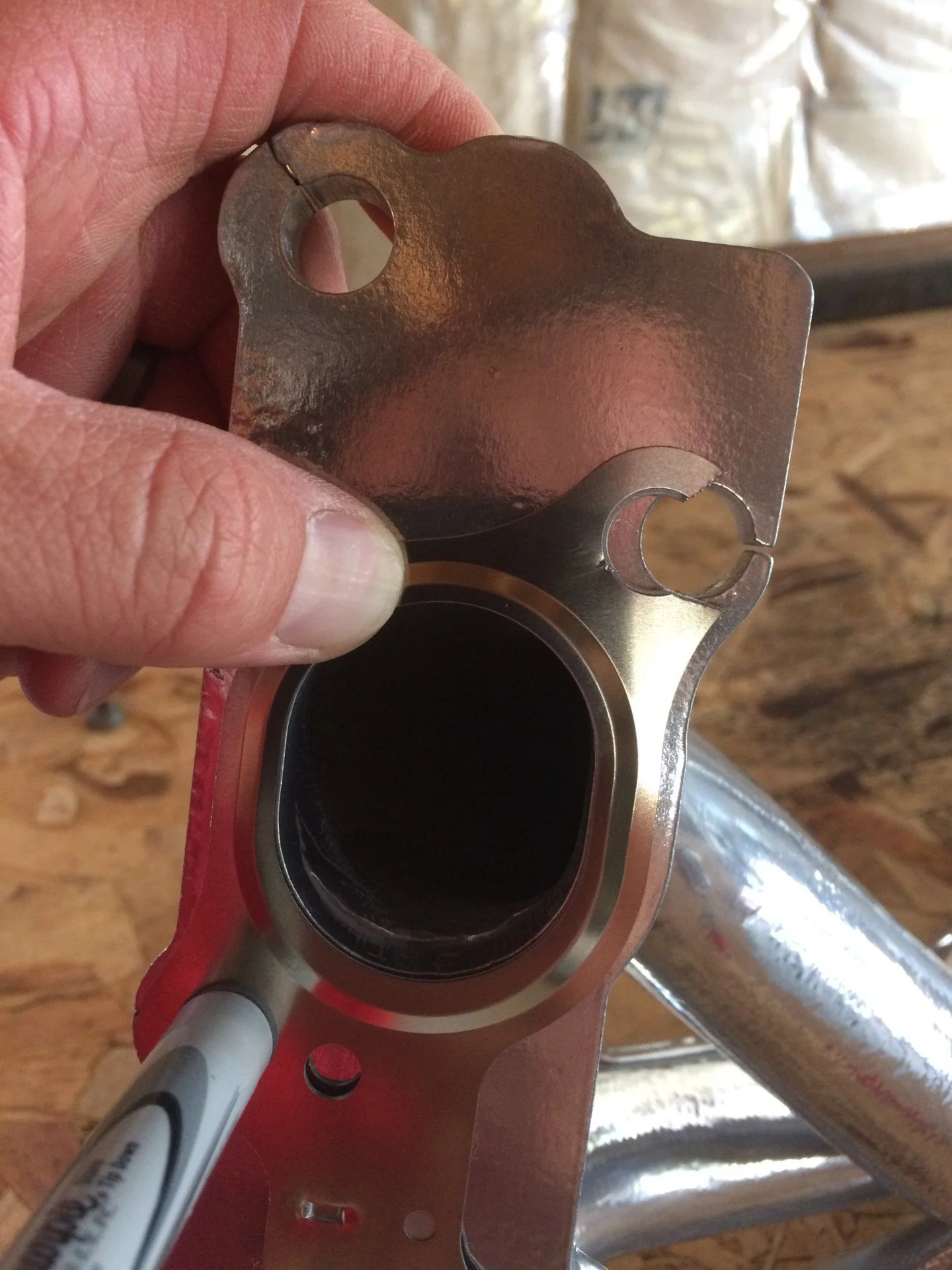

i did see that the front was almost the same as the rear but I wasn't looking to cut up the gasket. I looked into making one which would be easy from gasket sheet but wanted something that would last. and since the coating is done now its too late to go back an d fill the egr.
Well, here’s the only slight difference in gaskets
Just tin-snipped that small section out and bolted them up.
