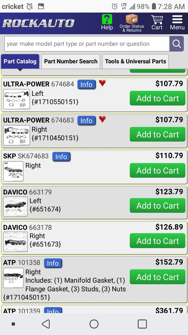

Has anyone had luck with the rockauto brand replacement manifolds?

I don't see it on rockauto any longer, but I put a dorman on my 2000. It lasted about 3 years until the tick started. I changed it again about 5 years back to JBA shorty's and have not had another problem. I'd consider doing the same unless you plan on getting rid it in the not too distant future. Note too, I bought a OEM gasket and new studs when I replaced it.

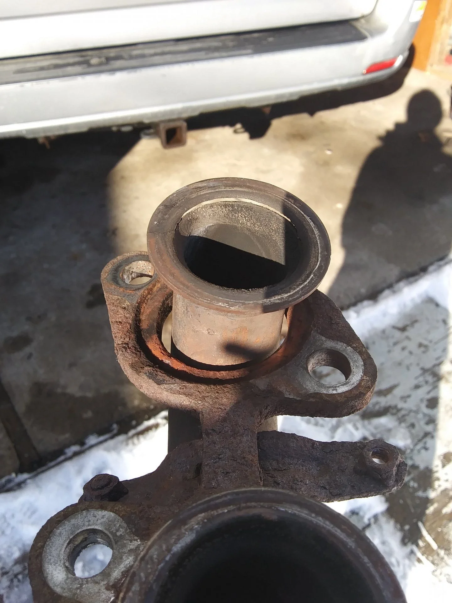

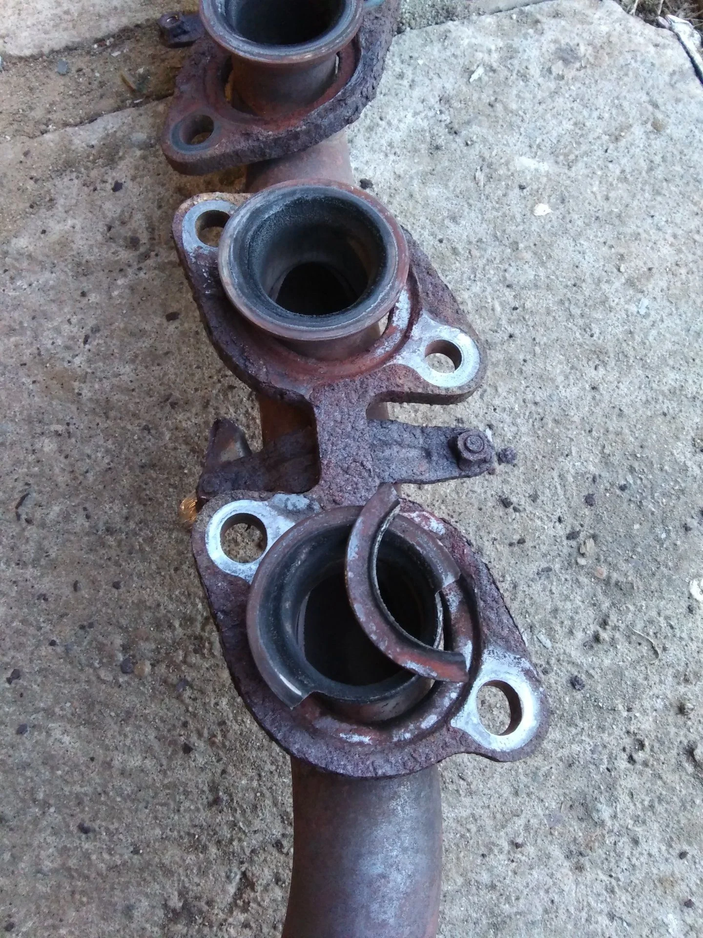

Pulled the passenger side manifold today. Was surprised to find the flange at the rear collector cracked off.
