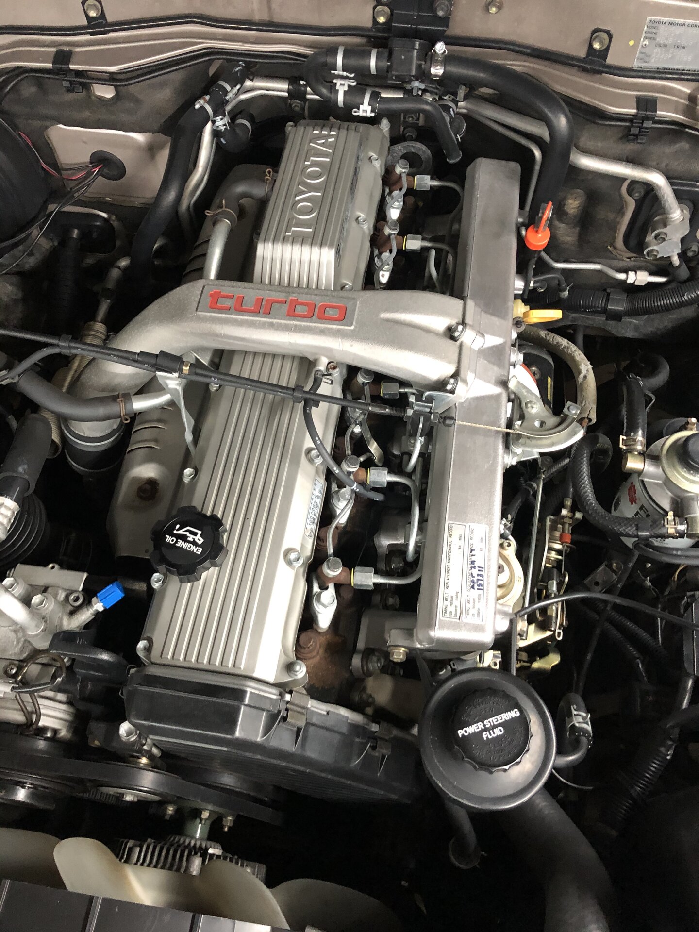

I have a 1993 Toyota Land Cruiser 4.2 L diesel 1HTD The blow by is getting so bad I cannot drive it . smoke 💨 everywhere what’s my best options any help would be greatly appreciated Canadian

221879km clear hose installed Mann Chetch can but it can’t keep up with oil vapour so road draft tube installed now but it’s just blowing excessive crankcase gases, exhaust smells of oil.. my thoughts are on re-ringing the engine correct the over fuelling injection pump power Rod modification.due to sluggish performance other than all the smoke, it runs great.. No Compression test or leak down performed at this time.. i’ve been backing off the load screw so only black smoke when wide-open throttle..
Is your provent concerned with gov't surveillance? That is one very fresh and clean IP, and well, everything but the injectors and intake look really new. Or is it just repainted well? I'd have to guess the only good way to know is a compression test. I also have blow by and had blown up 3 compression gauges trying to see if it was rings so then I was all like probably good compression.
1st thing to do is a compression and leak down test. Confirm or eliminate peak down/ blow by is a problem.
Replacing rings is thousands in parts and labour, compression testing is a couple of hundred tops if you pay for it, or have to buy a tester
2nd take the hose off the catch can, dump it into an open coke bottle, see if it stops the blow by, and if it's catching oil. A restricted PCV can cause surprisingly high oil consumption and smoke.
Several members have exclusive this (search the diesel tech section)
3rd, excessive fuel shouldn't equal sluggish.
You have another problem. Injection timing, pump tuning, waste gate problem?
4th, adjusting the main fuel screw is not the best option to adjust fueling and tuning issues. It's using a sledgehammer to swat a fly most.
Are you running EGT and boost gauges?
If so, what peak boost, and what peak EGTs are you seeing?
Throw the Mann/Provent catch can in the bin and either don't run one, or use a flashlube/ryco/PDI catch can.
The Provent design makes no sense IMHO, it has the 'clean' air being pulled from the can below the inlet. Surely it would make sense to use gravity to advantage like the other brands do. I wouldn't reccomend them, have seen examples where they're feeding oil back into the engine rather than separating it.
Given your 1HD-T doesn't have an EGR system, there is no issue with a build-up in the intake which a catch-can is supposed to prevent. The issue is the soot from the EGR combining with the blow-by vapours. If there's no soot, there's no issue.
