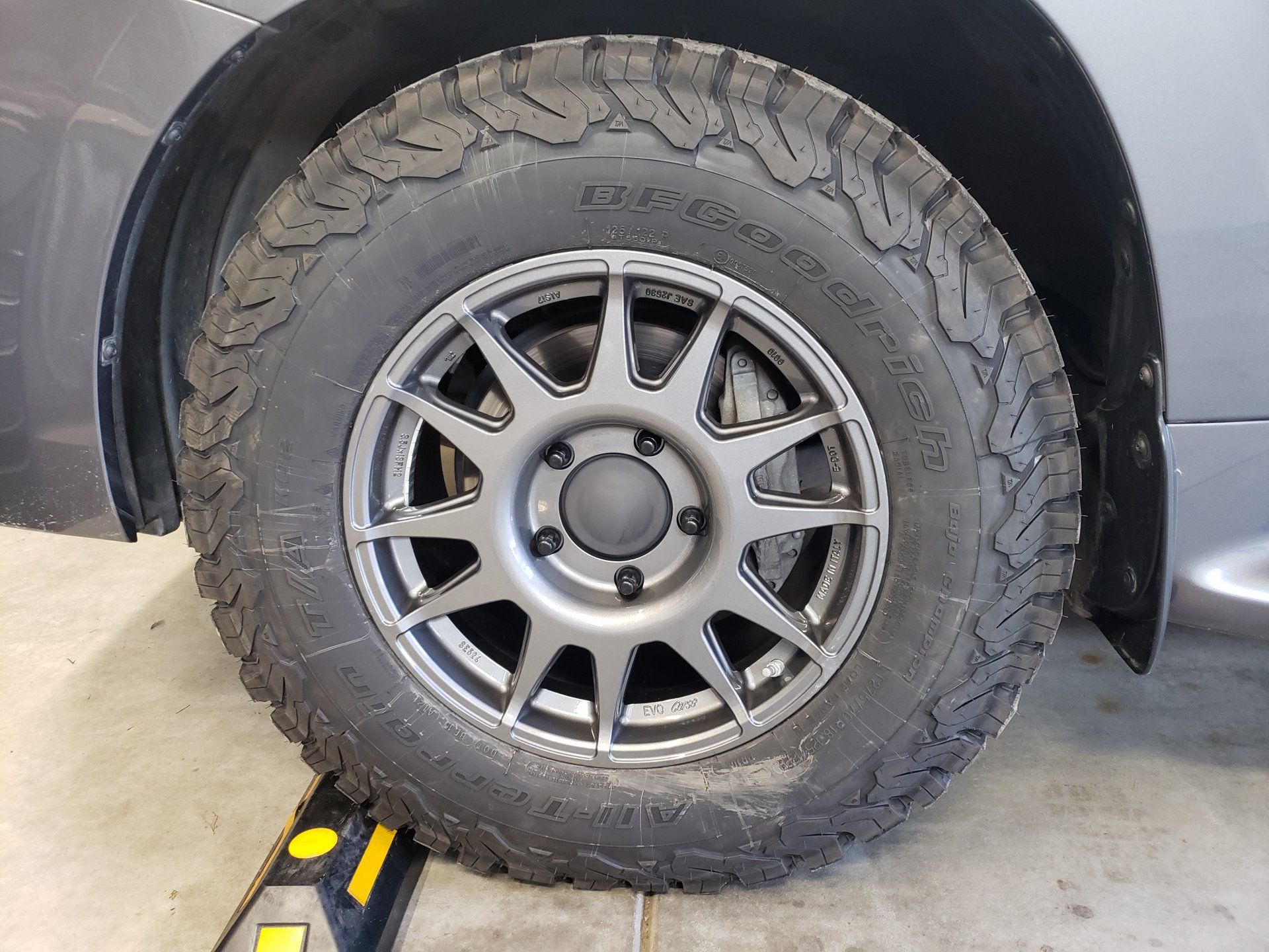

I really like these EvoCorse wheels, but it has always bothered me a little that there are no center caps in any of the pictures I've seen.
Are there center caps available for these wheels?
TIA
No, seems largest center cap they make is 70mm, which is definitely too small. Additionally the center bore area is smooth so I don't think there's any place for a center cap to properly seat.
Thanks. That's what I was afraid of.
I was worried about the look of no center caps too, but I have to tell you I think the look fine in person without them. I might eventually paint the hubs to clean them up a little but I’m not stressing over it.

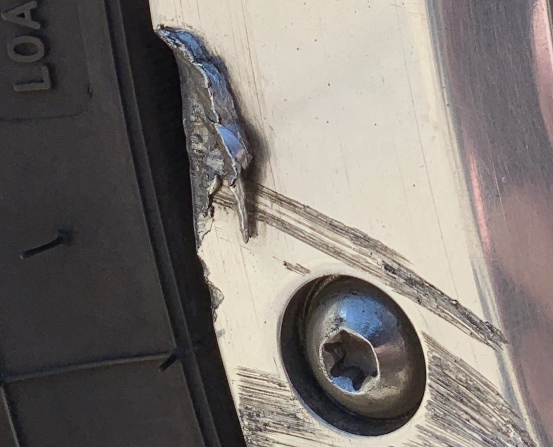

Just scrape them up on a trail, and the hole in the middle becomes the prettiest part of the “circle.” :hillbilly:
:hillbilly:-<“You can’t scratch a void!”
My RW “beauty rings” work in reverse...
-They are so beat up, they make THE REST of the wheel look comparatively byooteeful:

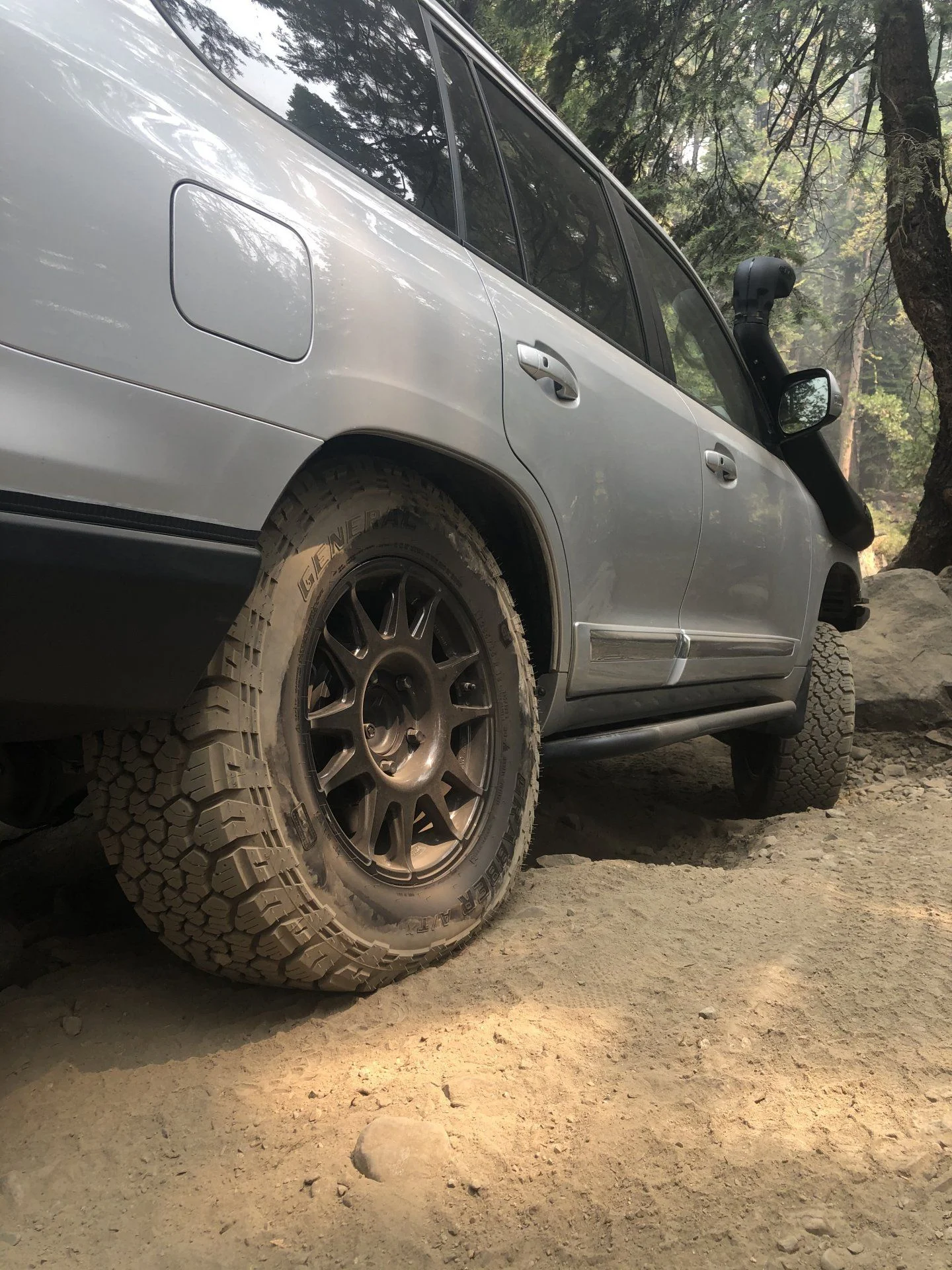

18 inch Evo Corse with custom offset on 305/65/18 BFGs
You can't say custom offset and then not spill the deets! What is it and has it eliminated all KDSS rub? I wish our studs were longer from the factory as I don't want to jump to a .75" spacer, aka ~21mm ET (I'm talking 17s).
I had to go back and look and i did a +10 offset. The 18s are 8.5 wide and the 17s I believe are 8 inches wide. I don’t like running spacers and at +10 the tires sit almost flush with the fenders. I will be going down to a 285/70/18 next so the 305s do poke a tad. But with my current setup there is no rub lock to lock once I heated the liner and pushed it forward.
Yup, you're correct on the width difference. Good intel for folks, thanks!

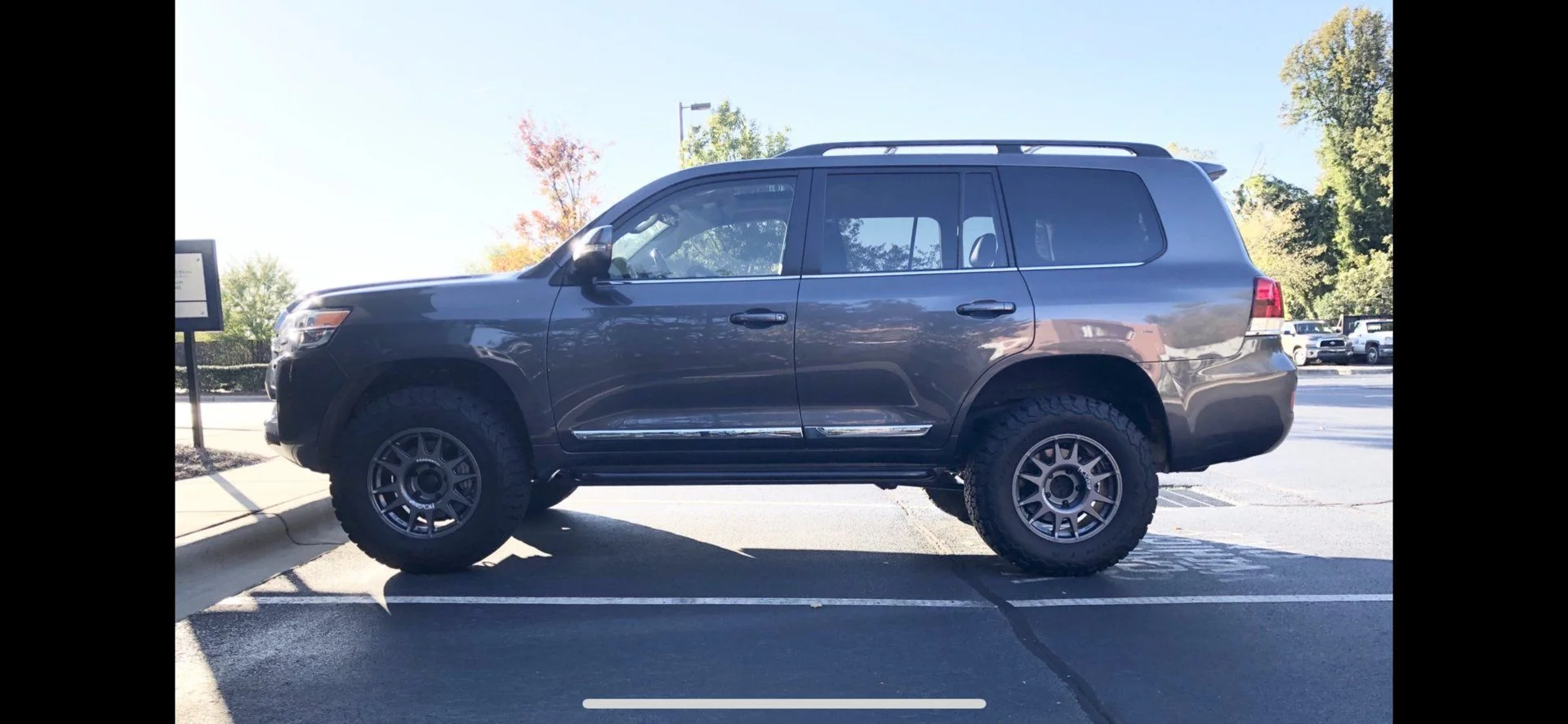

Don't have good pics atm, just these during a garage remodel. Truck hit a deer on way to recent Ouray/Silverton/Tride family trip, autobody for front bumper repair. Glad Slee is booked out thru Oct or I'd do something completely unnecessary.
Pics do zero justice. Absolutely love the setup w BFG KO2 275/70 R18 (33.2") on 18" Dakarzero Anthracite. Sourced from Mainline Overland. No liner/mudflap work done. Look and stance in person is excellent. Really like the extra design on 18" lip vs flat lip on the 17. I've gotten numerous positive remarks from strangers. Had bores painted w flat black high heat rustoleum. See others use high sheen black, but that has tendency to draw your eye to bore. Flat it all blends in just right with wheel and shade of Ko2 sidewall. I may have custom aluminum center caps made using set screw to secure, but truthfully the current look is $. Slimline II + iKamper Skycamp 2.0 on the roof.

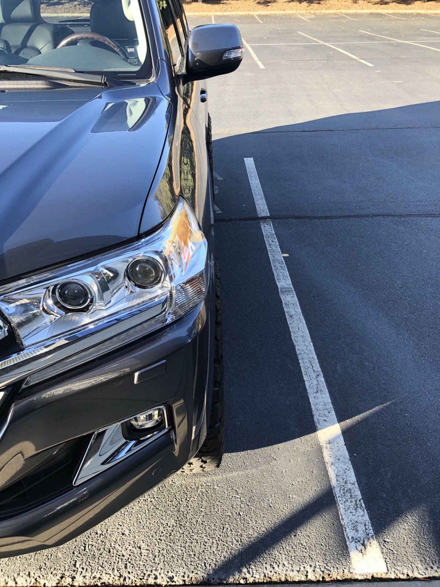

Looks great. Are those the standard 18x8.5 et45?
Additional pics showing how flush they are with the fenders would be appreciated!
Sorry for delay. Didn't see request. Top of BFG rubber is inset about 0.5" from upper fender. It's not flush, but looks good. Don't run into rubbing issues, which comes into play ET30 offset and less w 33-33.5" rubber.

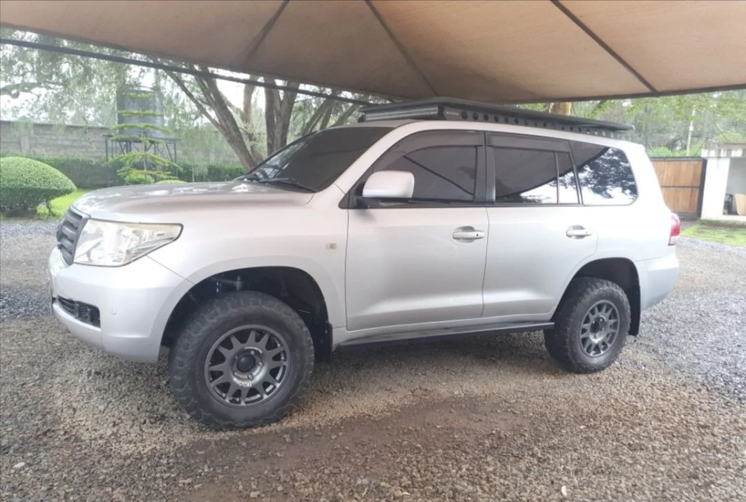

18” with 45mm offset, gloss black with 285/65r18 general grabber ATX, Tough Dog 45mm lift.
