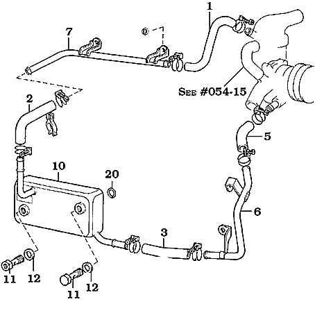

Dont forget - the 3FE and 1FZFE engines both already have oil to coolant heat exchangers (oil coolers) already (on the passenger side of the engines)......
diagram of 3fe

Seems like you can spend a lot to u0pgrade the engine oil cooling system and not accomplish very much...... take steps to reduce radiator temps instead
diagram of 3fe

Rusty:
That is very true, both engines have them. They are located under the exhaust manifold and use coolant as the heat exchanger. Givent the placement and method of 'cooling', I'd almost consider it a oil pre heater, not cooler, but I haven't seen any efficiency numbers off the unit. It certainly can help heat the oil when the radiator overheats tho!
