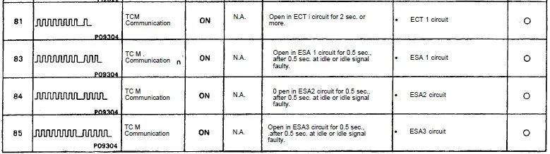

cant find what 84 or 85 means but the transmission is not acting right so I am guessing they may have more to do with the transmission.

'94 FSM says this:

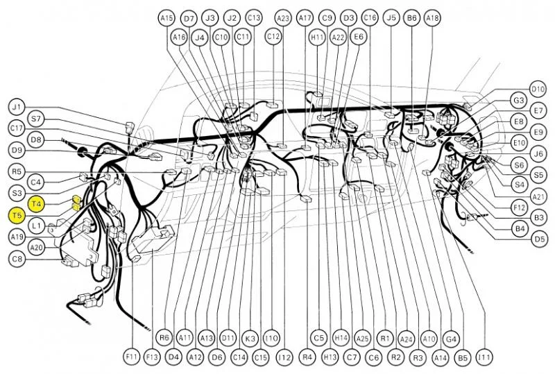

Again from '94 - first check behind the driver's side kick panel:
Ok, so look at the connection below the lower intake manifold that goes back to the tranny, just above the starter. There are a few. Anyhow if any of this has coolant dripping on it from the PHH or the 90 hose above just before the heater valve, it will give you all of these codes, I have even melted this area in the past with a Safty netural switch going bad. The other thing that Dan has posted in the past, is the early 93 computers I believe can give that set of codes with nothing really wrong, except that one needs a new computer. That is if I remember this right. But since you have not posted what year you have, got to guess as many things as one can. But the codes suggest either a 93 or 94(since the 91 and 92 have not electronic tranny and the OBD11 codes are different, 95-97)
