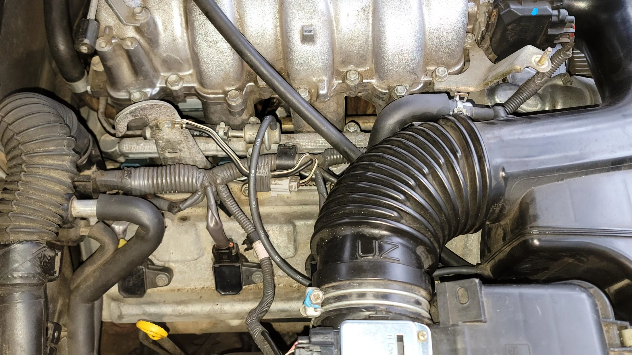

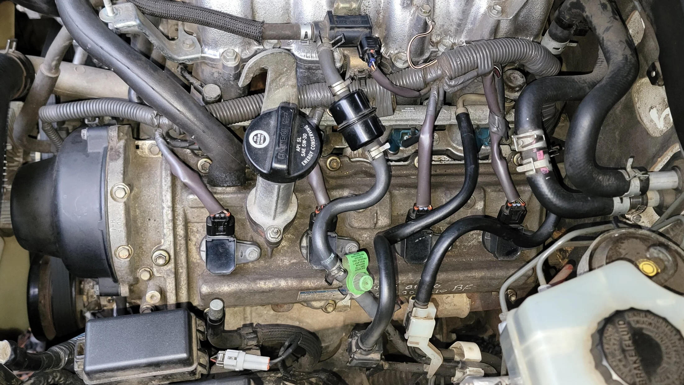

I recently went through the ordeal of replacing my original starter after having worked on a few other things.
My question is, can anyone with a non-VVTI GX470 take a few pictures of the tops of the bolts holding the upper/lower intake manifold assembly (left and right) along with the correct placement of the engine bay plastic cover brackets (the zinc-plated looking ones).
I sort of rushed through re-assembly and feel like I placed a few bolts in different locations even though they were the same length. Specifically talking about those a standard hex head, and those with a torx/hex head.

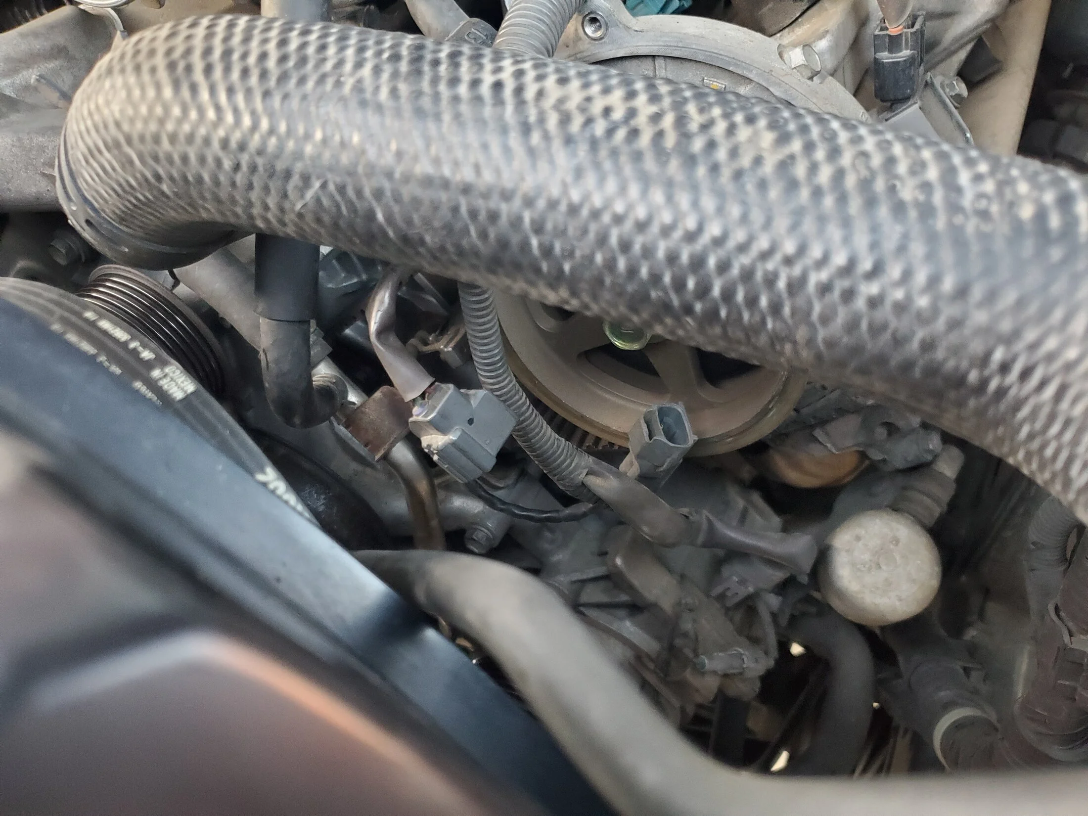

Pictures for attention, from when I replaced the camshaft position sensor followed by replacing the starter and reassembly.
The good news is, it fired right up and drove just fine after replacement. The bad news is I need to go back in and repair the wire/connector for knock sensor #2.
I think I damaged the sensor itself or the connector because I had no P0330 before the starter replacement, but now suddenly have the code afterward so I'm blaming myself and will need to go back in and disassemble everything. Figured I could ensure I get the bolts all in their respective places.

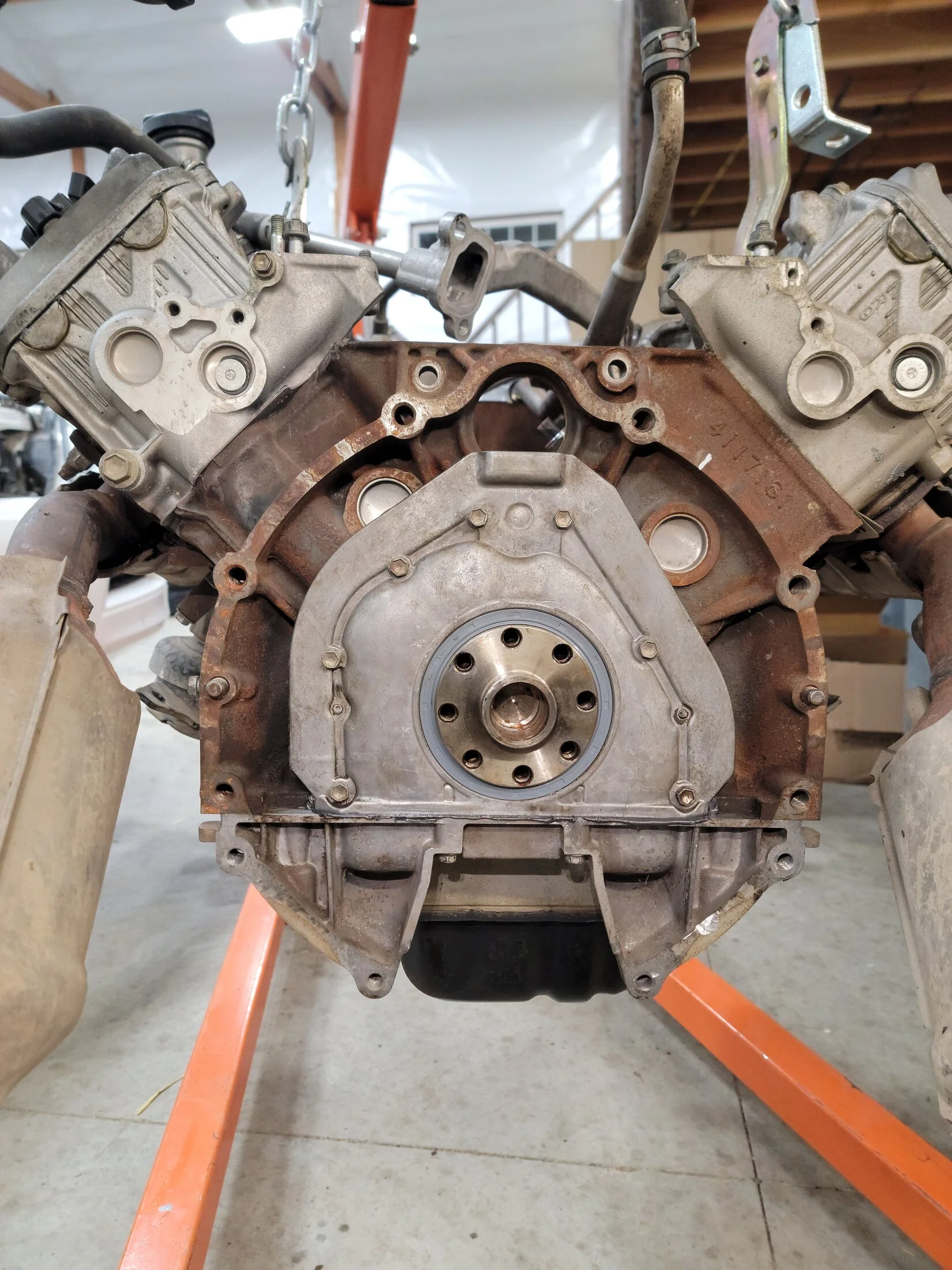

This was my transplant about 6 weeks ago:

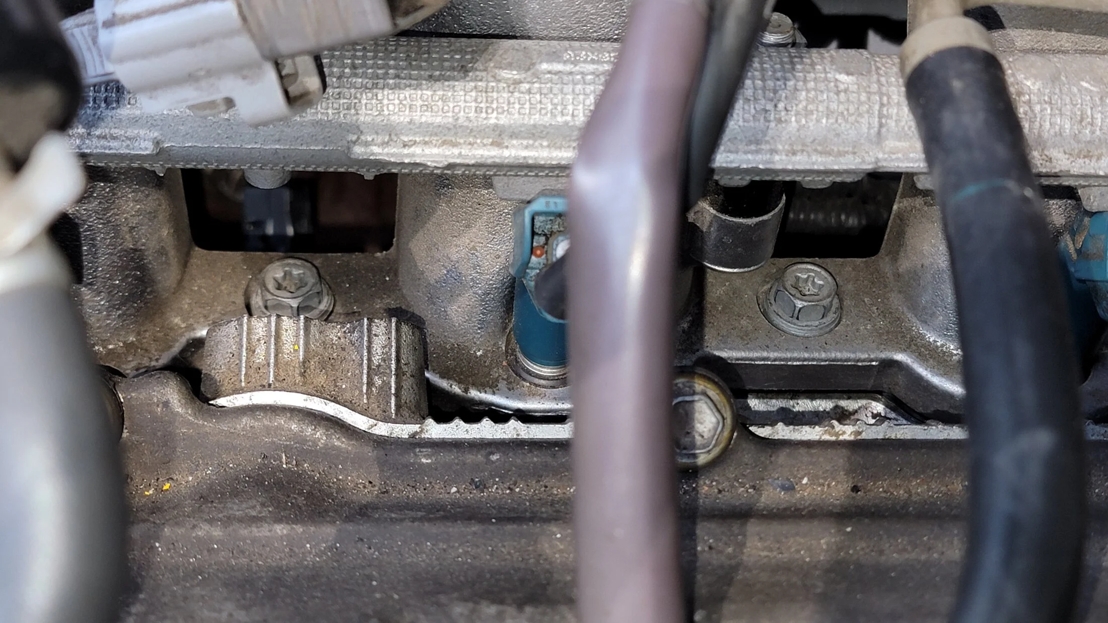

Basically a picture from each side of the engine which would show the tops of the bolts.

Anyway, to your post. I have had the battery cable unplugged for days as I haven't driven my GX for several days until yesterday again. Starts up fine, drives fine, but starts pinging and that's when I get my knock sensor code for bank 2 again. Based on older threads, that would be the knock sensor on the passenger side? I do have a new pigtail as well as a new sensor *just in case*.
Prior to the starter going out though, I've never had any pinging whatsoever and I'm still on the same tank of gas so it can't be bad gas. I believe in my rush to reassemble everything and have a drive-able vehicle I mixed up much of the hardware on the fuel rail and/or intake manifold. I also have no doubt I may have crushed or damage the knock sensor harness while I rested on top of the engine wrestling the starter in/out for replacement.
As for the zinc-plated brackets, the brackets that bolt to the top of the intake manifold and/or side that hold the large plastic engine cover.
