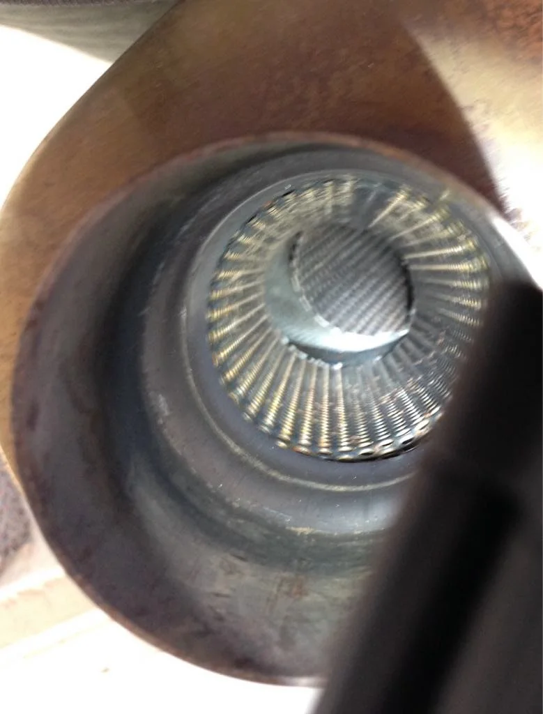

Anyone else have their EMS muffler fall apart from the inside out? Mine has something rattling inside it and it's driving me nuts. Anybody find a dimensionally similar replacement?
I also think I need to weld up the crappy clamps that were provided. They've leaked since day one too.
You mean like this? Put on a MagnaFlow
Yes!
Do you remember which model you went with?
How long did you have it on for before it fell apart? What a shame...
