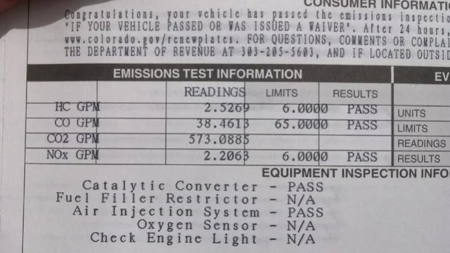

I haven't taken it apart, but it seems to work fairly well, when I bypass vsv 2 it opens the valve and takes it out of bypass. I was trying to determine what the voltage should read to the plugs that connect to the VSV. I think the computer or the wiring is at fault. I've attached my emissions report.
I don't see residual O2 % like the CA tests, but they say AI passed, so you must have some minimum percent which means your AI is working.
Your truck seems to be running fairly clean, so everything must be working, more or less...:D

I'm pretty sure that AI pass is just a visual inspection. Yeah, I passed pretty easily and the truck runs clean! :) Well, I'll give the emissions computer a shot, I've given it a pretty through inspection before. I did put in a computer from another 82 40 that wasn't stuck in bypass and mine still wouldn't switch out. When your residual wouldn't move was the AI injecting properly??
