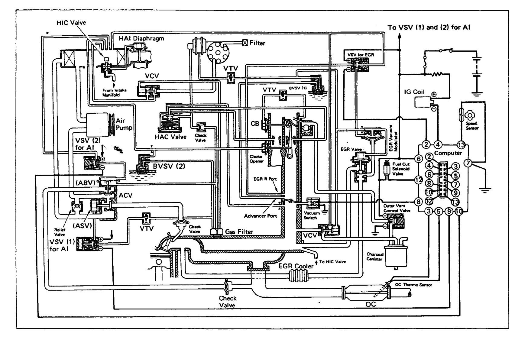

Here's the schematic for the USA 2F. The solid lines are electrical pathways (wires) and the double lines are vacuum passages.
You can see by tracing lines what systems are connected to the emissions computer.
Your emissions setup undoubtedly isn't as complicated as ours.

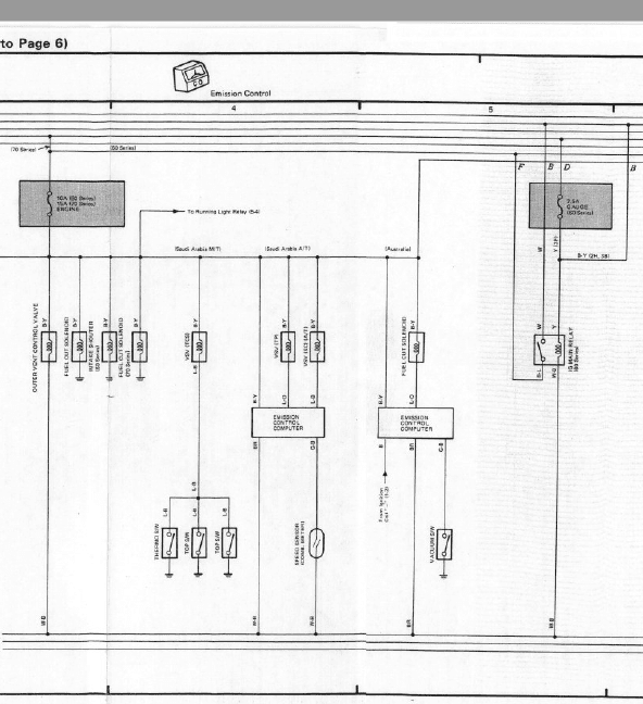

I don't know if there is an emissions manual associated with the 3F. The engine manual I have doesn't really cover emissions. However, there is the wiring diagram from the body and chassis manual. If I'm reading it correctly it shows an emissions "computer" associated with the Saudi Arabia Spec vehicle with A/T and the Australia spec vehicle. For Australia, there are inputs from the vacuum switch and engine speed and the one output seems to be the fuel cut solenoid. From this it looks like all the computer does is control the fuel cut solenoid.
Good luck.
