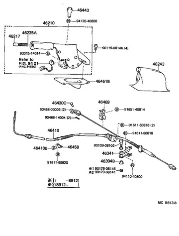

Looking for some pictures of how the parking /emergency brake cable attaches to the rear differential housing. I have a dealer image but the part that connects isn't very clear as its floating in the picture and I have no reference as mine was ripped off so to avoid guessing I'm asking. Here is the photo I have I'm interested in the clip part reference #46469
And how it is oriented.
Not shown in the pic... there is a nylon block which runs on the r/h cable.
The bits you identified clamp around it and it is bolted to a bracket on the rear face of the diff head.
Right in the middle of the hump...
Found a photo on the net....
