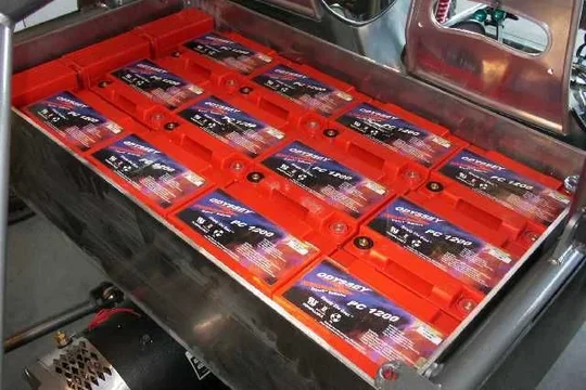

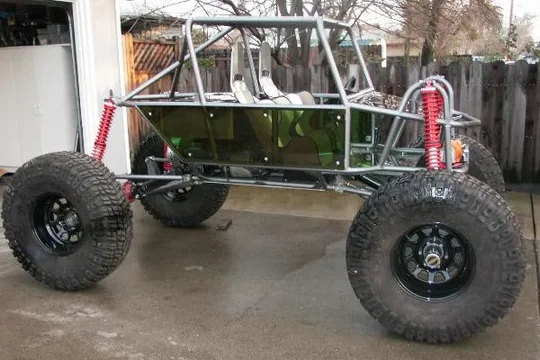

Heres the pics I found that I saved. Damn cool buggy, but I don't know what happened to it. Haven't seen it out anywhere.

I had a completely different configuration idea. looks like the tranfered torque via some sort of case by the pics. I can see the motor behind the seats, or maybe one of the motors??

From what I know about this rig, Tony used 1 eletric motor hooked to an Atlas t-case. Made an adapter to mate them. Said it would run about 4-5 hours before recharging. The "gas pedal" is a reastat setup. The cool part is you can sneek up on the obstacle;) I think it is a great idea and would like to do one myself someday. My only concern would be running out of juice on the trail. How would you charge the thing in the middle of nowhere? Guess you would have to tote a generator around in your tow rig. I,ve looked at a lot of electric car conversion websites. Lots of good info on them. What about a generator on the rig to keep it charged like a hybrid?:idea:
