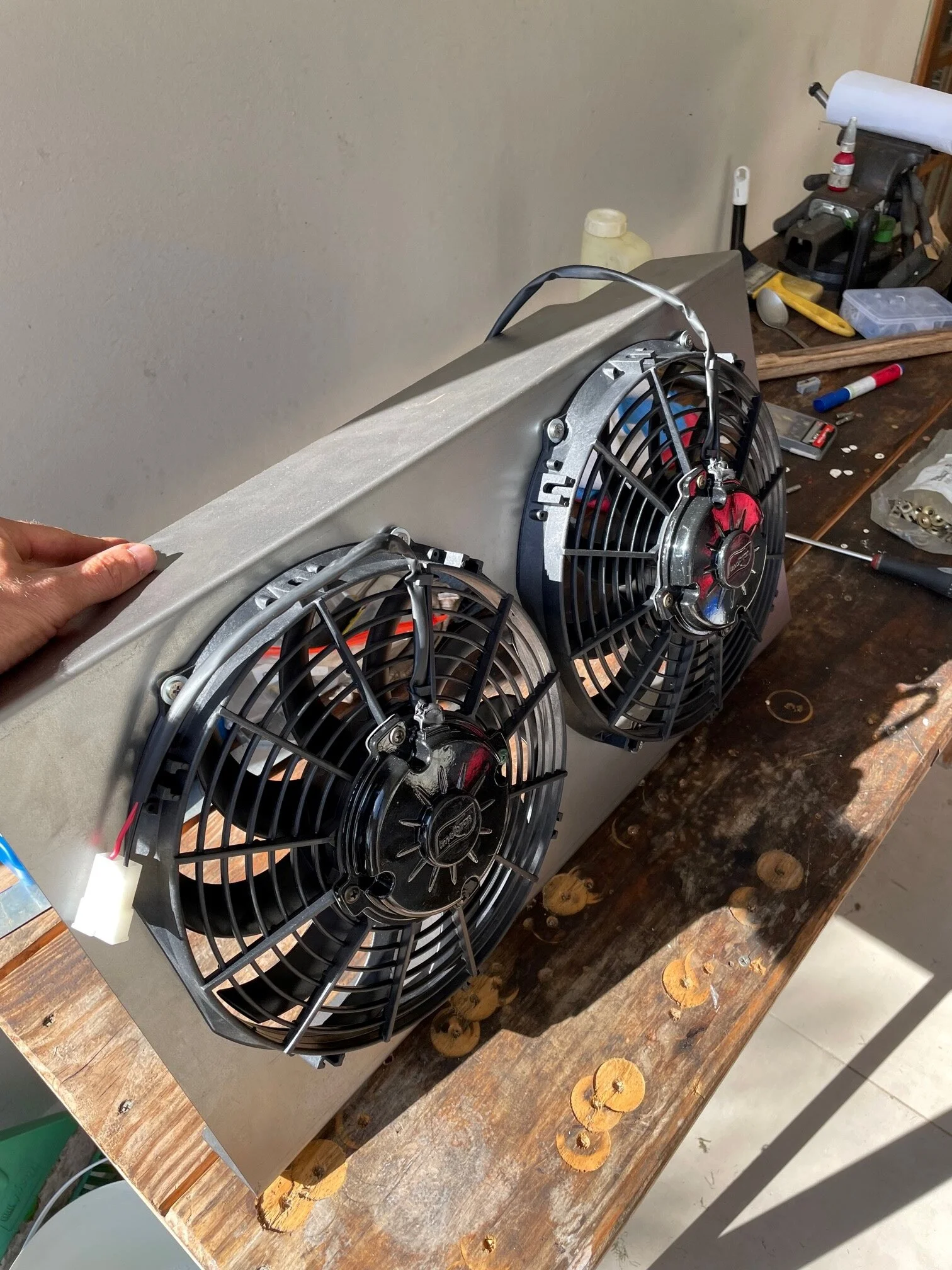

I have a 4LTR Diesel engine with only est. 100-105hp and converted from a fixed fan to 2 smaller electro-fans (120W each, cheaper ones, not the expensive brushless ones). During normal conditions, like going slow in the city (low load on the engine) and cruising on the highway at around 50-55mph it works more or less well.

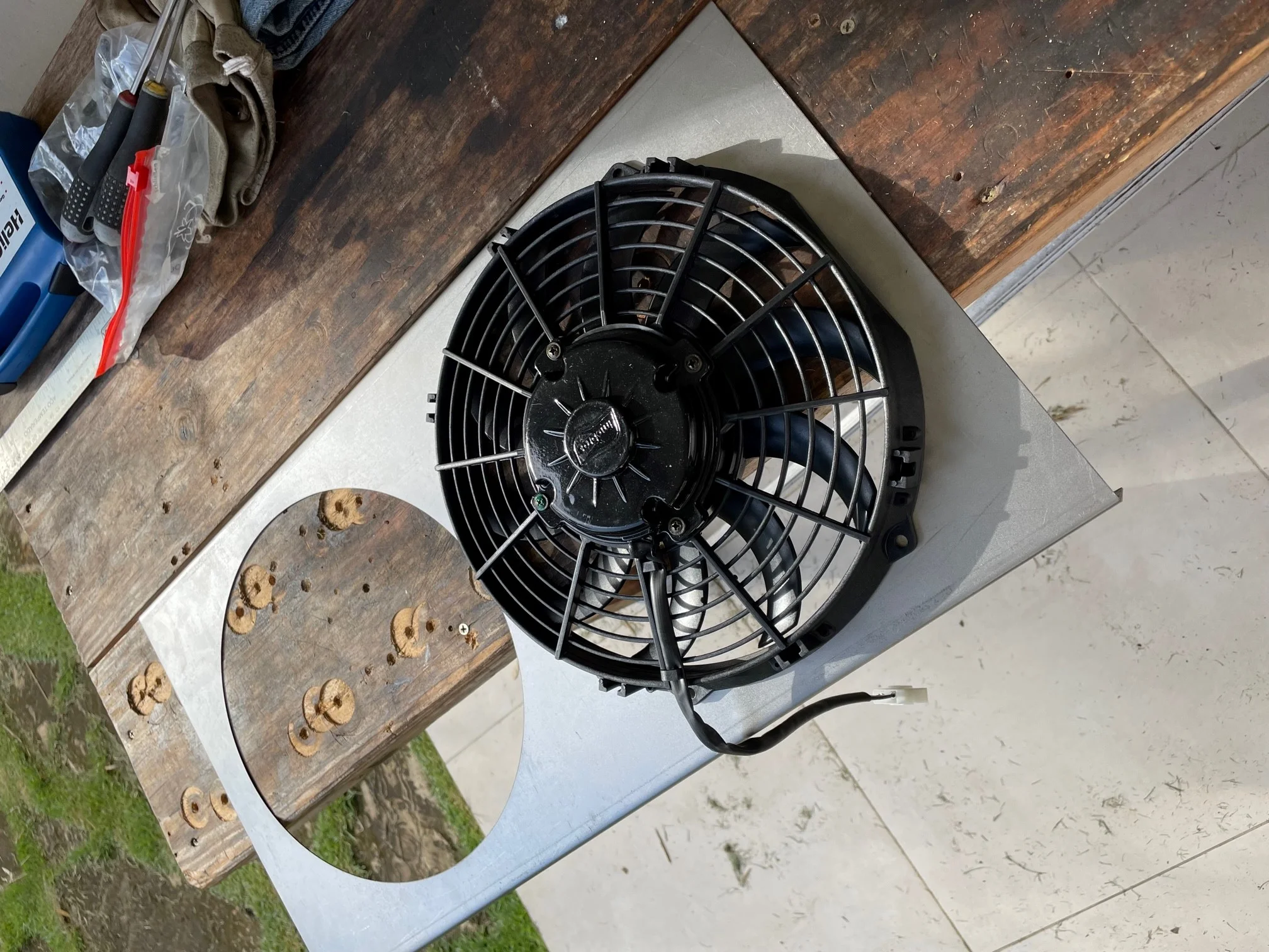

If you mount 2 small electric fans directly to the face of the radiator core, you are only flowing air thru the core directly below the fan. With an old style brass serpentine fin radiator, you would not get enough heat transfer. If you build a shroud and mount the fans to the shroud, you are flowing air through more of the radiator core. Increasing the spacing between the fan and the core gives you more swept area increasing heat transfer. Spacing of a single large electric fan would be limited by the water pump pulley.
I installed it with a kind of shroud and made sure that the sides are closed.
Those are 10" fans and are rated at 13V / 9.5A. At 14V those are taking around 10A which would be around 140W each and 280W for the pair.
As per datasheet, they should provide something like 900cfm each.

Thank you for your response. Those are some great pictures and lots of information. Appreciated!
