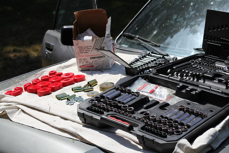

I did a few things like a ZUK mod, replaced my body mount bushings, and got her muddy as often as I could.

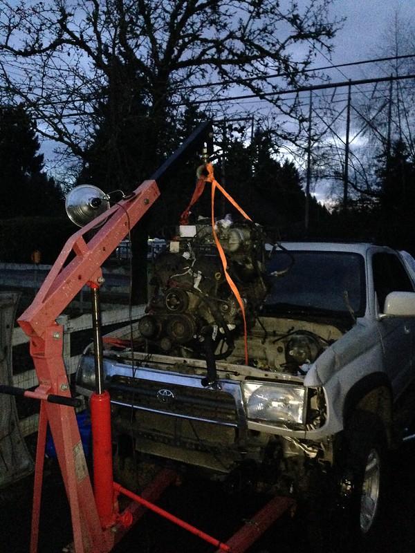

Eventually I hunted for a donor vehicle and did a 3.4 to learn the ins and outs of my 4Runner.

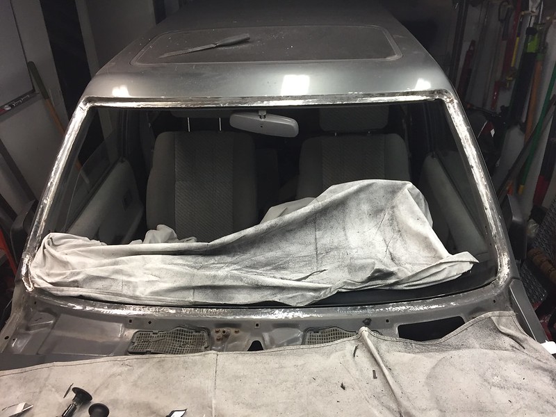

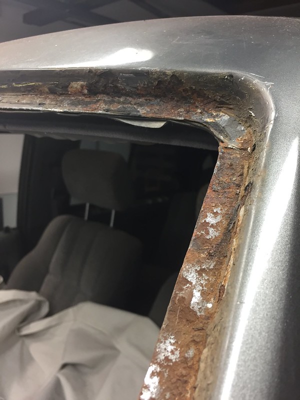

Fixed my leaky windshield that was soaking my ECU

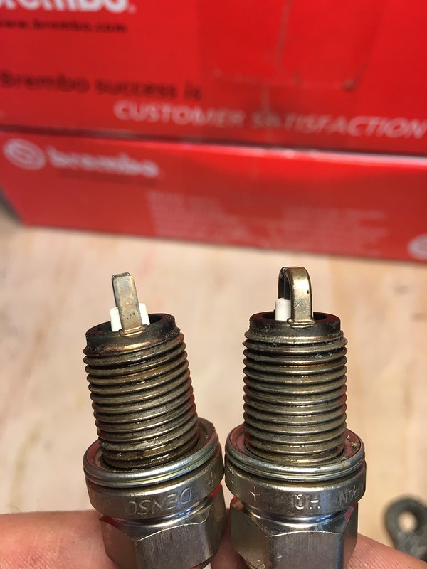

Which brings my build about up to current. A couple weeks ago I was headed to Crystal for a powder day when it started to misfire and threw 2 codes for the MAF and IAT sensor. I'm also losing coolant. I pulled my plugs to find I have low compression in cylinder 2 and what appears to be coolant in the cylinder with the misfire code (4) as shown by my spark plug comparison. Or does this look like it's running lean and I have an injector issue?

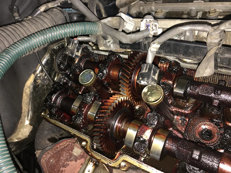

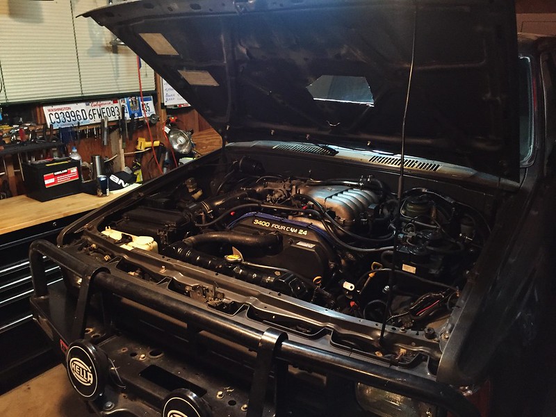

Ran my leak down test and found the cylinder with low compression was leaking out the intake valve. I pulled off my intake and popped off my valve covers to have a look. Unfortunately what I found was not promising. It looks like the PO neglected with engine and went too far between oil changes.
I've gone back and forth between a rebuild, a JDM engine swap, or trying to revive this 3.4 without a compete tear down. With a valve cover gasket kit already on the way I'm going to give this engine a shot at coming back to life. I'm going to follow the steps outlined by the "Sludge Monter". If it bites the dust after that I'll go with the JDM swap. Good news is I found my coolant leak while warming up my engine to run the leak down test. So I got that going for me :)
