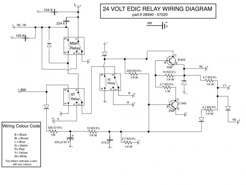

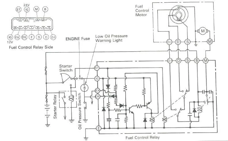

Just adding these pics to upgrade this thread
The person who made this diagram used the ground symbol also for wire connections so be careful when you use this diagram. Compare it to the one above which is for a HJ47.
