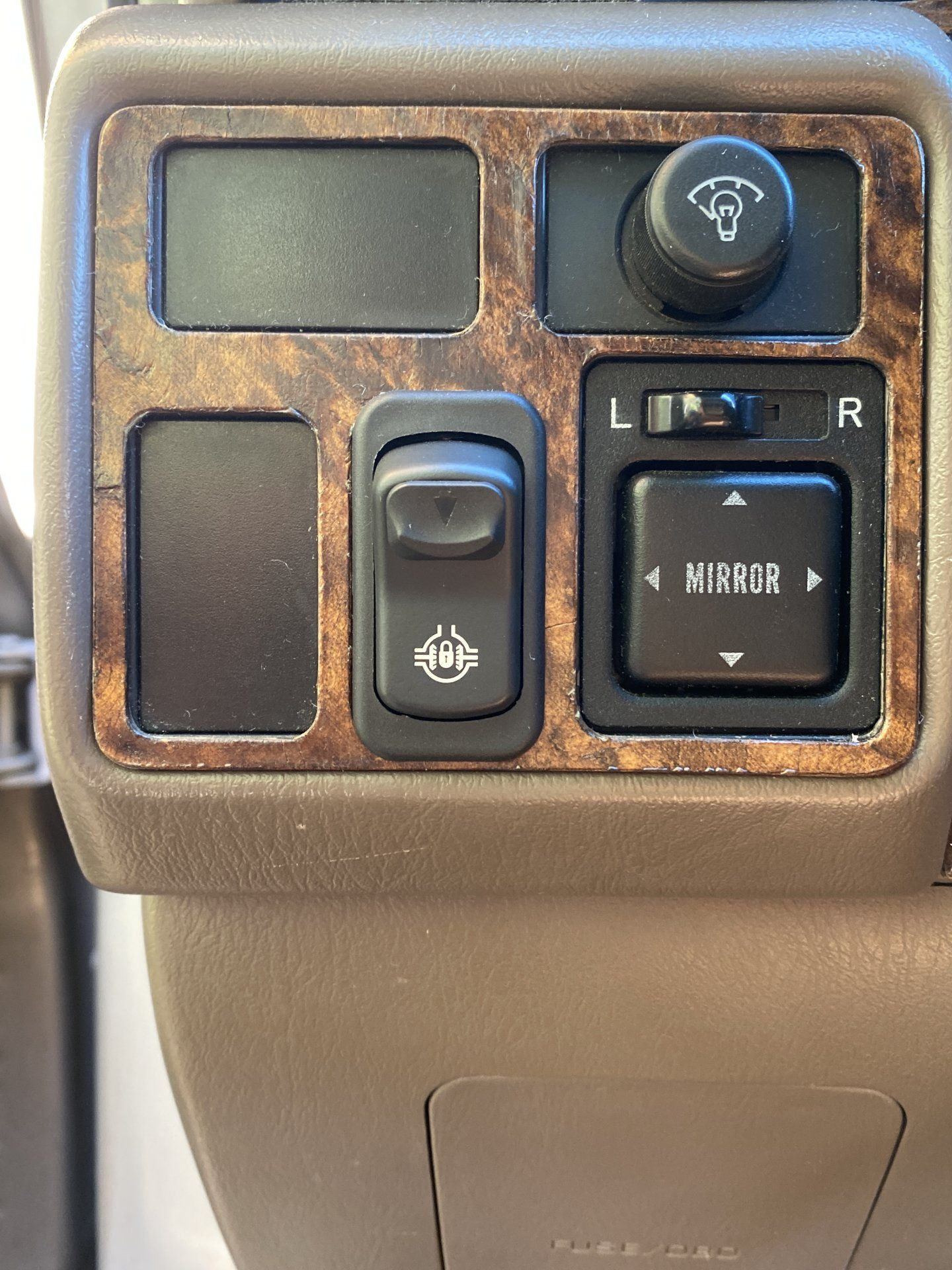

Just finished installing my new Eaton (not Harrop Eaton elocker) yesterday and all is well. I was initially apprehensive to pull the 3rd and all but am really glad I dove in. Not much more than a one :banana: project really once I understood the process. There maybe another 1/2:banana: involved but most of that is just willing to try. Sent the 3rd and my elocker to Zuk, excellent experience all around. The Eaton locker is about $200 less than the previous Harrop sources one an mine was about $300 less on sale. My initial hope and plan was to install the OEM switch and include the dash lights but that wiring is above my pay grade. I liked the included Eaton switch and went that route. All in all, very happy so far.
Basic tools essentially. Good to have a brass hammer or drift to pop loose the cone washers when removing the axles. This is on a 95’ btw, so axles just slide out. Pulling out lower dash was easy enough and then gently cutting the switch opening a bit bigger to fit the included locker switch. I just used a box cutter blade for this and checked fit frequently for snug clean fitting. It’s kinda a plug and play type deal with the included harness and switch.
