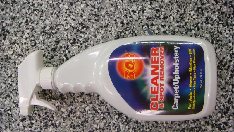

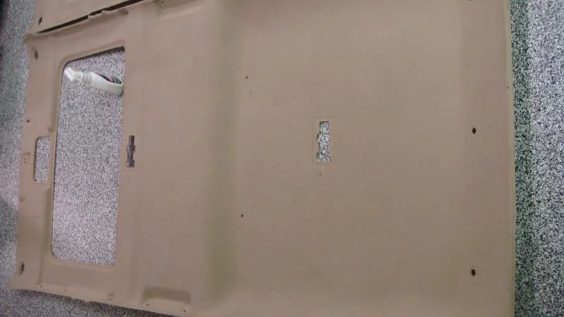

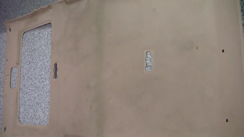

Well easy if you don't go to the trouble of removing it before you clean. I already had mine out to do the 3rd dome mod, fill the factory roof rack holes and add Dyna Mat. But it wouldn't be any different to clean in place.
I found 303 Cleaner and spot remover, a great product that is sold at Camping World etc that is used to clean the interiors of RV's and Campers.
Just spray and wipe with a dry cloth. I used an old bath towel and it worked great and only took a few minutes.
