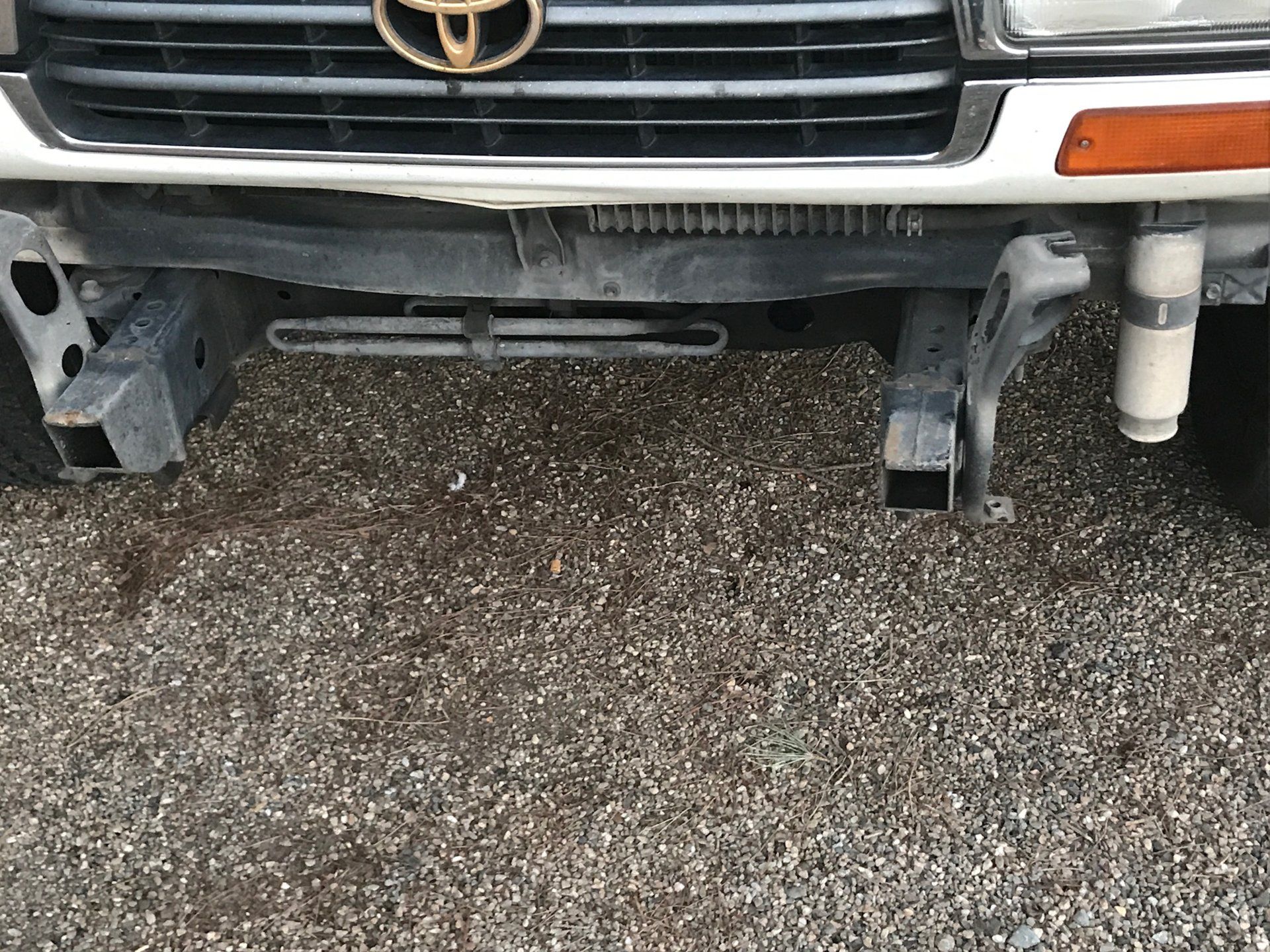

I am replacing the stock front bumper, after someone backed in to me. Are these mounting tabs supposed to flare out to the side, or did they get bent? I suspect that the truck has previously had a bumper replaced.
I’m no pro, but def not. They sit flat against the frame.

These brackets are easy to bend around to get your bumper right where it should be. Stick a long (3 feet or so) tool for prying, like a long crowbar, into the hole in the bracket and you can twist/bend the bracket in most directions which should get you where you need to be. A hammer could help with some adjustments as well.
You will want to test install the bumper a few times as you work on the alignment but it should be straightforward once you get started on the process and you can just install the bumper with a few bolts to test it's position against the body.
The bumper itself is also relatively thin and flexible so you can pretty easily hammer out any dents/bends in it as well.
