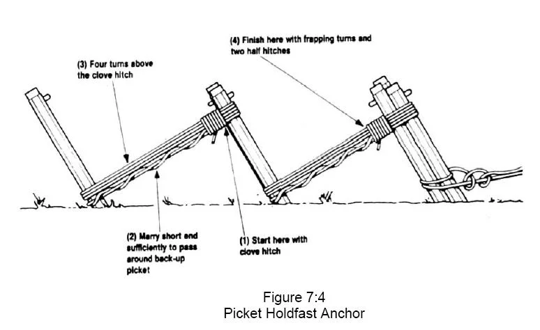

Problem I see with this, is just like any other stake, the pull at the top will tip it toward you and it will then simply pull out of the ground.

Maybe in combination with a rigging like this....
